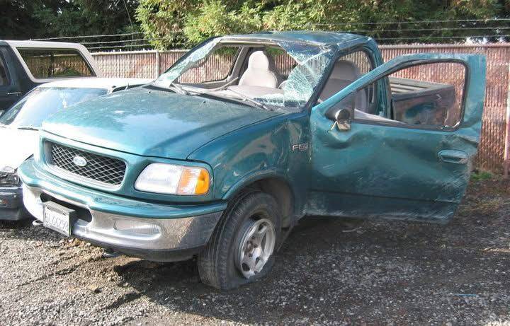

Yeah, new rain can be slippery…broke my little finger…
