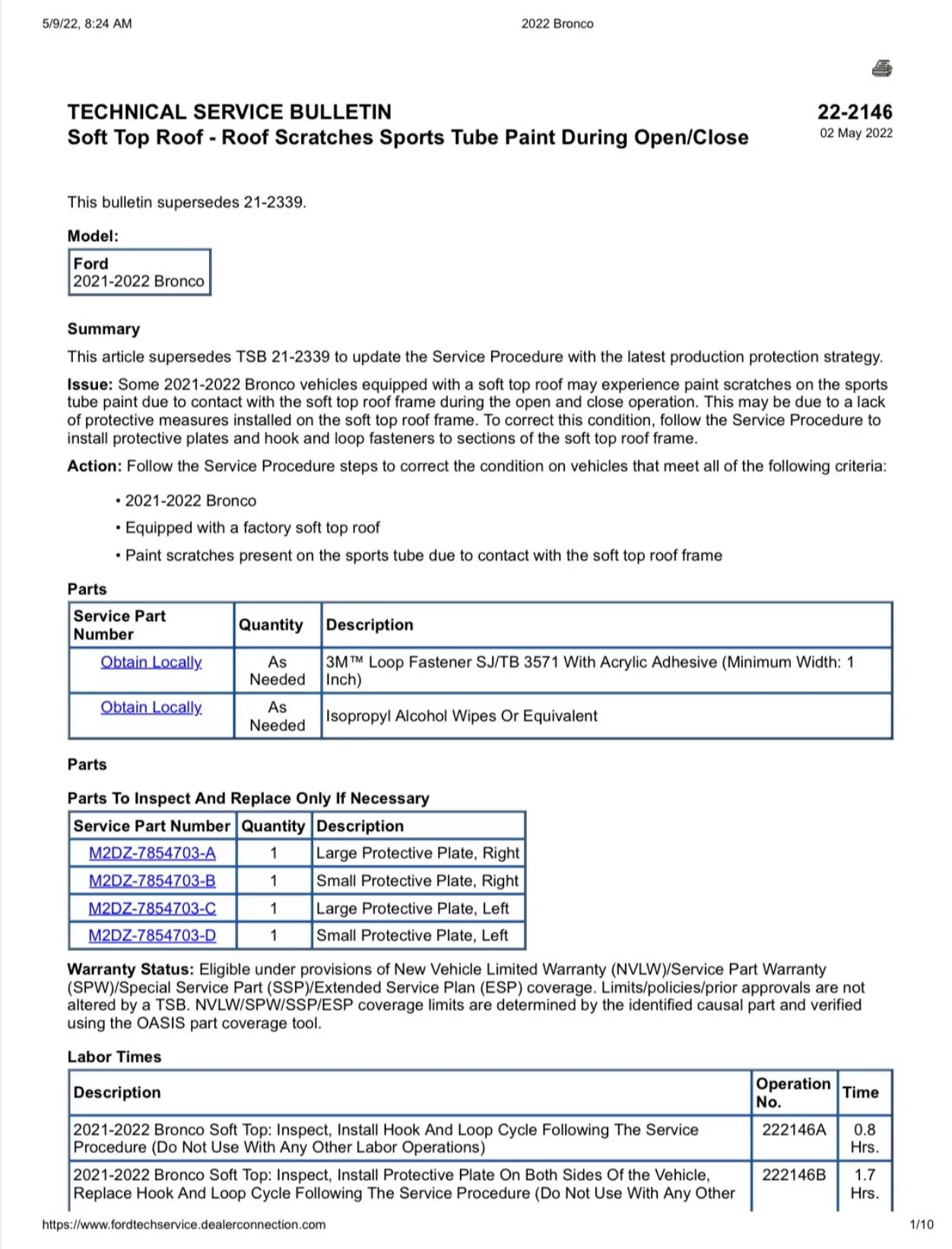

There is a TSB where Ford applies a fix. My 22 hasn’t scratched yet. Will see if I have the TSB. I didn’t take it in as it appears fixed at factory.

What does it look like installed? I have never seen this before. My bronco is going in for a few other TSB’s and warranty work. I may throw this on their plate also.
Will see if I can get a pic when the sun is up. Not sure how visible parts are with top closed.
