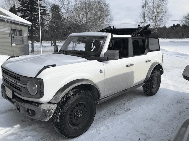

Okay so it is a bit warmer today (as in my face doesn't hurt....yet)
Ford Bronco Factory Soft Top Questions 1642960712586
So I tried taking a video of me dropping the roof one handed while filming in the other and it catches. I will admit it is a more forceful drop (almost a push up one handed and let drop while inside the rig holding my phone in the other hand.)
Ford Bronco Factory Soft Top Questions C98246F9-55BC-43D3-82A3-73A6E58A0277
I have the straps too, they were in the tool kit with the plastic wrap still on.
Thanks for being a trooper! This is helpful :)
