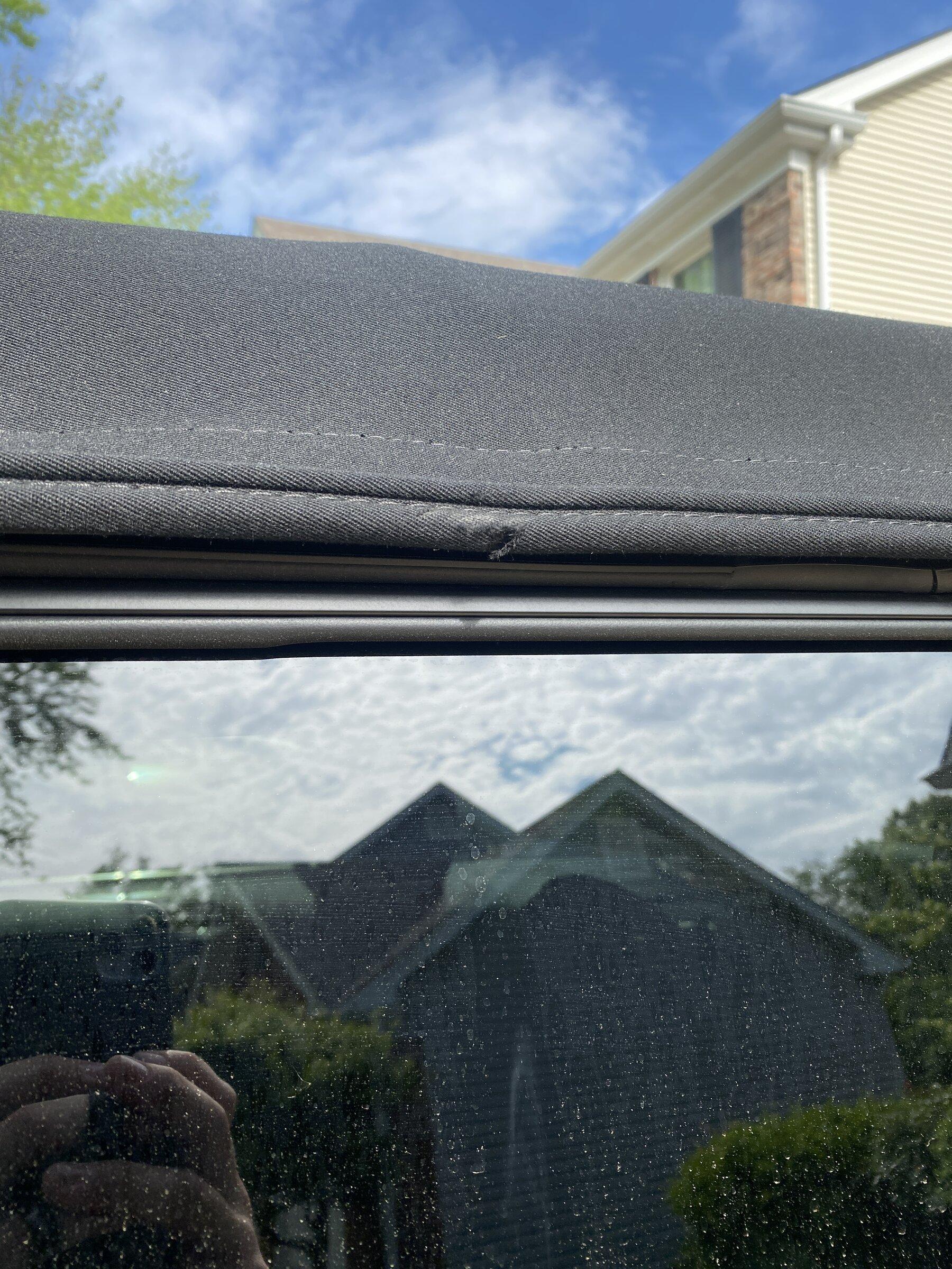

just noticed this on mine tonight

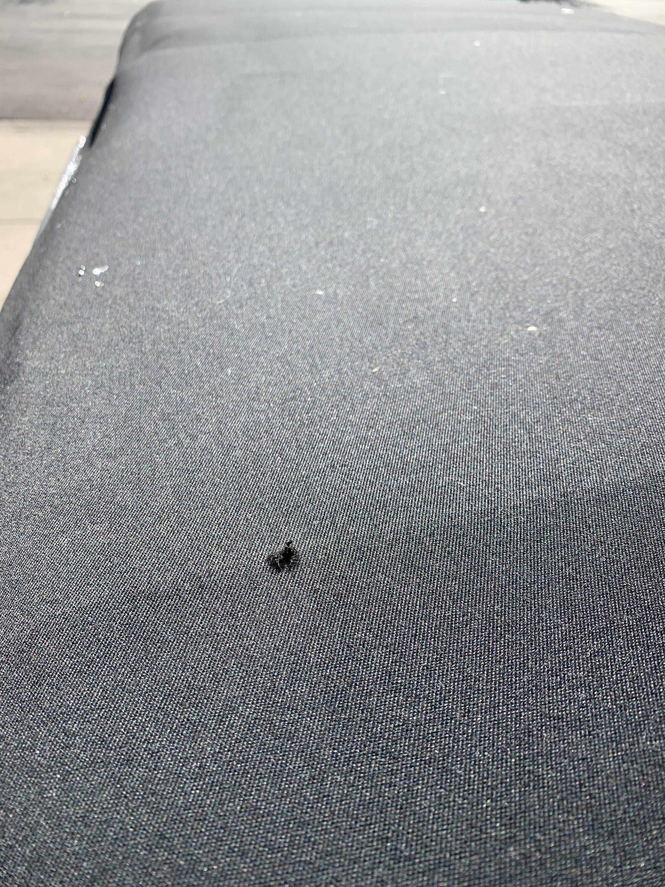

Has anyone else experienced this issue yet? Luckily it’s small, but not sure what to even do about it? Going to take it in to the dealer and see what they say about it. Looks like it’s happening right at the bend when the soft top goes back
