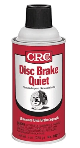

Ford Bronco Squeaking brakes?  (FORD ignoring this problem!!) 1710012413274
and if that dont work, this usually does the trick on the back of the pads
Ford Bronco Squeaking brakes?  (FORD ignoring this problem!!) 1710012468656
TacosTuesday
May 7, 2023
250
316
Carlsbad, CA
'23 Badlands 2dr 2.7L
i don't know what the difference is between the spray brake cleaner vs the spray anti-squeak. Growing up my dads garage always has both so on the rare occasions i did get squeak or squeal, i'd hit it with the cleaner, then hit it with the anti-squeak and it always seemed to work out.
Interesting. How does this product work? Is it different than any other brake cleaner spray?
