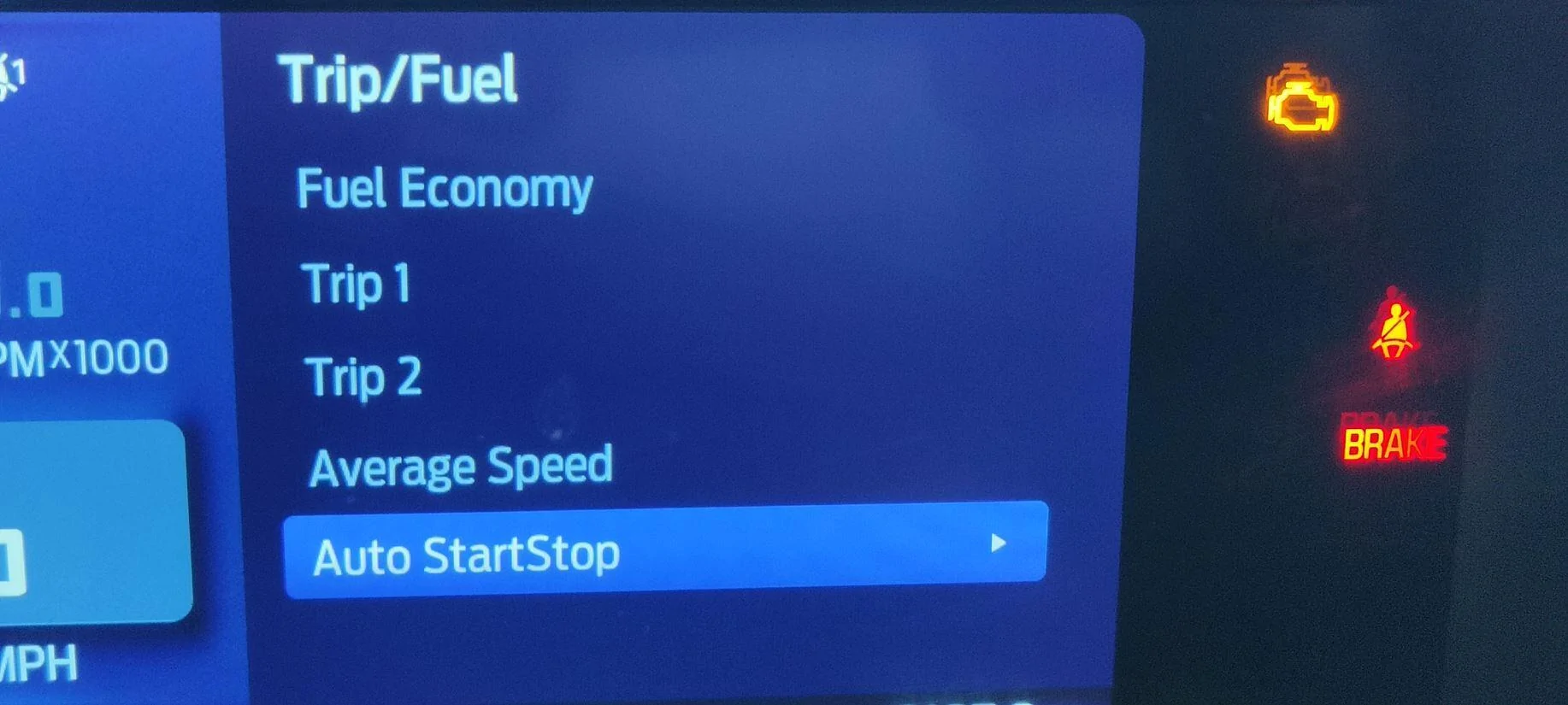

You can always just change the right side of the gauge cluster and go to Trip/Fuel -> Auto Start Stop, and it will show you if it is on, or why it's disabled. Ambient Air temp, charging, or heating/cooling requirements is what I have seen on mine.
I just learned something.

I just checked. The message stated auto start stop is on due to outside temperature.
Really? Seems like an odd reason. If it's that hot, you'd have AC on, which knocks it out anyway. And if it's not hot enough for AC, what the heck?
