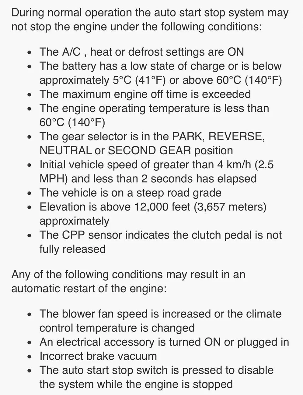

I read a post from another member listed below.
Start/Stop will not work with the doors off.
Makes sense since it stopped working after I removed my doors.
The system does not stop if:
The driver door is open
The vehicle is at high altitude
The heated windshield is on
The engine is warming up
The outside temperature is too high or too low
The battery charge is low
Etc!!!
