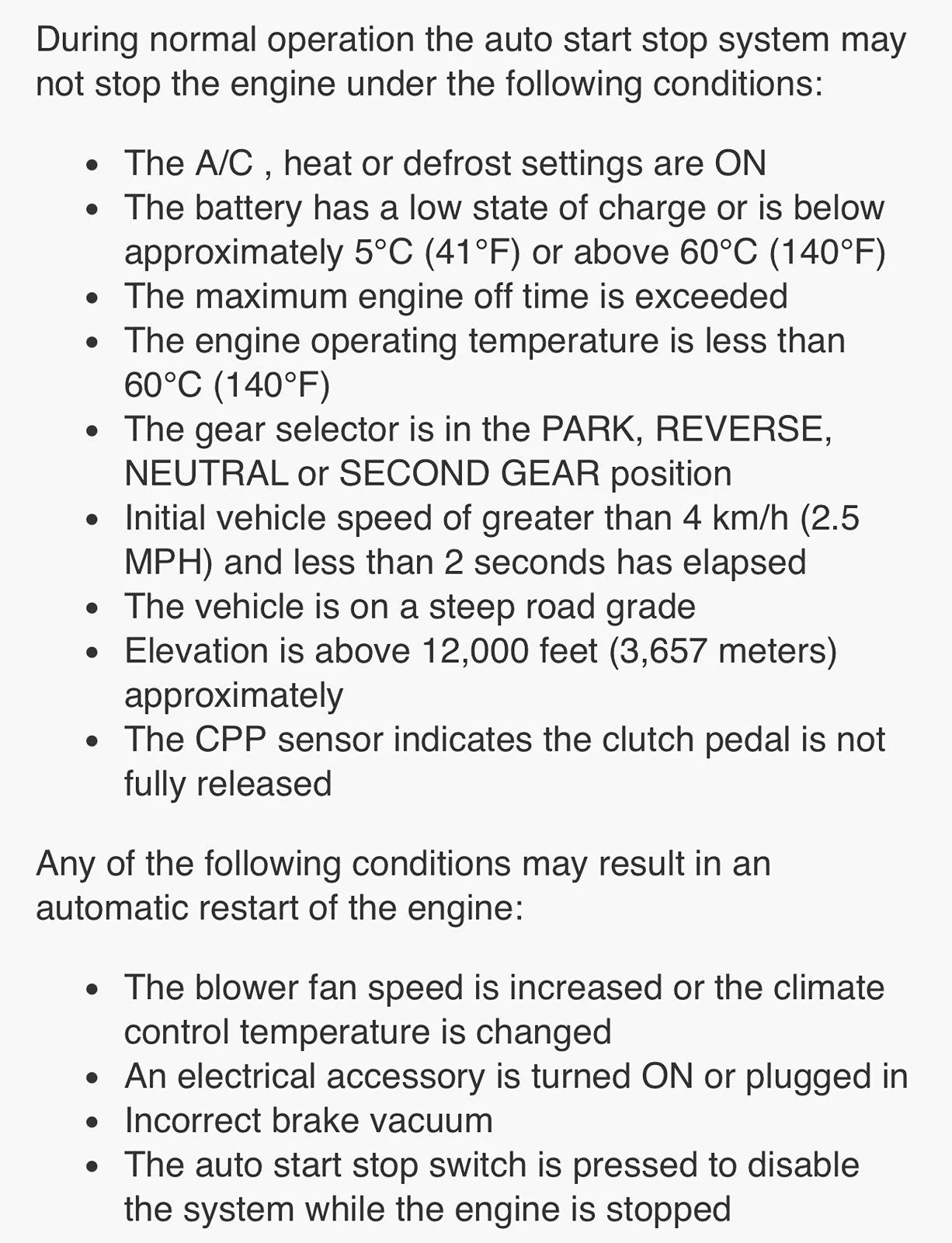

I believe the manual has details on when it should/shouldn't engage but I don't remember exactly what they are
Good call, I just found this in the owner's manual regarding auto start/stop.

This is what the workshop manual lists:
Ford Bronco Auto Start/Stop Only Functions Intermittently IMG_3056
