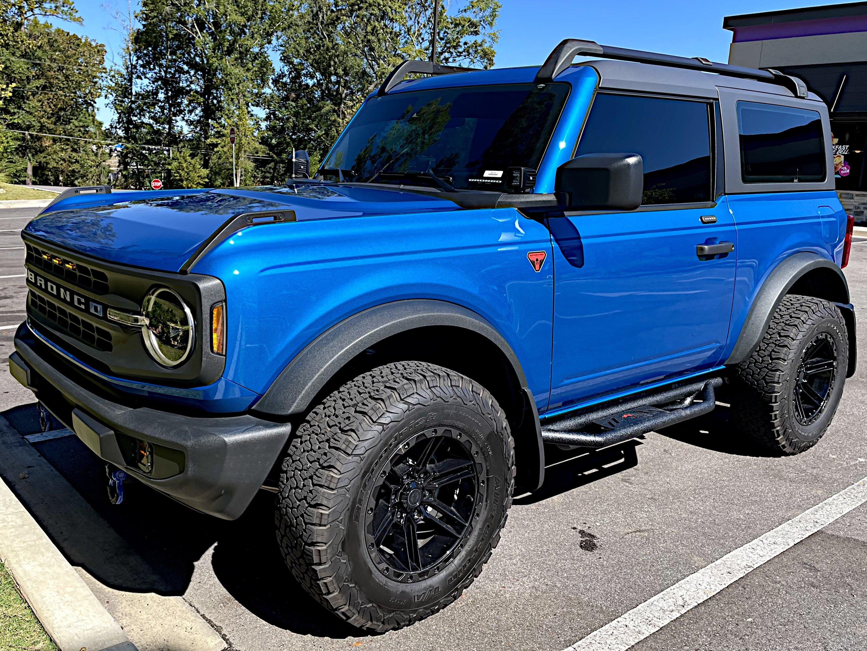

Currently have BFG KO2's 265/70/17 mounted on American Outlaws (17x8.5). Wanting to go with something bigger and aggressive. Stock suspension. Will likely be adding on leveling kit and removing crash bars (if 315 route). Recommendations? Pics of your build?
Thanks!

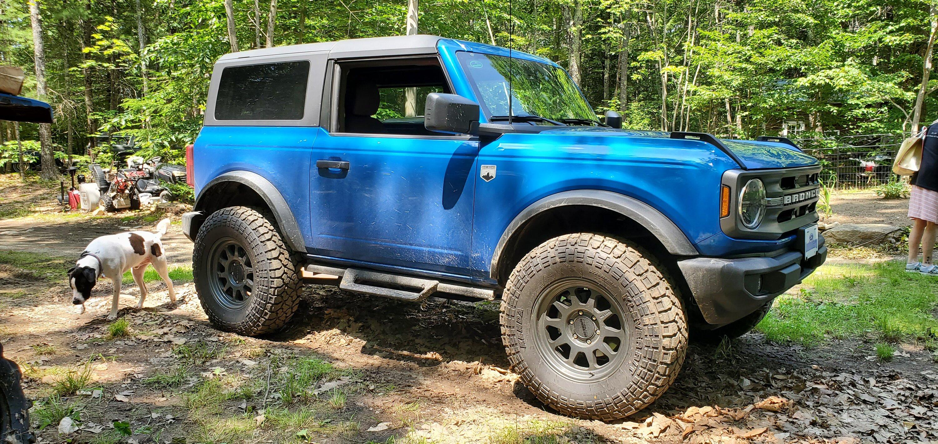

Ford Bronco Stock Non-SAS Base: 285's vs 315's? 20230706_141221
Non-sas big bend, auto (3.73), 285/75/18 (35"), 2" RC lift, -18 wheels..
Bars gotta go, otherwise its perfect imo.
I went from 23mpg to 21. The weight & size did drag It's acceleration down.. but pretty minimally. Filling it with 93 instead of 87 would bring all its pep right back... but I don't bother.
I came to the Bronco from a ranger that had much lighter 32" tires on it... the Bronco is quicker and more efficient.. so I'm all smiles.

Nice, looks great! I presume your 2.7?
