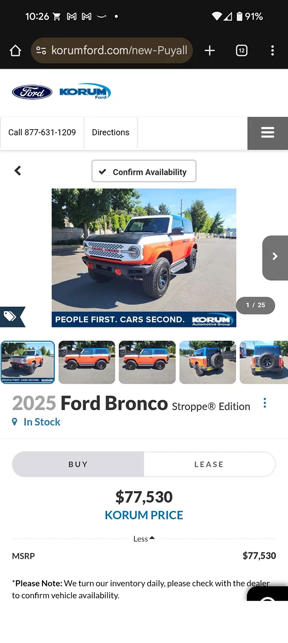

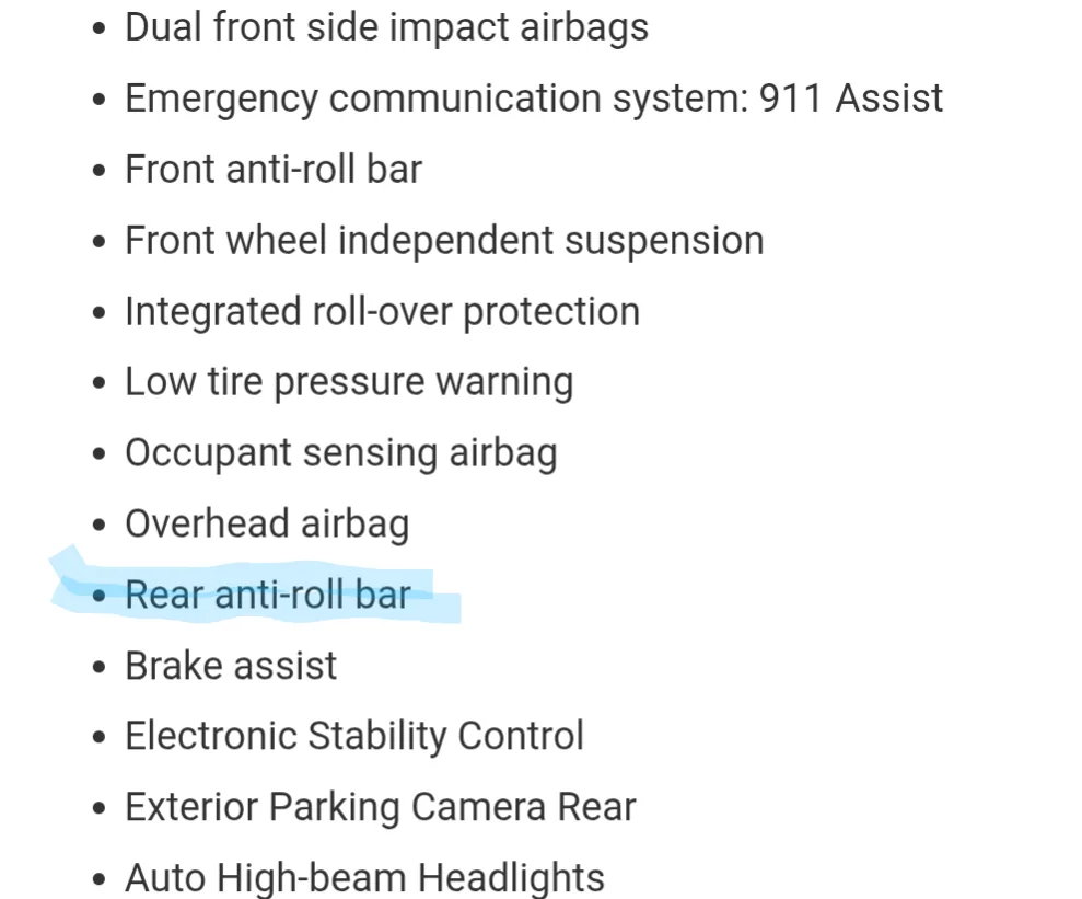

I was a little surprised to see the Stroppe, being a 2 door, comes with a rear sway bar. Is that unique to the Stroppe, part of the current SAS package, part of the HOSS 3.0, or do current BLs have it too? Is it the same part/stiffness as a 4 door sway bar? Anyone know the part number for that Stroppe bar, if it's different from a 4 door bar?

For reference.....
Ford Bronco Stroppe Edition Rear Sway Bar Question Screenshot_20250906-102609
Ford Bronco Stroppe Edition Rear Sway Bar Question markup_1000005523
