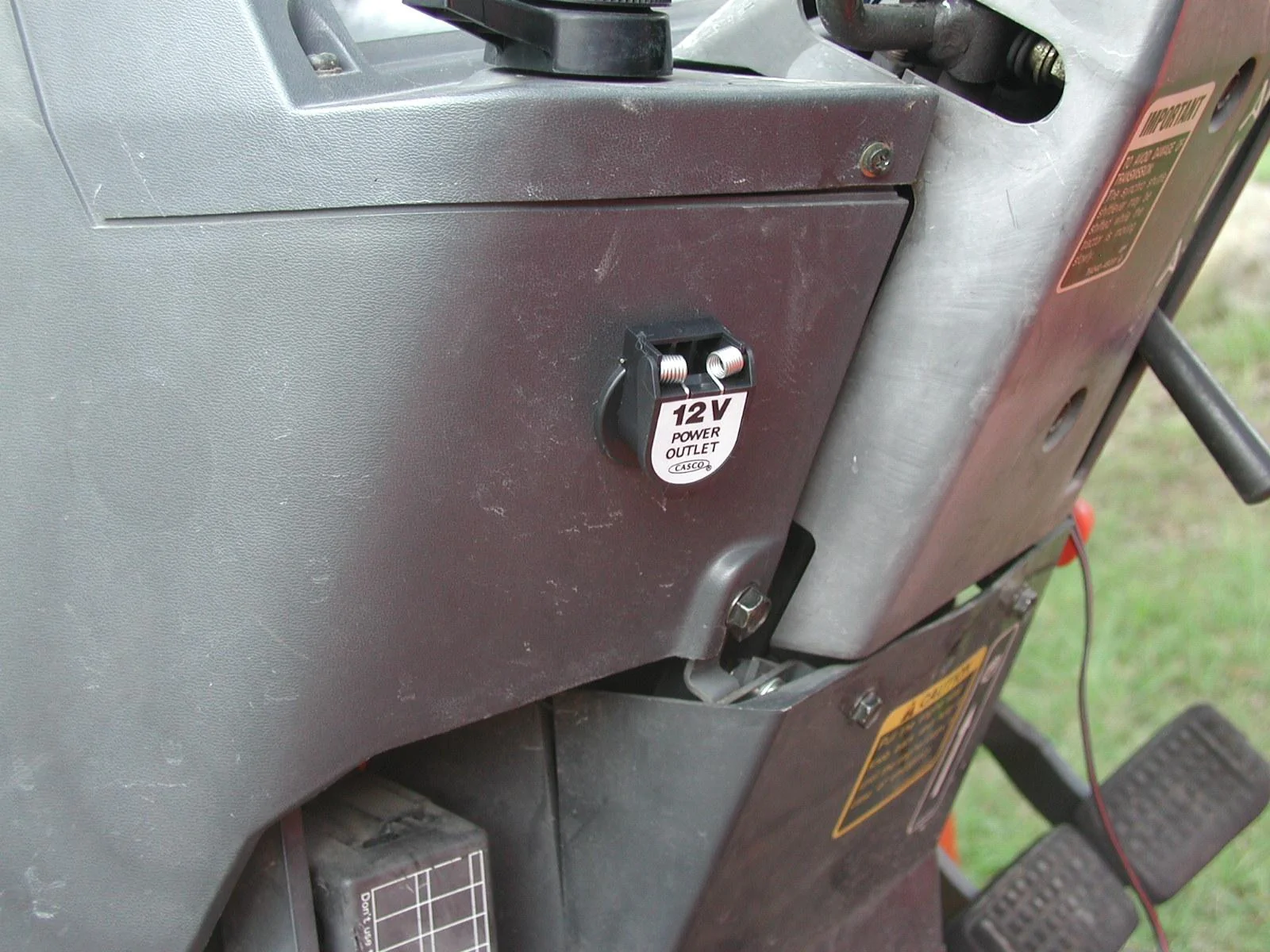

Off-topic, but;
I've got a Kubota L3010 which spends it's time in the garage, when it's not working.
In 2007 I put a new Wally World NeverStart battery in it; I have a cig lighter, er, current vernacular; "12 volt power port" plug on the dash.
When I park the Kubota, I plug a float charger into it.
Last year, I took the front cowling off to get to the battery (it had been awhile!), and the terminals were all corroded....tractor starts fine, no probs, but then I noticed the sticker on the battery...from 2007.
I tested the battery, it was weak, but still good, still full of electrolyte.
It was FOURTEEN YEARS OLD!!! I went and got a new one.
Lemme do some maths here; batts are about $100, at least.
Battery Tender is about $50...so if a $100 battery can last FOURTEEN YEARS using a $50 battery tender...well, ya'll's mileage may vary, but I know what I'll be doing with vee-hickles that get parked for a while...
