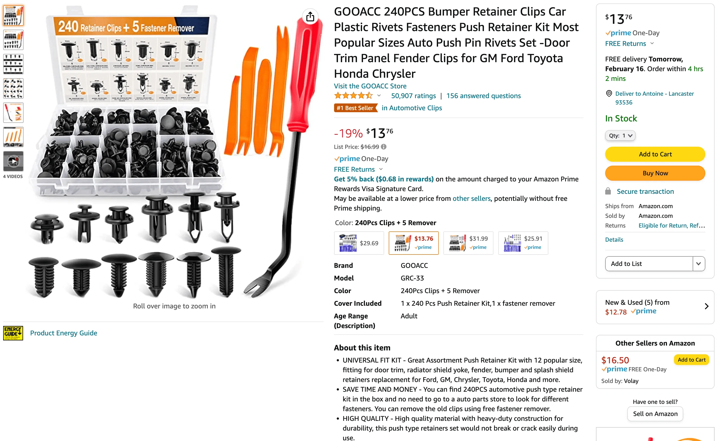

Think using smaller diameter push clips (3/16”?) might preclude need to drill out the holes?

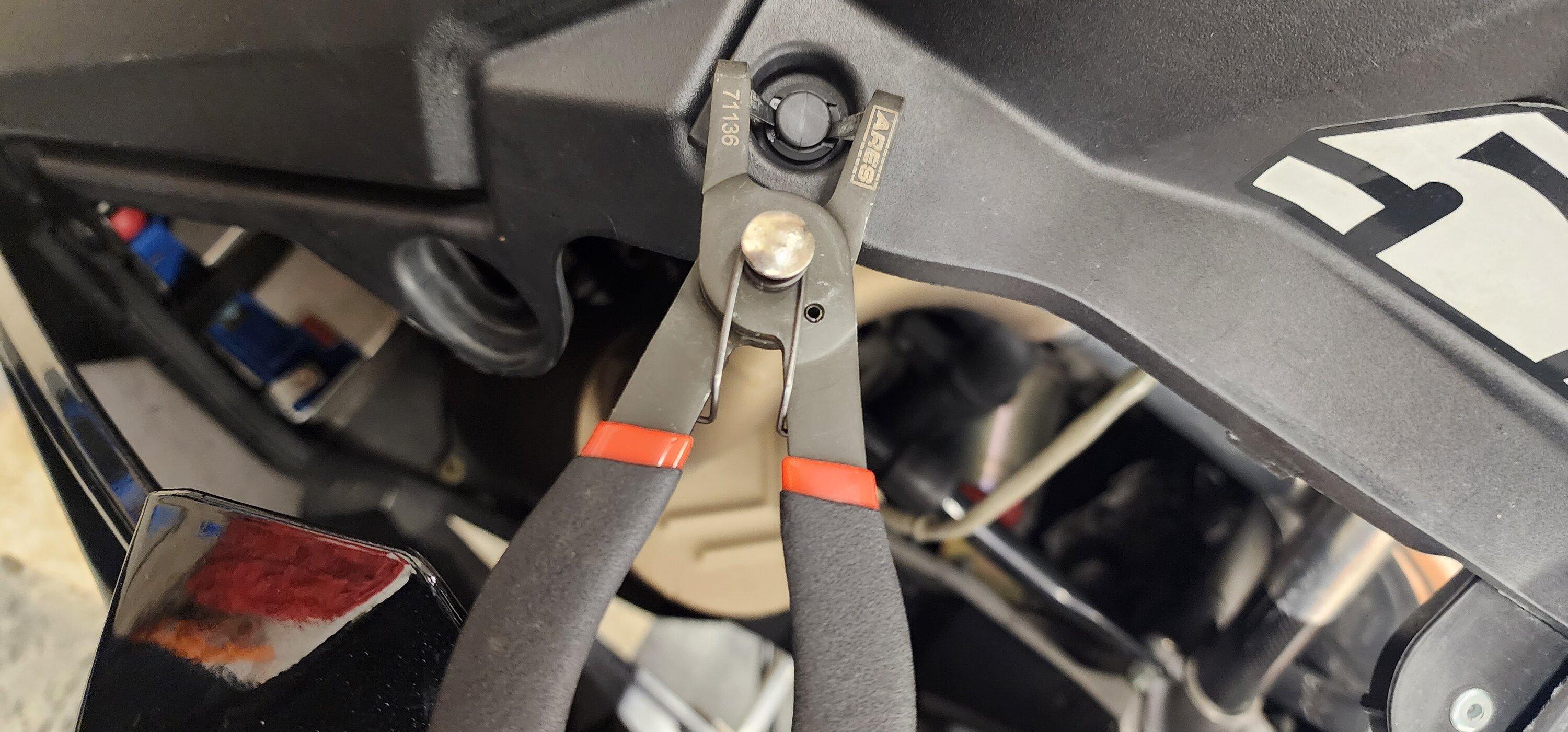

I hate those stupid push pins so much I that I bought pliers specifically for them, similar to those below.
And if you're gonna use these, do yourself a favor and pick up some push-pin pliers. They can be had in straight or 90° and are infinitely better than dicking around a screwdriver.

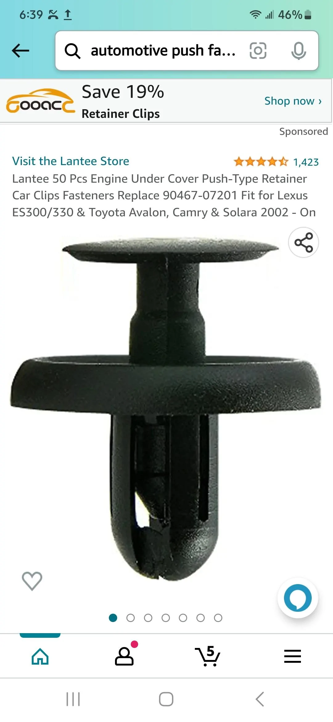

The reason why I didn't link to what I bought is that what I have are OEM Mitsubishi clips for the trunk liner of a 2006 Evo 9 (Yes, that specific), which were at the time, $3.49 for a pair. So what I'm using specifically won't be what people order.
Any push clip with a 1/4" post will work, and for the overall height what I'm using is a little short which makes the pressure and hold very tight, but less user friendly than if you got something readily available like this:
Note: I'm not endorsing the product above or saying it will work for Bronco, it's the correct type of clip but in metric so you'll need to convert the shaft width to SAE and see if it works for you. 1/4" will require you to drill out the holes to 5/16", but is a great fit.
