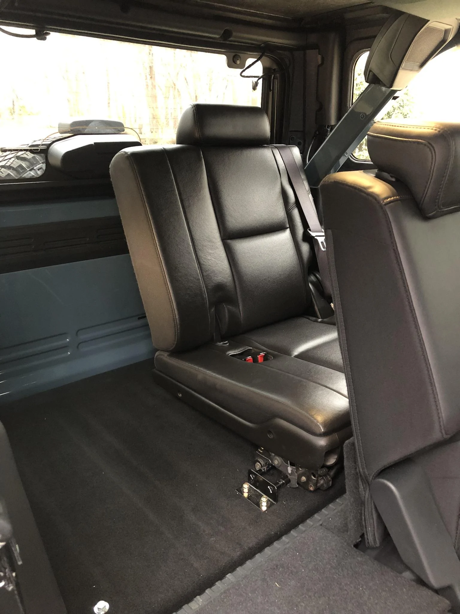

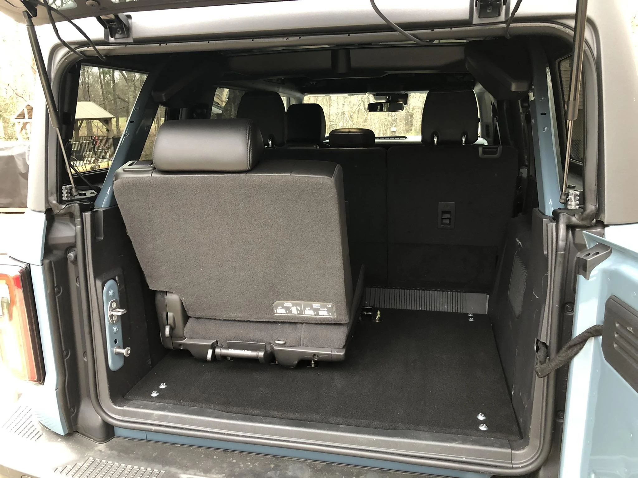

But I got the seat from ebay out of an 07ish Yukon/Suburban. In this thread above you can see the anchor kit I used also on ebay. The base is 3/4 plywood wrapped in black carpet held down by the 8 bolts that are used for the tiedown loops. Use large fender washers on all the hardware. You will have to remove the tiedown loops and the plastic floor liner that is held down by those and then you can bolt the base directly to the metal floor. People will debate safety, but keep in mind everyone has a different risk tolerance and this setup is a lot safer than my kids riding in the back seat of my 71 Bronco with lap belts, or them bouncing around in the back cargo area with nothing (which is how we came home from the dealership) haha. That being said I don't recommend it for frequent or regular use. For me it's used irregularly and for short trips.

Not sure on the deleted bronco 2 door seat. I think it'd be too tall unless you removed the mounting bracket, but then you'd have to fab something. The reason I used the Yukon seat is: 1. It's low profile, 2. It's foldable, 3. it's easily removeable, 4. It's got an integrated seatbelt. 5. It's easy to mount anywhere with the aftermarket brackets, 6. It's cheap.
My interior is black and the seat is black so you have to look to notice a difference. The back seats are so tall you really don't see it when opening the back doors.

First I removed the floor liner by removing the four tiedown loops. Second I cut a piece of three-quarter inch plywood to fit over the entire back. Third laid out were the brackets should go on the plywood and drilled and fasten them. Fourth I remove the brackets covered it in carpet and then reinstalled brackets. Then i attached the plywood to the floor using the threaded holes that were used for the tiedown loops. It’s 8 bolts. Then snap in the seat.

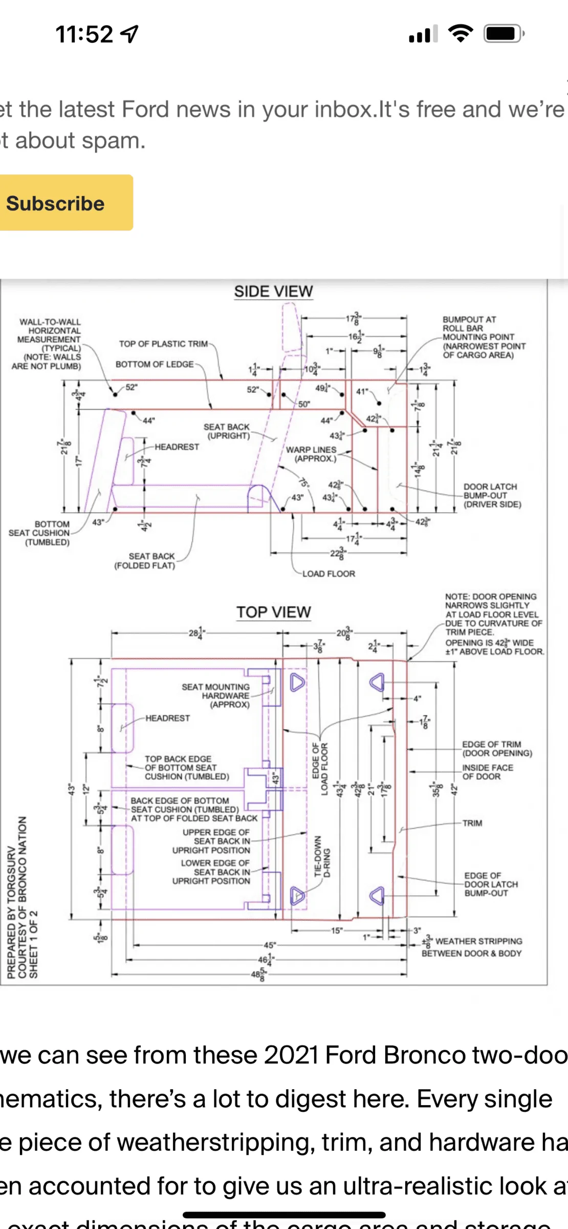

How wide is the gap between the rear wheel wells? I'm looking at this seat, and I assume it would fit. I'm looking to cut a similar plywood base / wrapped in carpet as you did. But this would let me put two kiddos in the back if the whole family wants to take a joy ride. And since the younger ones are in pretty intense booster seats, the seats themselves have 3-point straps.
Diagram at the bottom right shows 42” width from trim panel to trim panel across cargo area.
This is fantastic. Thanks!
And now this means I'd like to find a 40-42" folding seat. They call it "Fold and Tumble" apparently, BTW, for anyone else following along here.
