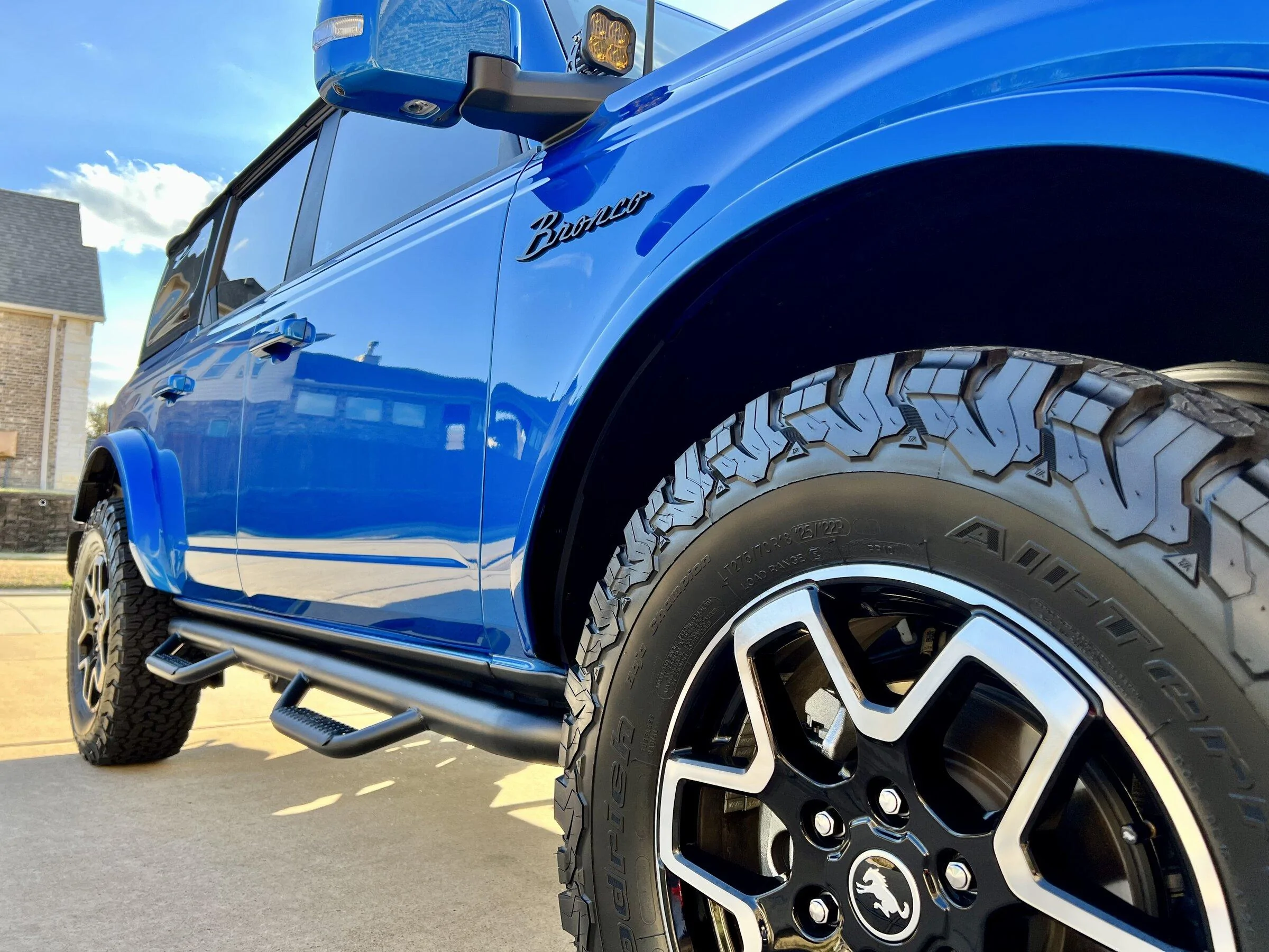

I went with the 275/70 KO2's. I like that they handle well, have no road noise, and look great. I do not like that they are an E-rated tire, which makes you feel every little bump.
One of the issues with that size tire is the short sidewall and a stiff ride regardless of tire. What pressure are you running them at?

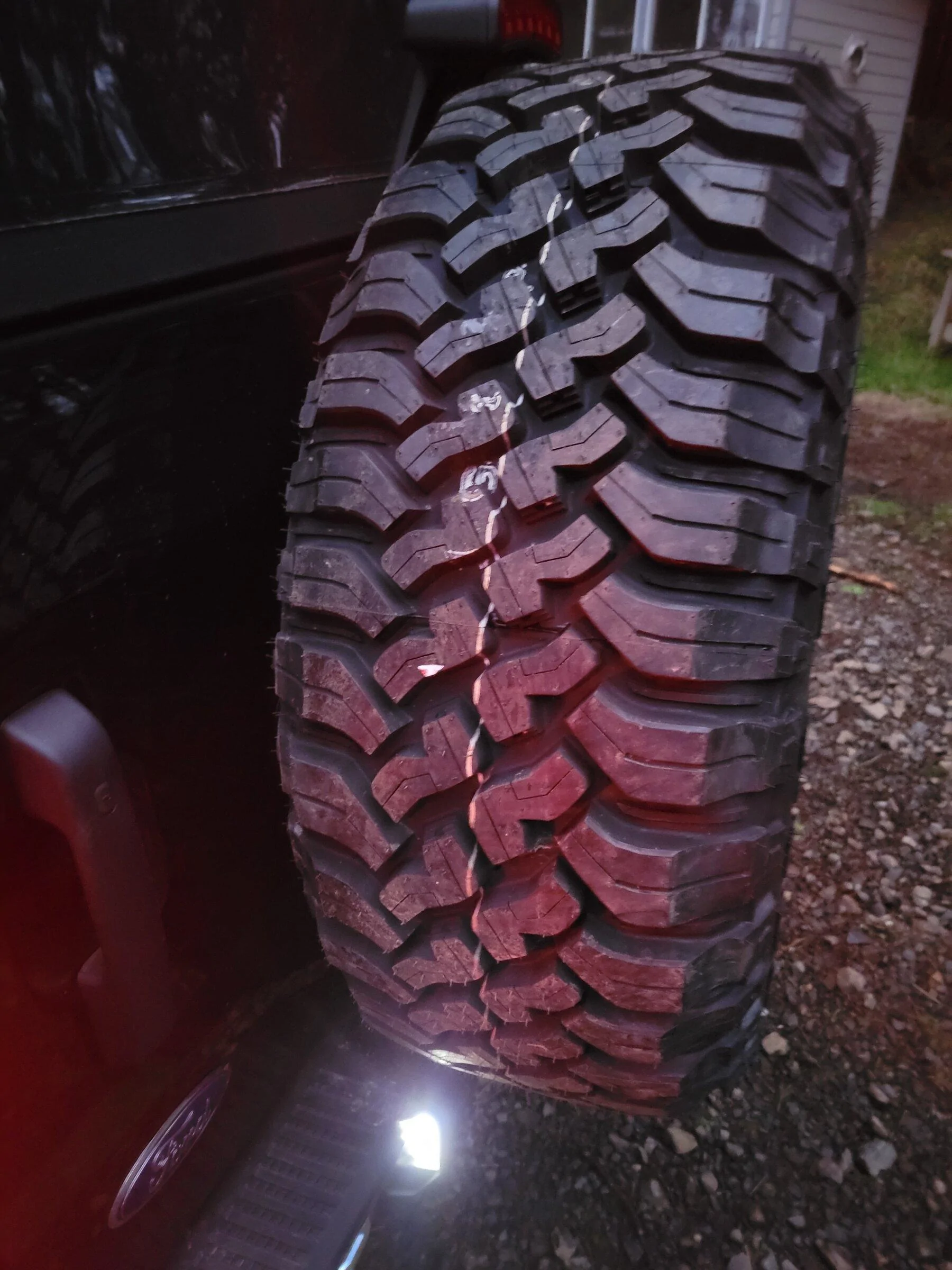

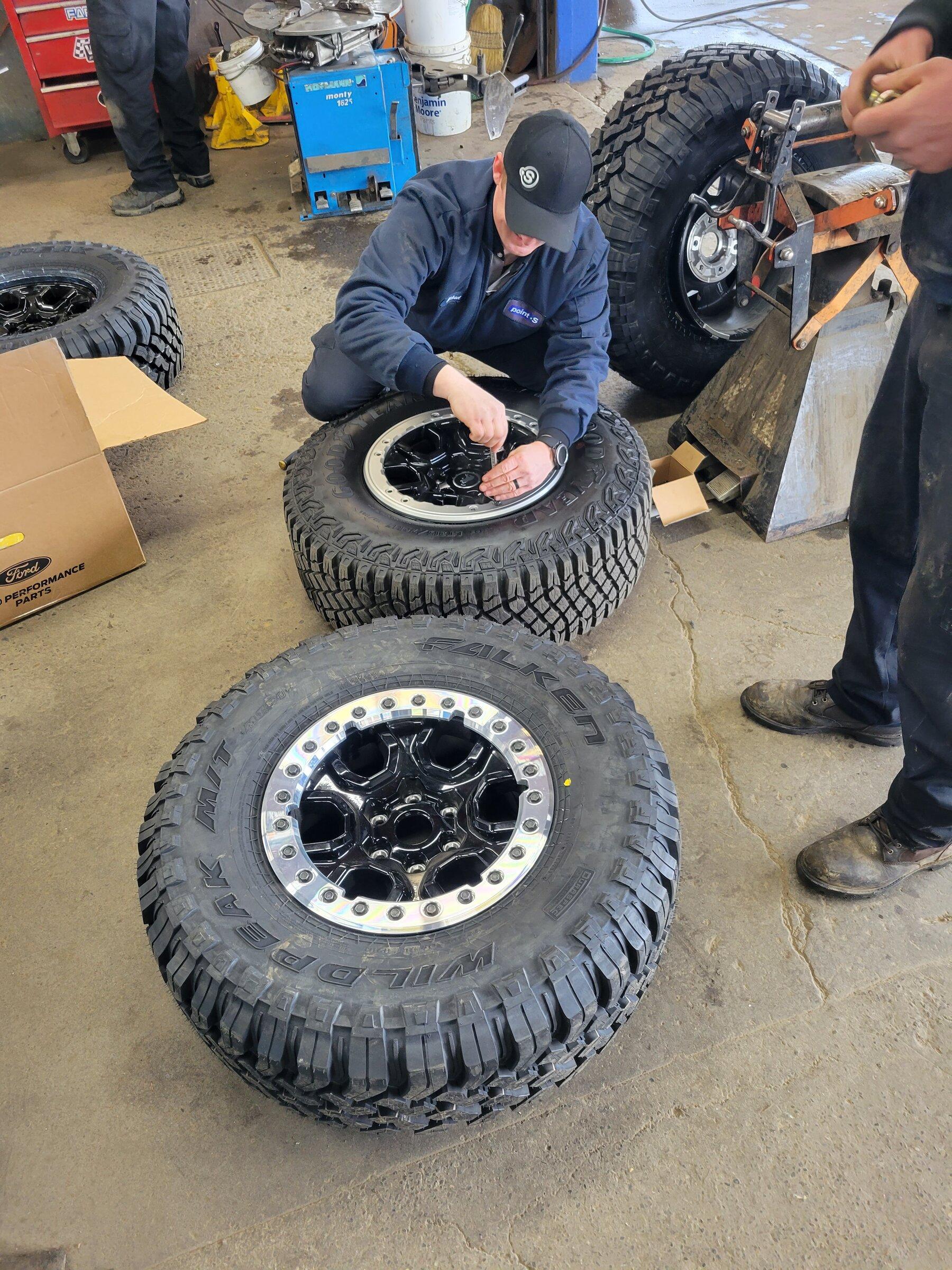

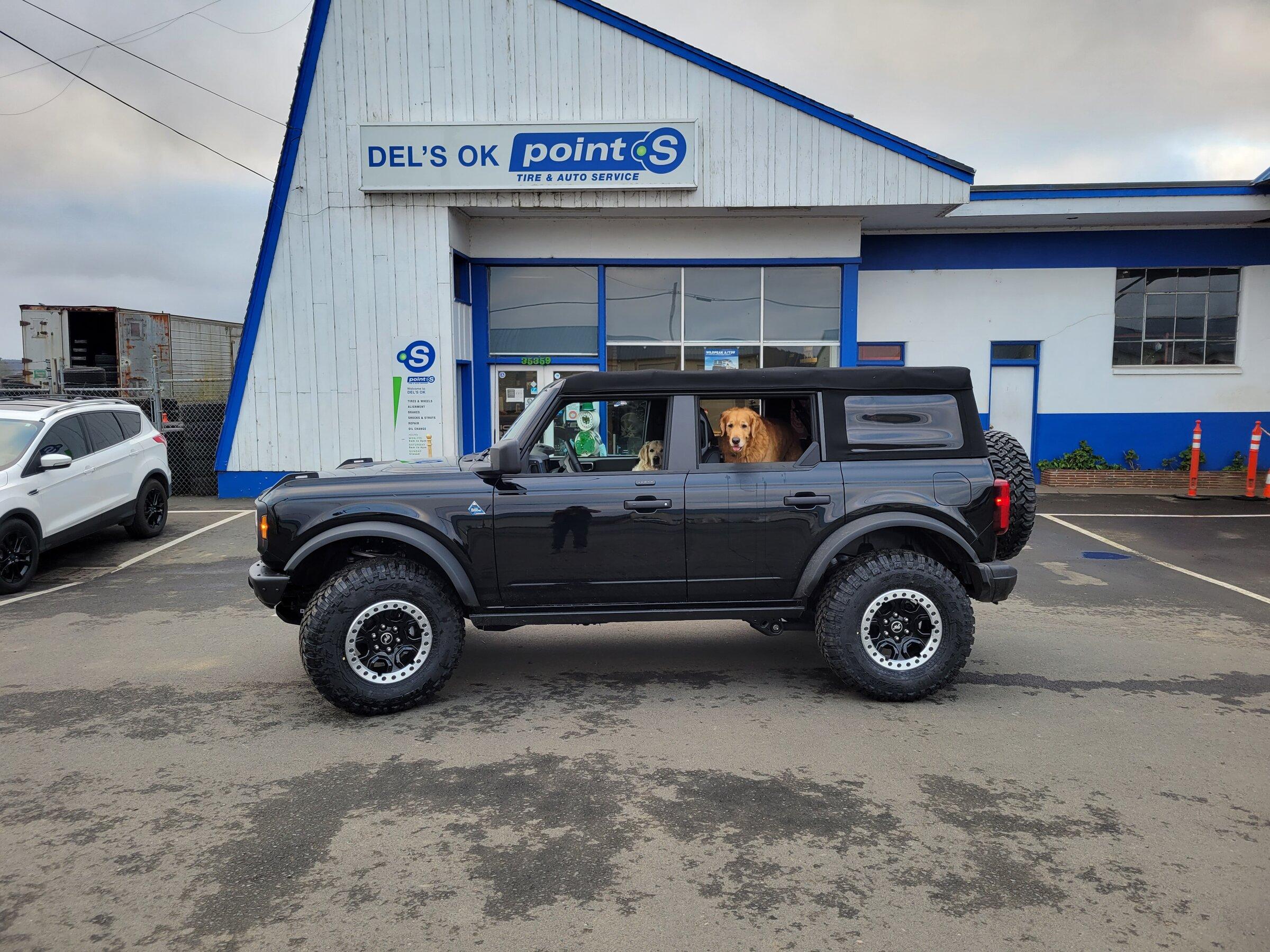

I put on tires today, along with real beadlock rings. I put on Falken Wildpeak M/T in R 35"X 12.5, 10 ply,(E). The stock OEM Goodyears are supposed to be the same size, but these are almost an inch taller. They are also wider, which might be in part to using the beadlocks, which mount the tire outside the rim instead of inside the rim, moving the bead about an inch outward. The constant rock battering from the Goodyears went away with the Falkens. They drove nice on the highway at 35PSI. The Falken M/Ts are known to be good offroad tires, but I was surprised how tame they were on the highway.
I am running 35PSI. The issue with E-rated tires is not so much with the height of the sidewall; it is more about the thickness. They are meant for towing heavy loads. I plan to go with a 17" wheel and possibly a different rating down the road.
I understand E tires, as that's what I have. Your setup has a short sidewall which adds to the overall stiffness of the tire. Gets worse as the wheel gets bigger and the sidewall shrinks. More rubber, less wheel has more comfort regardless of tire rating.
I understand that, my point is that you can get a much better ride with the same size tire if you go with a non-E rated tire.
