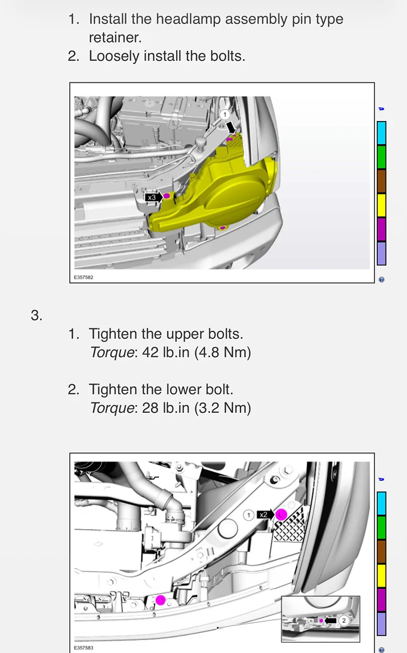

Are there specific torque specs for the three bolts that attach the headlights (2x 10mm and 1x 8mm)? I just installed the Form Lighting headlights, and I want to make sure I don’t over tighten the bolts (and risk breaking the plastic), but I also don’t want the headlights to be too loose.
