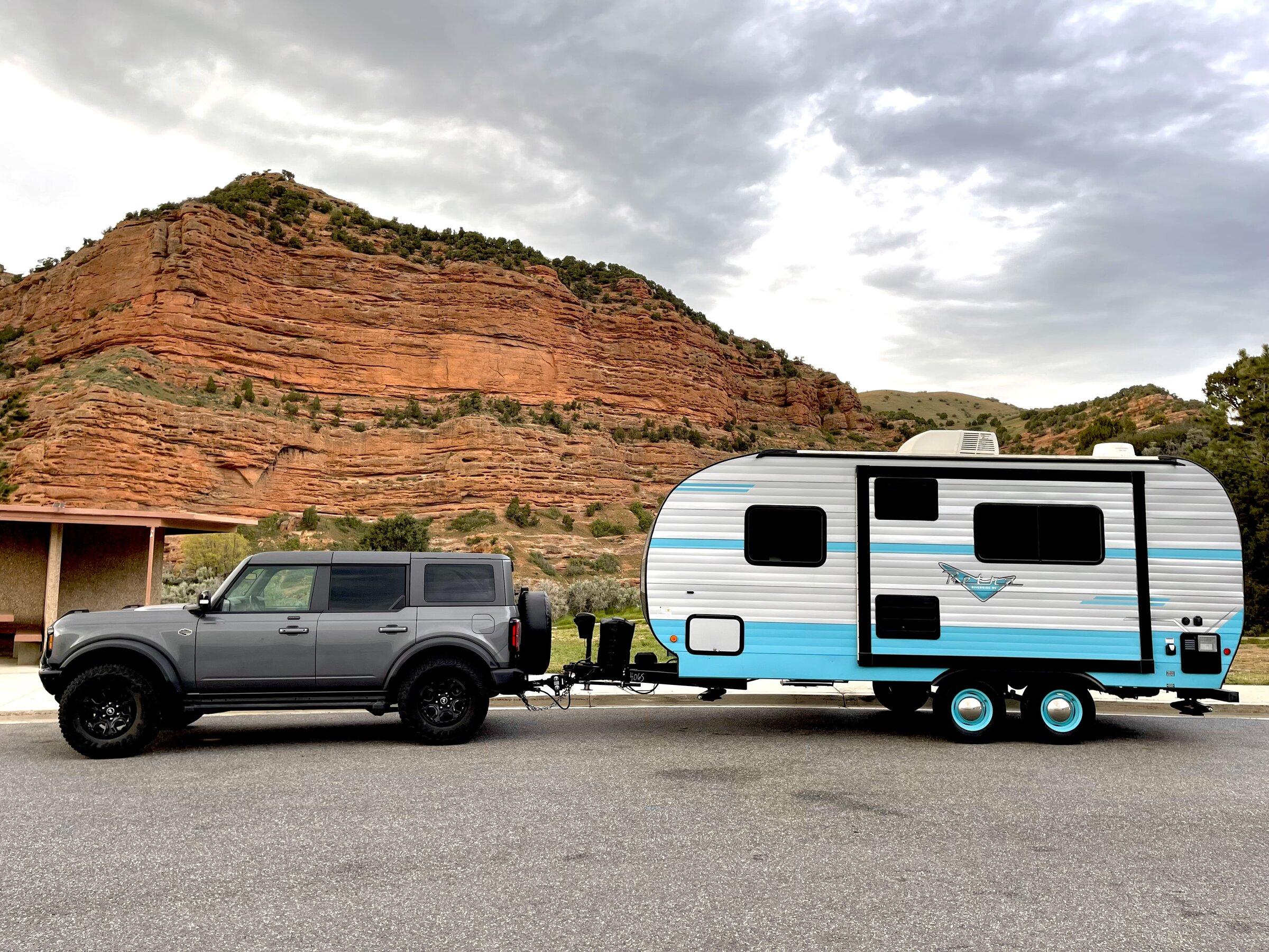

Yes, if you have a spare tire on the back, you’ll need a hitch extension. And I also added the EchoSmartControl blue tooth trailer breaks to my setup. It makes life a lot more comfortable going down the grades.
Ford Bronco Towing with my Bronco D11156DF-5DC2-49EB-B46B-0A0ED591616F
