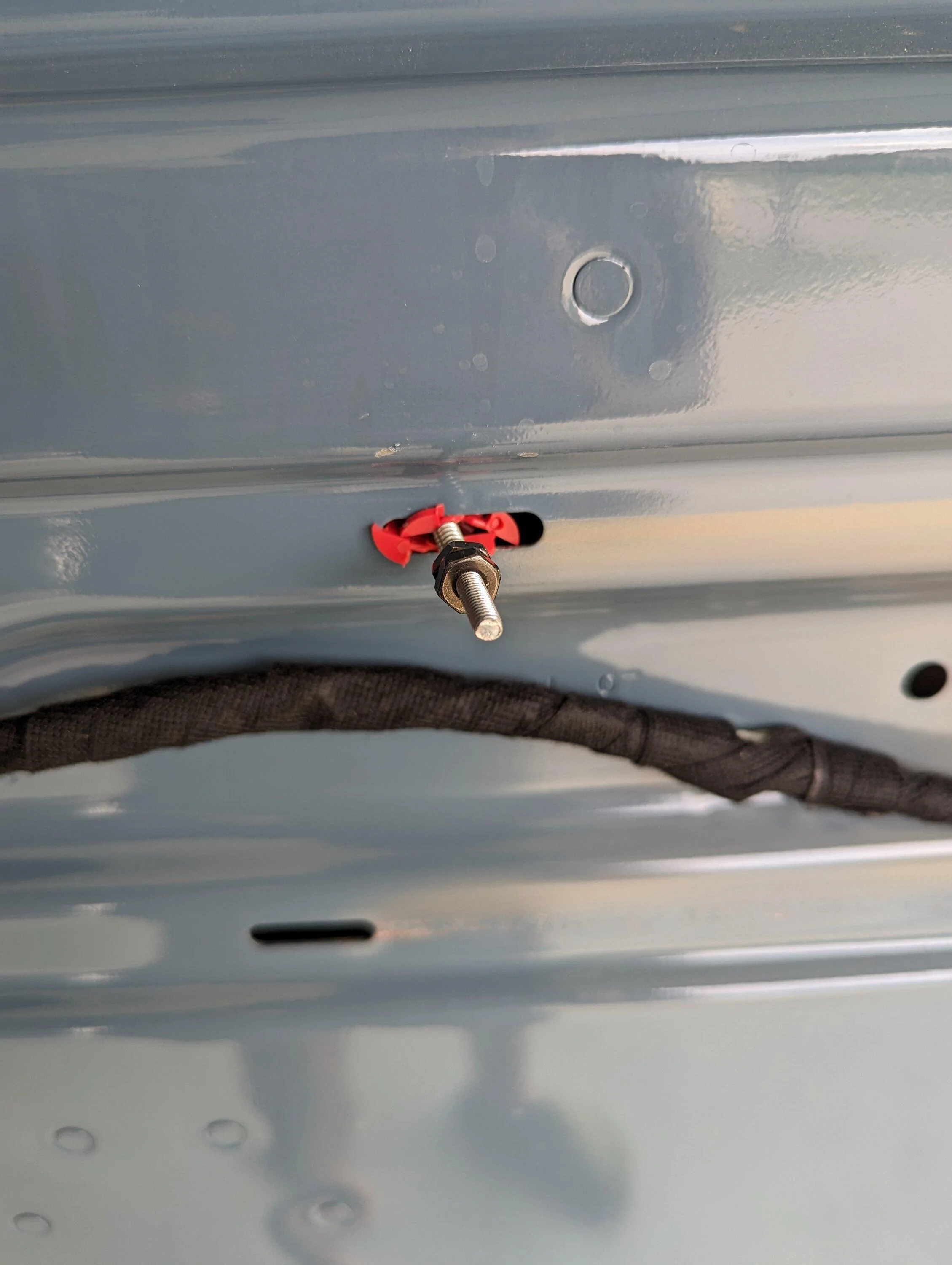

So maybe I am missing a chromosome or something, but this install has killed me.
Every time I try to ratchet in the screws to the "blind nuts" the blind nuts completely fold and collapse on me and end up going into the hole on the Bronco tailgate. See the pic below.
Does anyone have any tips or tricks or any type of hardware I can buy to get this thing to install? I am pretty frustrated and am all out of blind nuts at the moment from trying to get this to work.

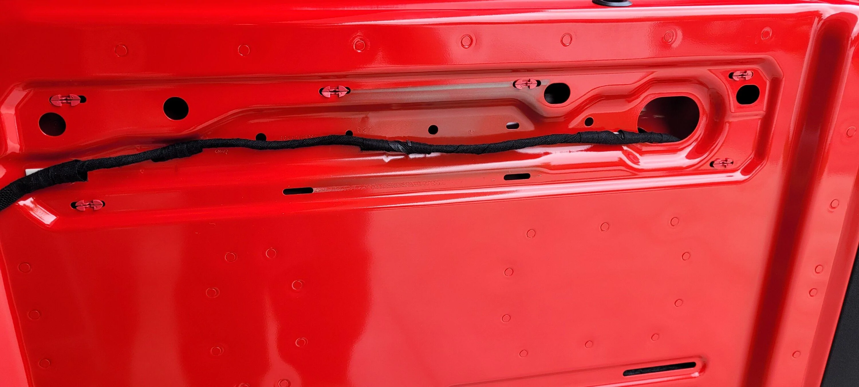

Mine looked the same but I did not have issues with them going into the slot. If I remember correctly, I did not keep pushing on the stud once it was started as it was going into the blind nut.

I feel like they are collapsing into the hole whether I push them or not. Any idea if these nuts are custom hardware or if I can go buy some more at home depot? Im not even sure to look up what they are called. I googled blind nut but dont see any that look similar.

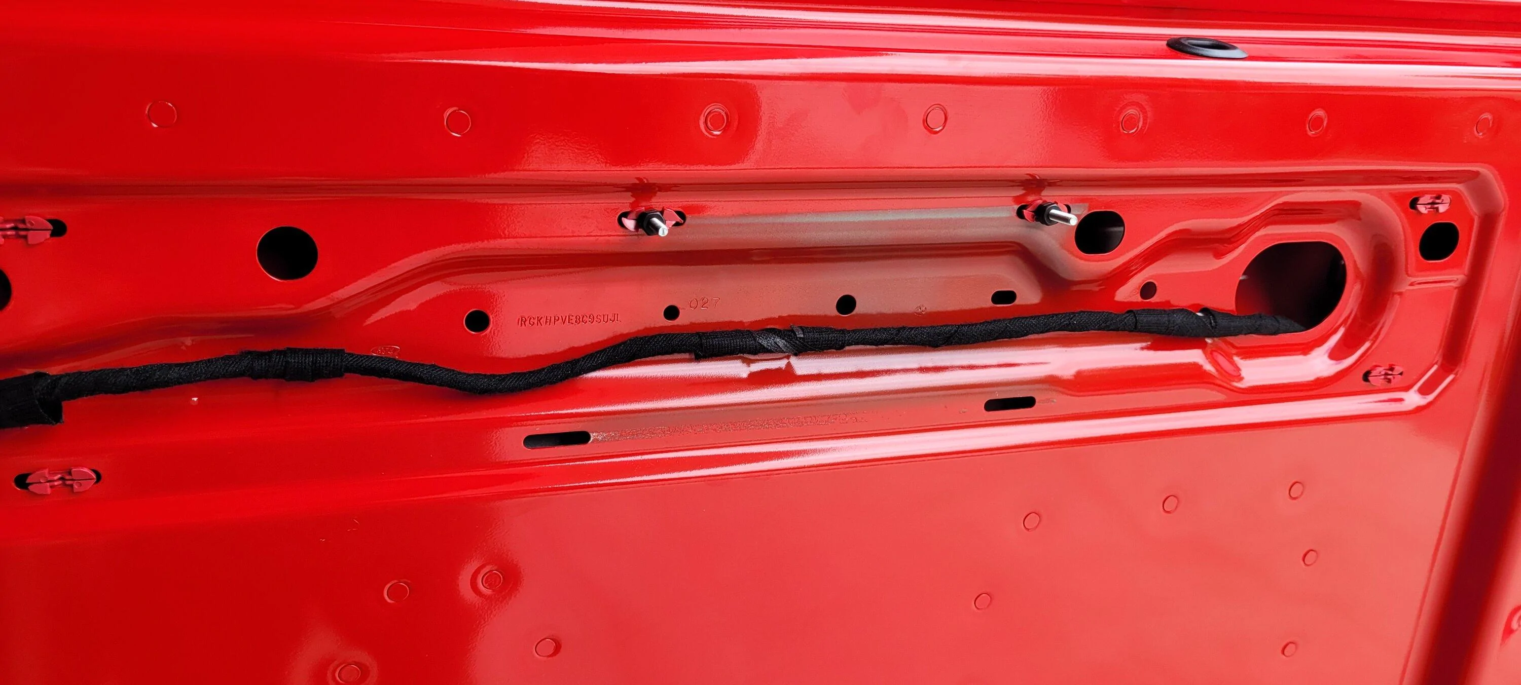

Once putting the “blind nut” in the appropriate opening, I widened the slot using a standard screw driver. It seemed to seat it more securely into the tailgate. It also created more space to screw the bolt in place. Hope this helps.

IIRC, that's actually in the instructions. You're supposed to spread them with a screwdriver before threading the bolt into them?
