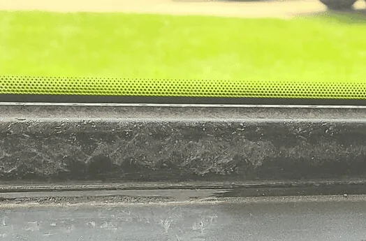

Mine was delivered 3 weeks ago tomorrow with no visible problems. Even the "raw" (non-rolled) edges were uniform in color and texture and the headliner fit was great.
As of today, we have the headliner separating from the roof panels in two spots, raw edges fading to light gray / white with small cavities visible from obvious material loss, the clamshell reveal line flexing to uneven width across the passenger side rear quarter, and warping / flexing around the roof mounting bolts in the cargo area.
If this much can happen on these things in 3 weeks, I anticipate a rough few months ahead for those of us with early MIC builds. They just weren't ready for prime time.

None of this make sense without knowing how these are made. You can't mold in a color (MIC) on a fiberglass cloth/resin top. FIBERGLASS needs a gelcoat; epoxy needs a polyurethane or epoxy paint coating. But some hypothesize that they're seeing the cloth lamimate.
If they're a laminate of 3 plastic layers, as others have suggested, that would suggest a heat press mold process with several material sheets. What is that? Is that used?
A third possibility is an injection mold process or a rotomold process. Is that used here?
https://3dinsider.com/rotomolding-vs-injection-molding/
Whats going on?
The tops appear to be multilayer composites that are compression molded for final assembly and appearance. They are not rotomolded (makes hollow parts), and they are not injection molded (makes solid parts and not to mention the size of the injection machine required is such that there are only a handful in existence in the world)

That 'finish' is absolutely horrible, and Ford should be embarrassed.
