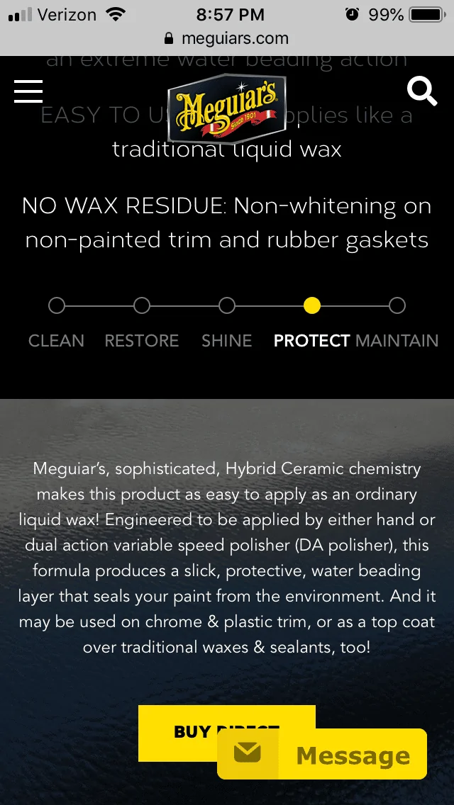

The product used claimes to be plastic safe. And, it's a 4x4 hard top! If a bit of wax can cause this, how can one possibly expect it to hold up to serious off road abuse?
The product he used says it’s ok on rubber and plastic trim.

Anyone else also experience this? Is it UV related? Reaction with Meguiars Hybrid Ceramic Wax? Something internal? 🤔

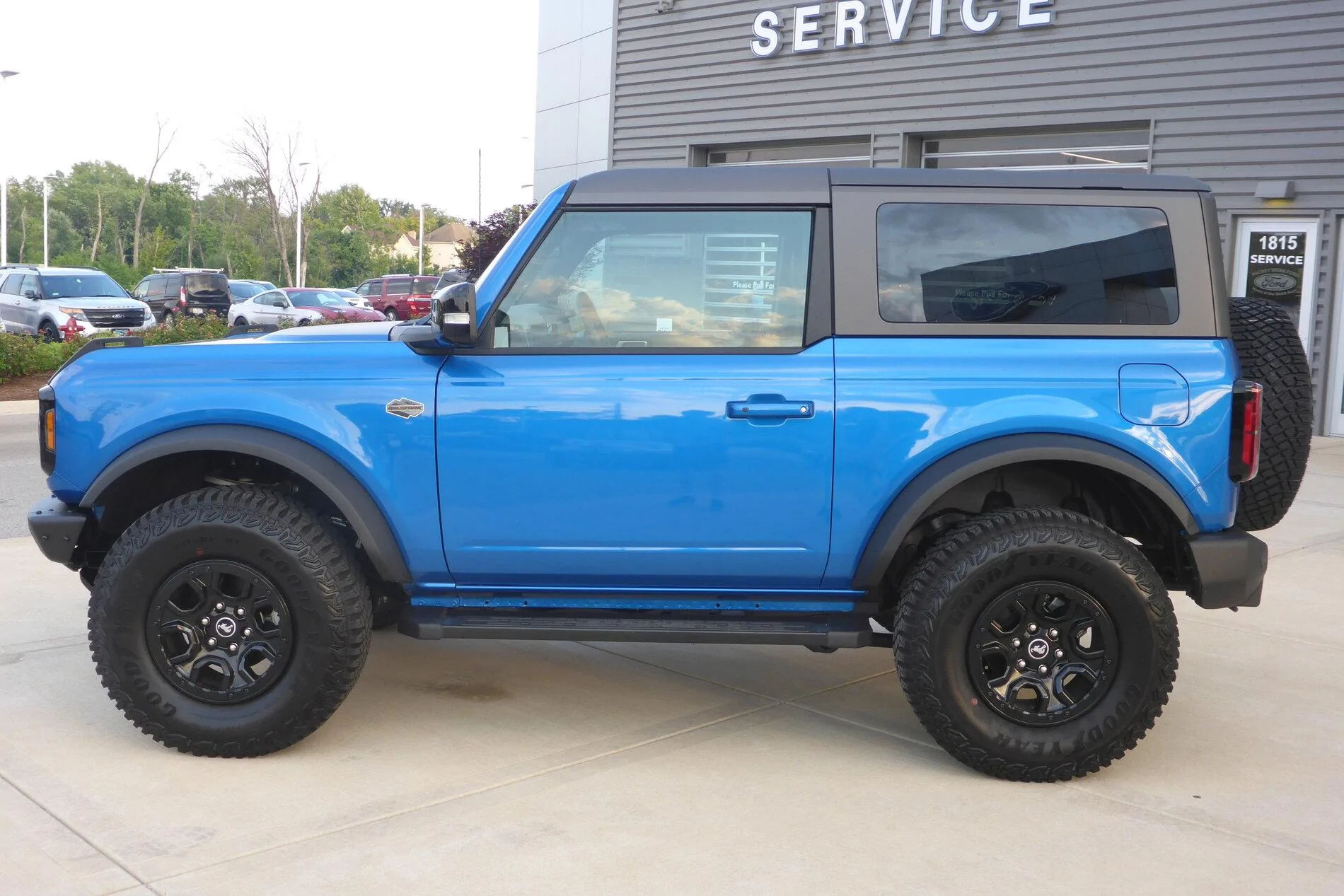

A couple weeks ago, I saw and test rode in a 2-door dealer demo with hardtop. (The Wildtrak shown in photo below.) I paid particular attention to the hardtop given the production issues.
I saw no honeycomb showing through the exterior surfaces. I viewed all sides and even climbed up on the rear axle tire to view the top. Pushed on the panels etc. I was viewing at around 6:30pm on a mildly clouding day. Not sure if a different lighting situation would show something else.
Overall the exterior surface seemed solid and the surface treatment even - meaning a consistent slightly textured surface. The only thing I saw on the exterior, were some scratch marks, probably when the dealer earlier had the top removed, and probably was not so careful about where they laid the panels.
And actually I tried rubbing out the scuff marks with my finger, and one of them seemed to be disappearing. I did that because many of us will be having tree branches and other stuff hitting the top, and I wanted to see if the scuff marks were permanent.
Overall to me the hardtop outside surface appeared strong and durable. But who knows over time - that I can't answer. Based on the OP and other photos, the build quality varies between tops.
