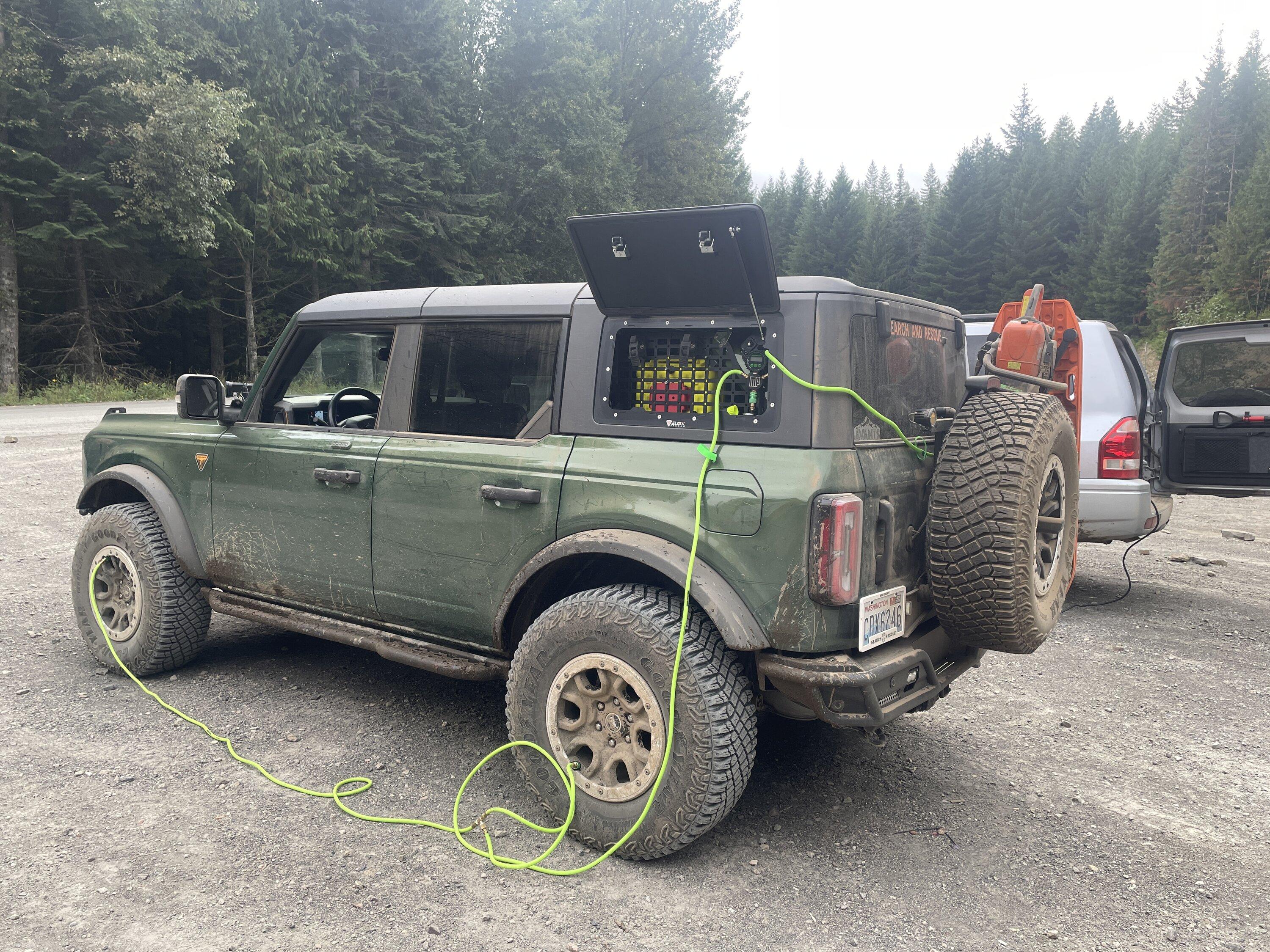

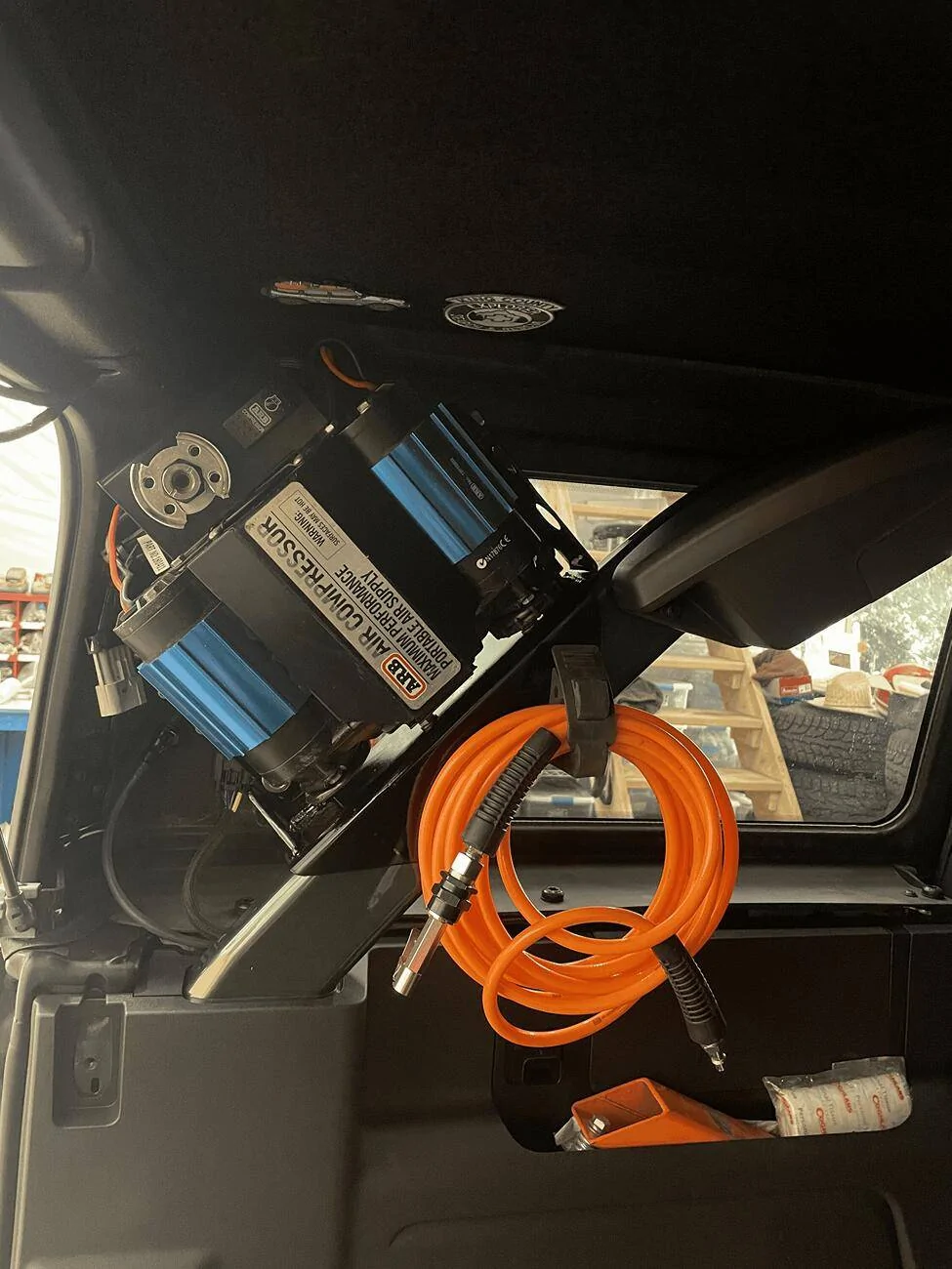

I left my passenger side open for cargo area access and have a molle panel and air compressor/first aid kit set up on the driver side.
Ford Bronco Velox Gull Wing doors installed in MIC hard top 3E03B3F3-42D2-4410-AF89-A01D16D177E9
Solid product that adds a lot of utility to the bronco for me. Its so nice having my air set up ready to go, just pop the door, flip the switch connect tire.

@Mikerider How has the windows been performing? Any issues with leaking or otherwise?
Working good! no leaks to speak of. The fitment of my passenger side door could be a little better but no leaks! I love the functionality of them.

Nice! I am looking to use it as an air up location as well, I was thinking about adapting a Kracken system or ding my own version from McMaster parts. I am also thinking about installing a diesel air heater for snow wheeling, build a sold shell behind it.
