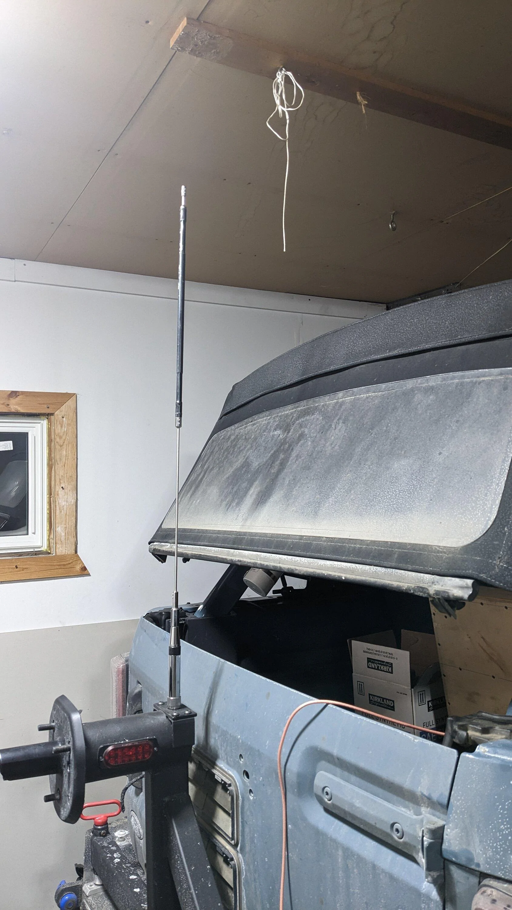

Got my antenna mount made for the tire swingarm and discovered it's now 4" taller than the garage door. This, while already missing the top whip section. πŸ€¦πŸ»β€β™‚οΈπŸ€£
Oh well, that's why the base has a quick threaded hinge to fold it with.

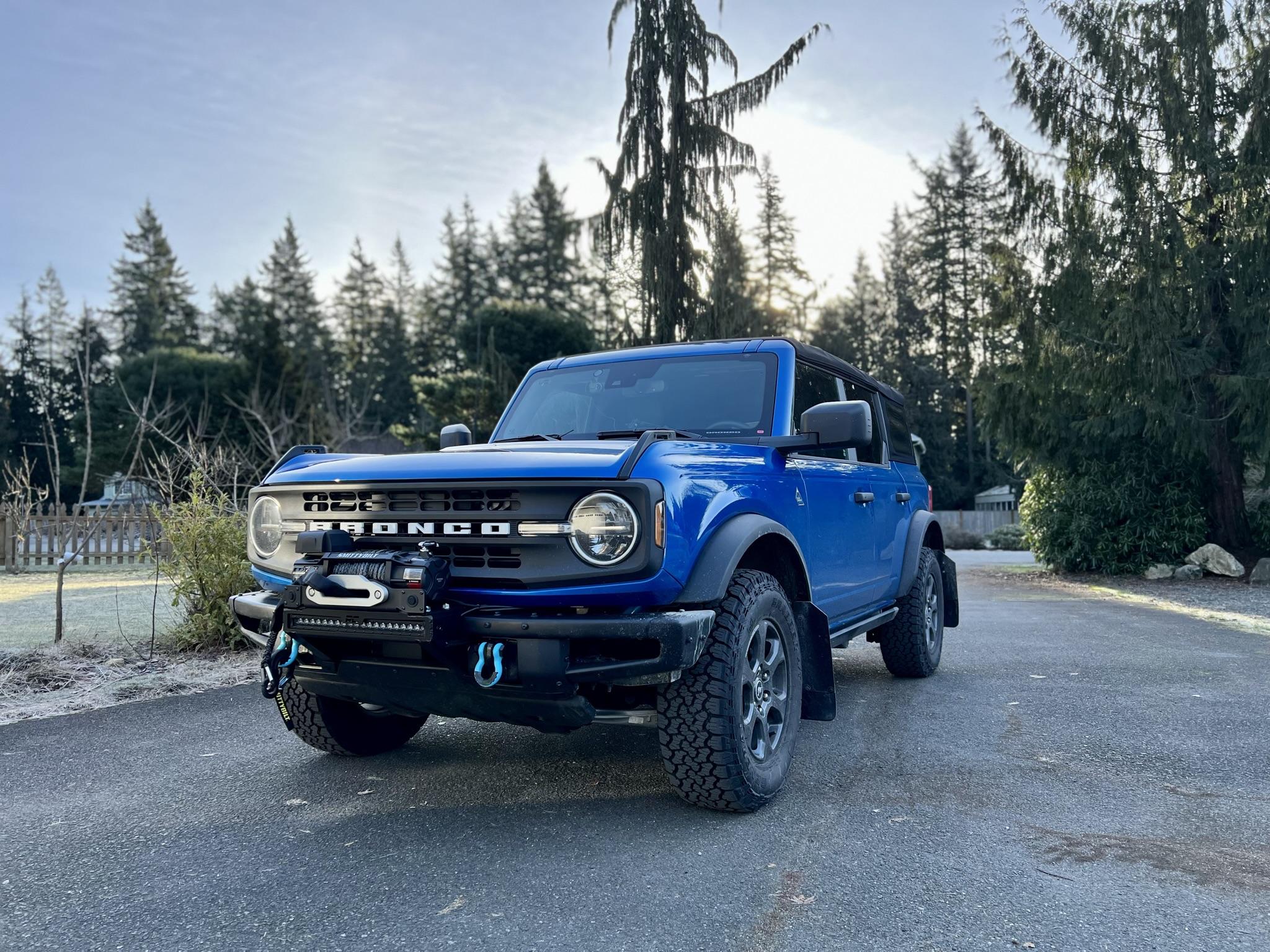

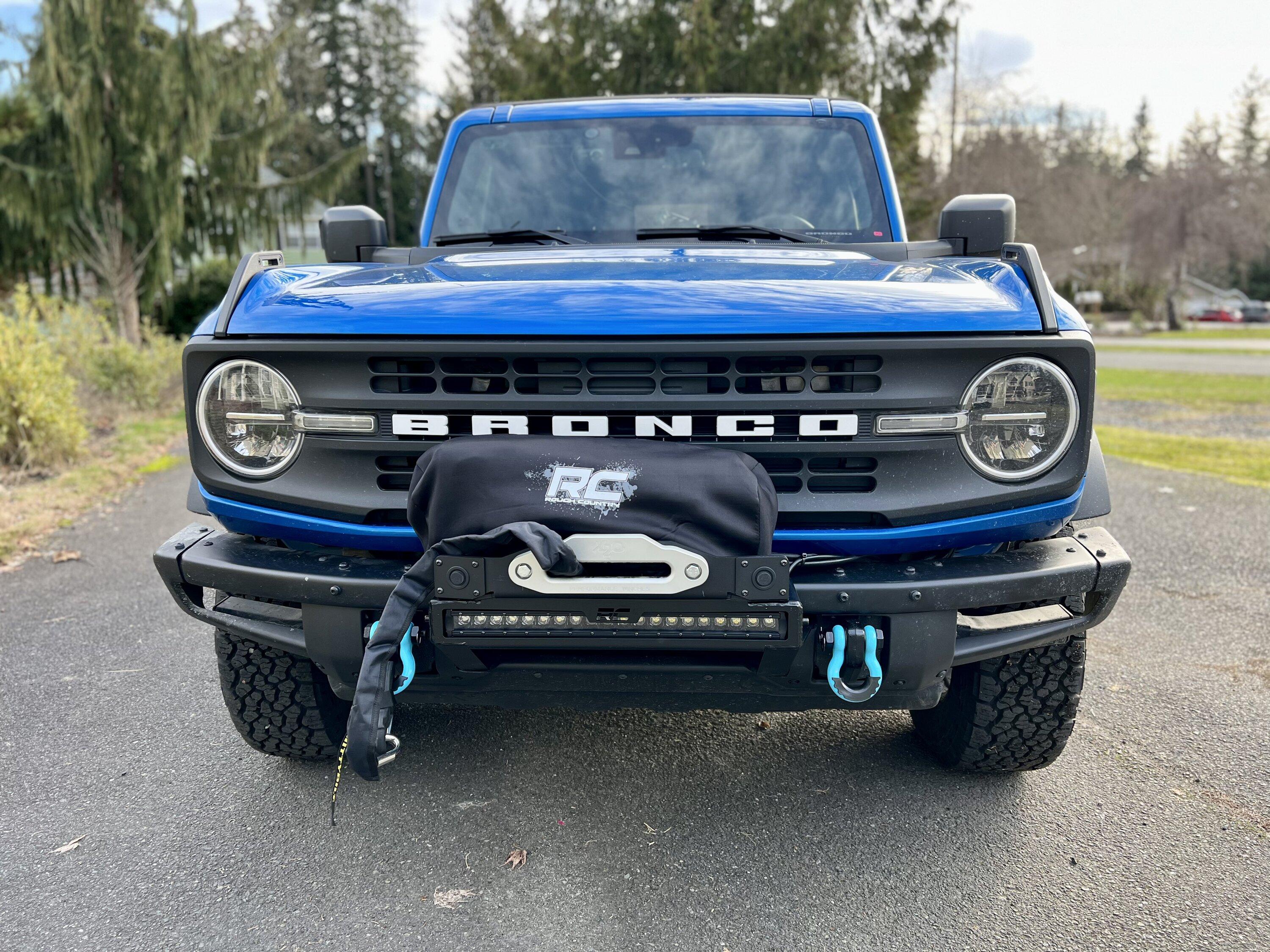

Installed a winch cover for my newly installed RC high winch mount & X20 winch:

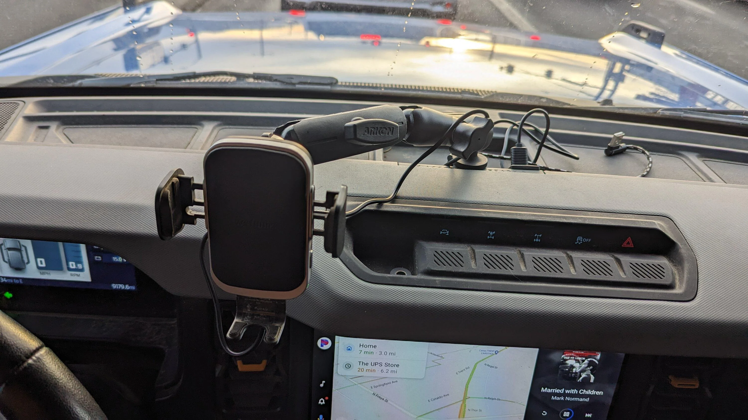

Trying a new phone mount setup. I was using a suction cup arm but it would get to warm in the summer. This will let me place the phone on front of the vent in summer, away from it in winter, or swivel for unobstructed recording.
Some cable management left to be figured out.

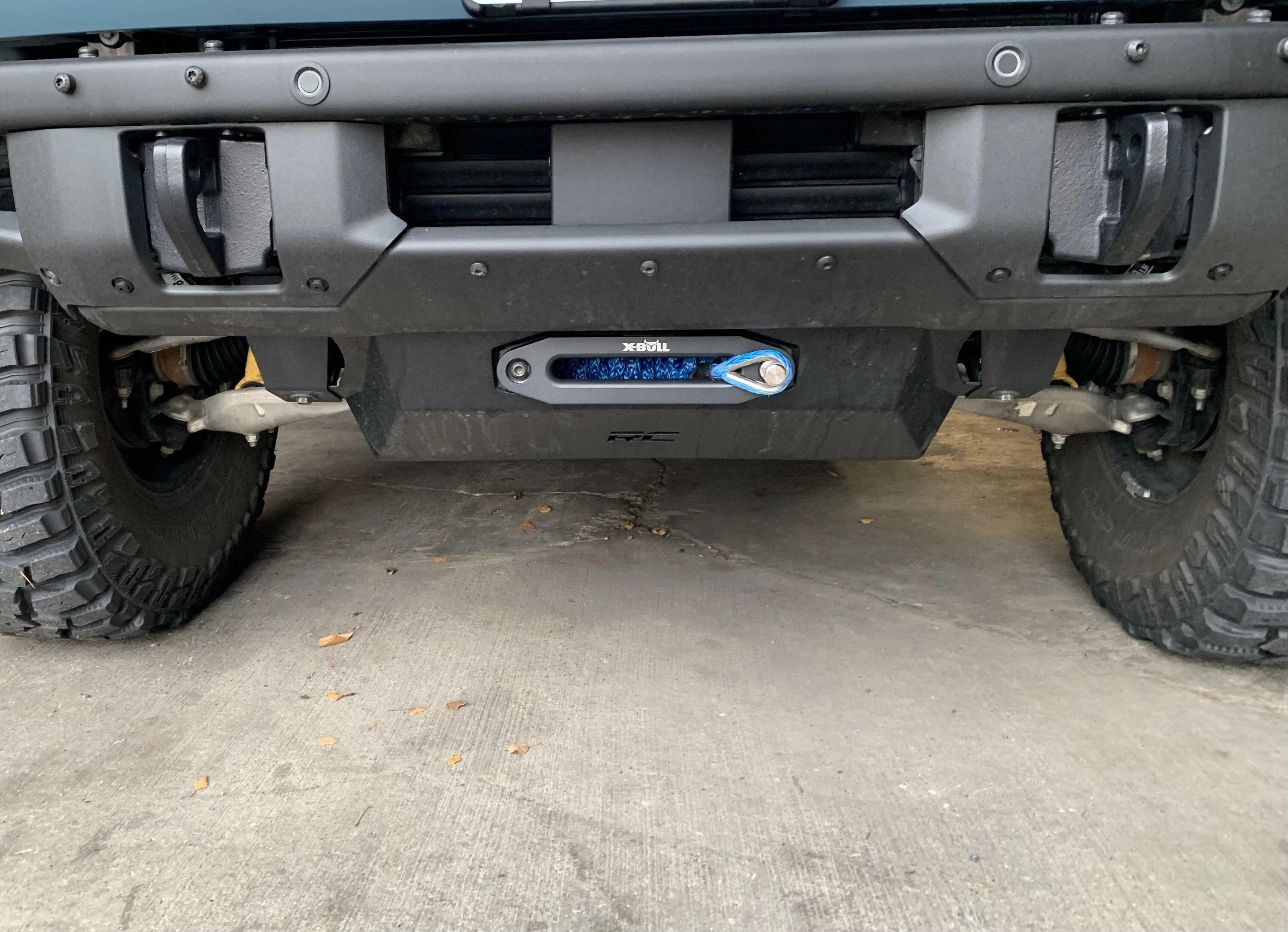

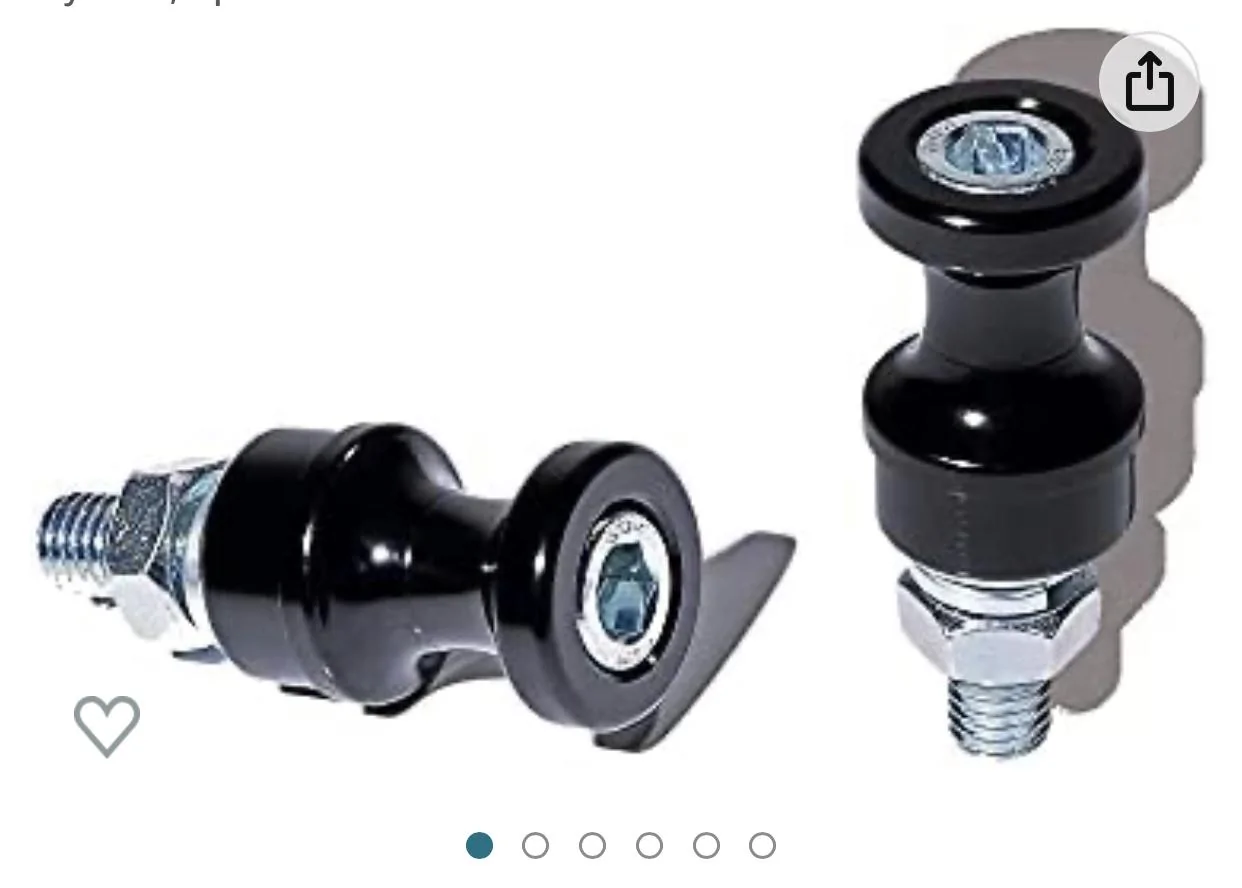

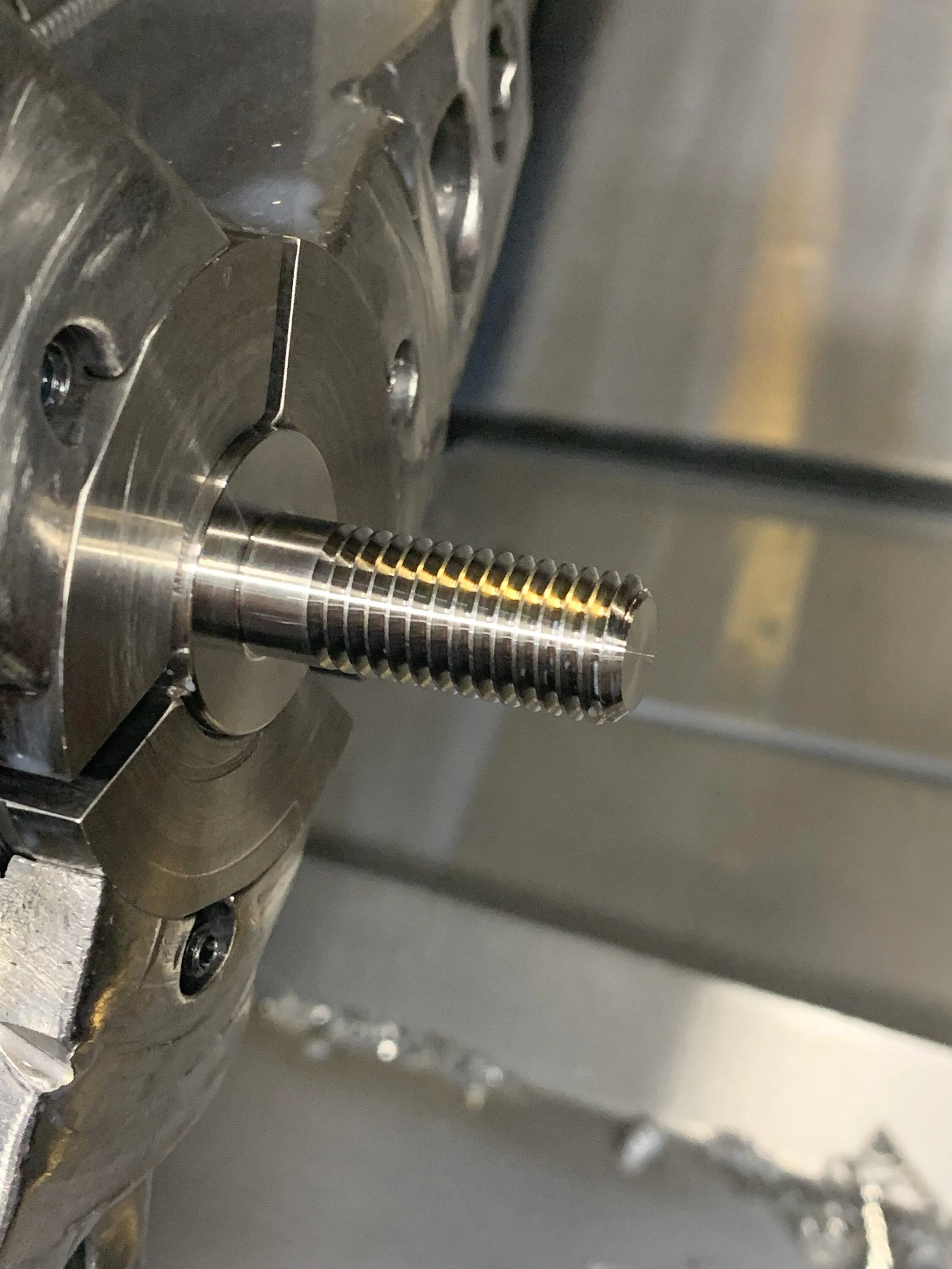

Got tired of looking at my winch rope attached to a bow shackle on the bumper. It looks tacky and the shackle gets exposed to road grime etc. while browsing the interweb I came across these fairlead studs and figured I could make a better one
Ford Bronco What did you do TO / WITH your Bronco today? πŸ‘¨πŸ»β€πŸ”§πŸ§°πŸšΏπŸ›  PXL_20230202_001432641

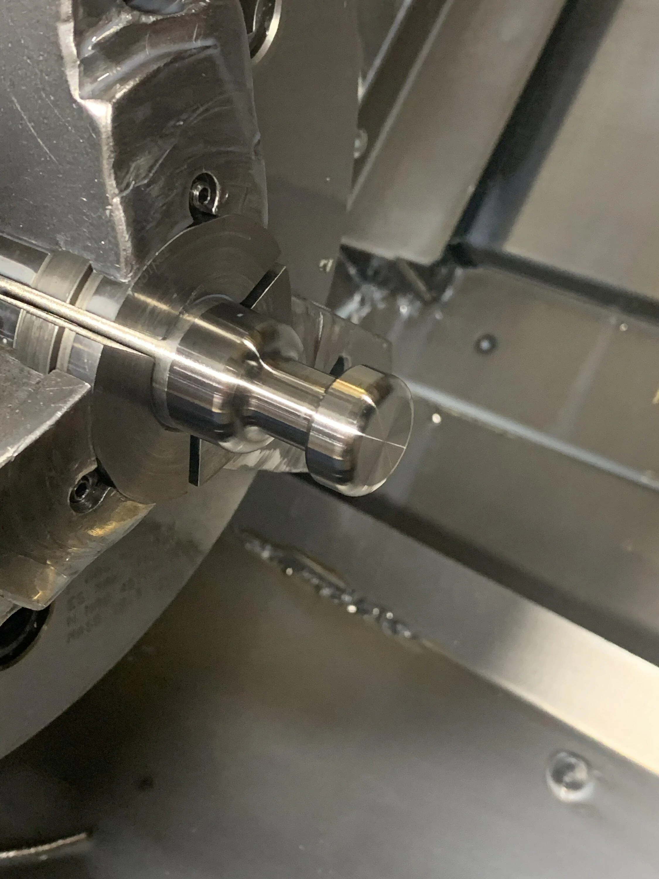

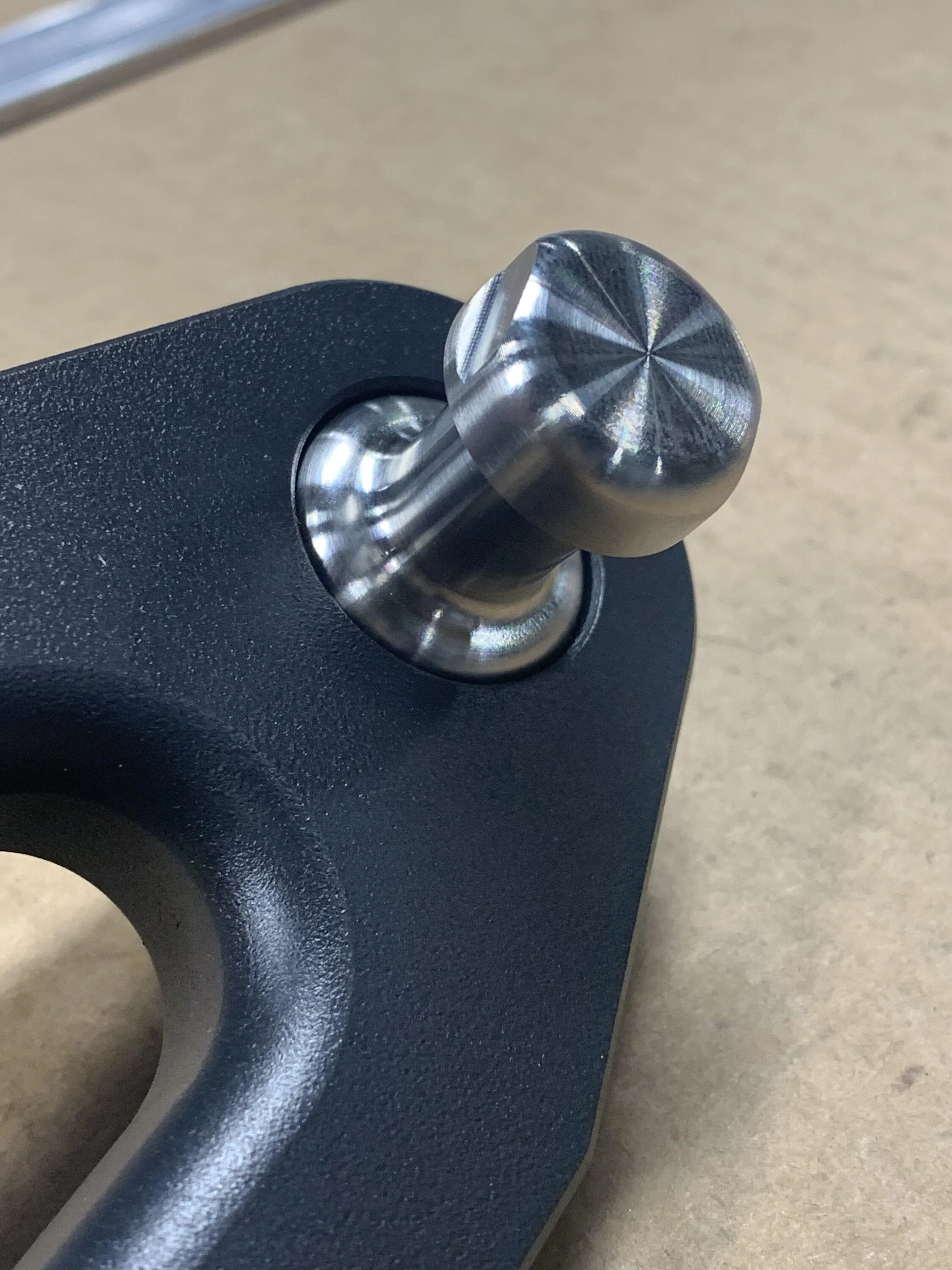

I didn’t like the long threaded bolt going thru the middle ,and 10mm threads wouldn’t match the M12 nuts welded on my skid plate. So I grabbed a chunk of Nitronic 60 off the shelf and fired up the lathe.
Some tasty M12x1.75 threads there.

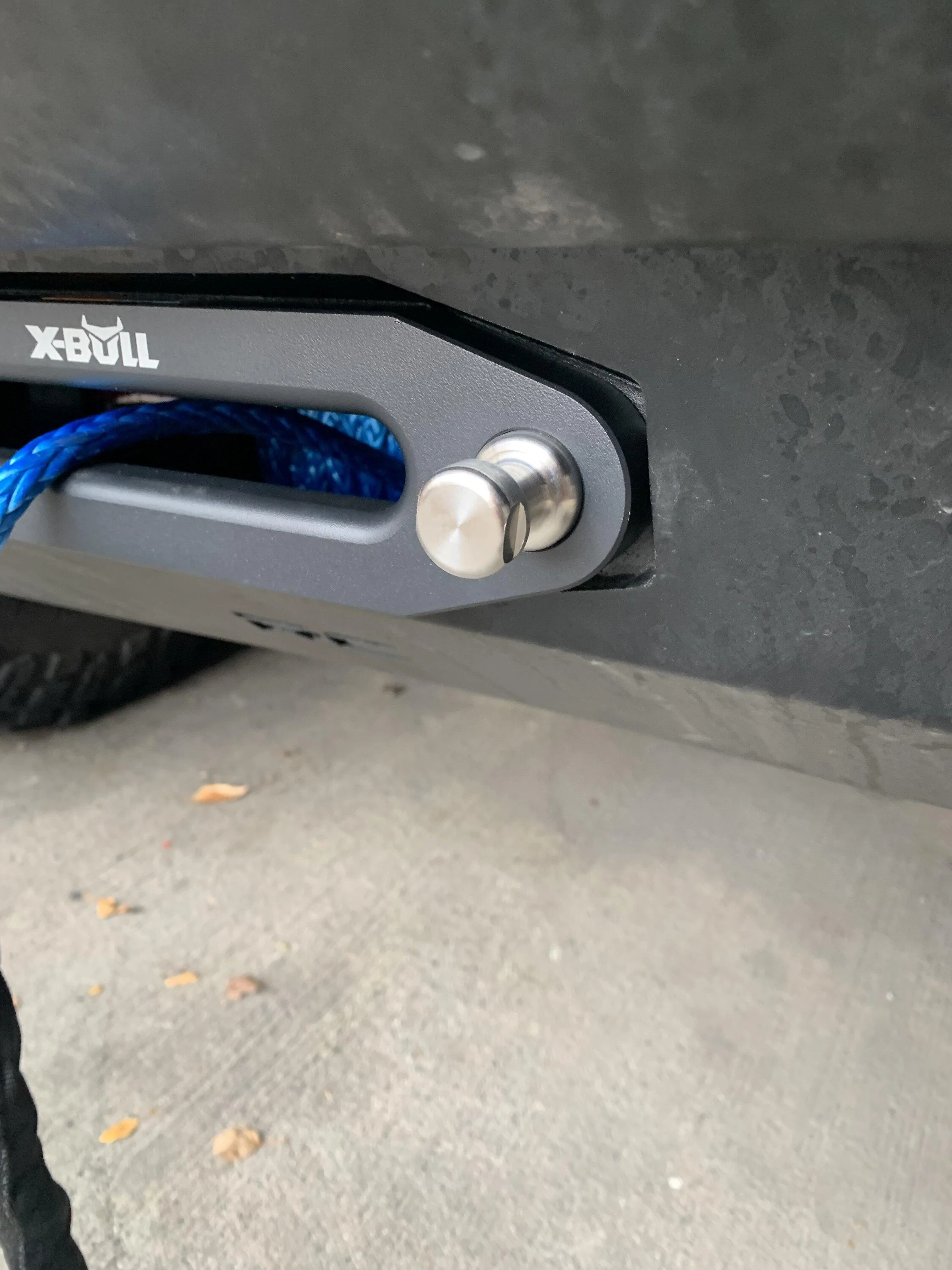

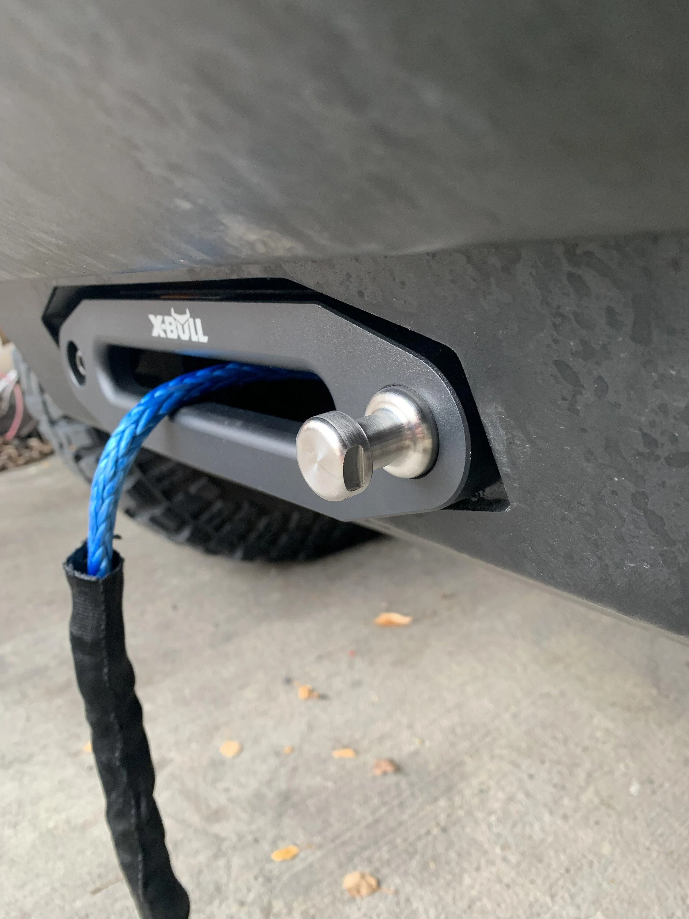

Test fit
installed. Since this picture I’ve taken the metal thimble off the eye of the rope. Much much cleaner looking

Holy crap. willing to make some to sell?

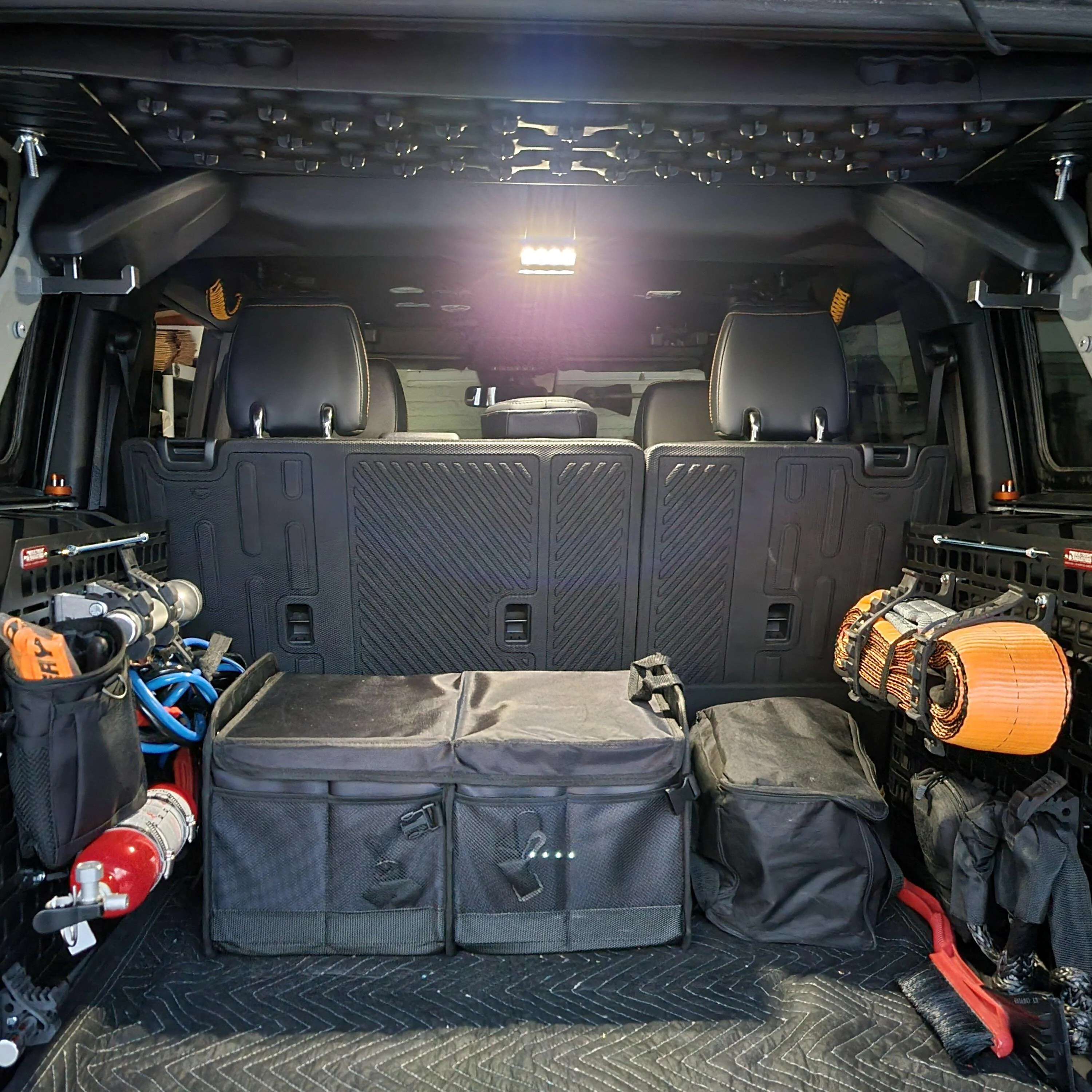

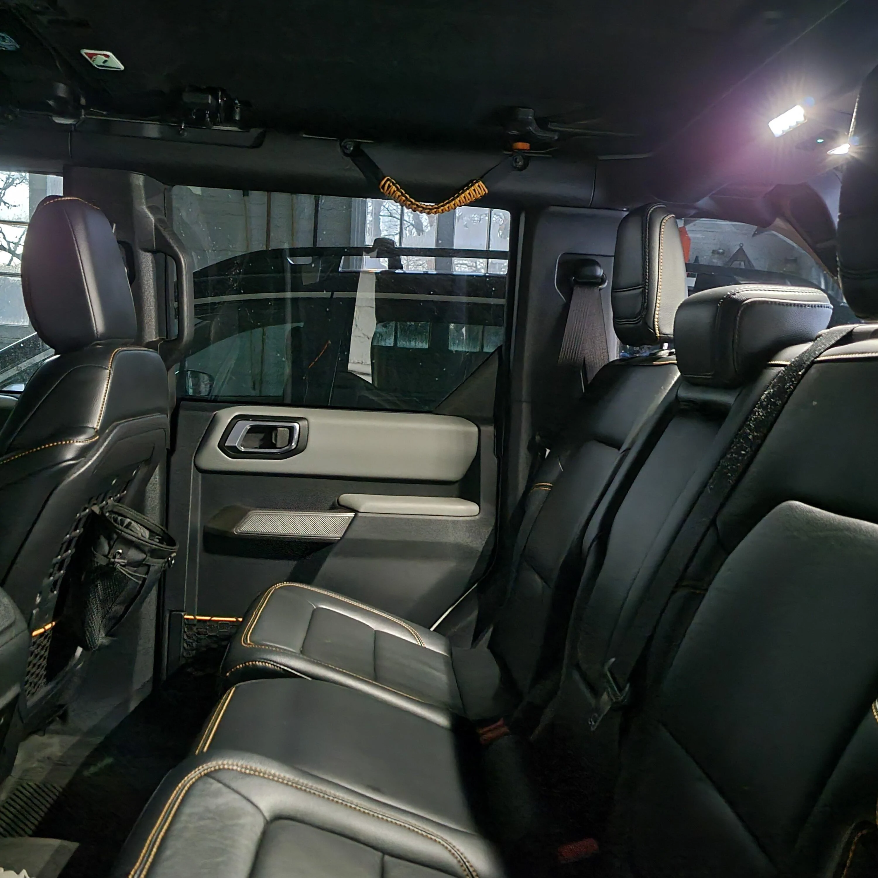

Oh yeah and I installed the Mabett backseat/rear cargo light today.
