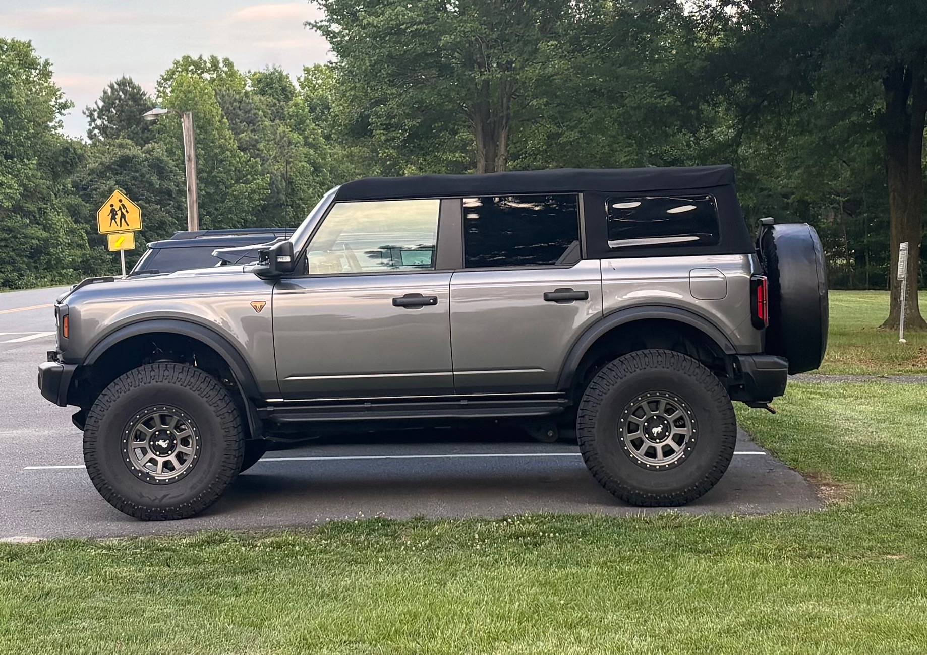

Milestar Patagonia XT tires, 2.5” Eibach springs stock Bilstein suspension lift, 2.5” body lift (custom) no other trimming
Ford Bronco WHAT OFFSET DO I NEED TO PREVENT RUBBING? IMG_1699
JWool
Feb 14, 2025
42
2020 GMC 2500 Denali Duramax
I am running Icon wheels with 16mm offset.
Yes I had to remove the crash bar and the plastic thing in the lower rear behind the liner and some trimming on the factory rock guard, I had a slight rub using forged aluminum A arms then switched to a BDS a arm and no rub.
from my costly trial and error, not all parts from different manufactures always just bolt and and work well with the others.
Some shocks and springs may work great with some a arms and some wont play well together.

Mickey Thompson Baja Boss 37x12.50

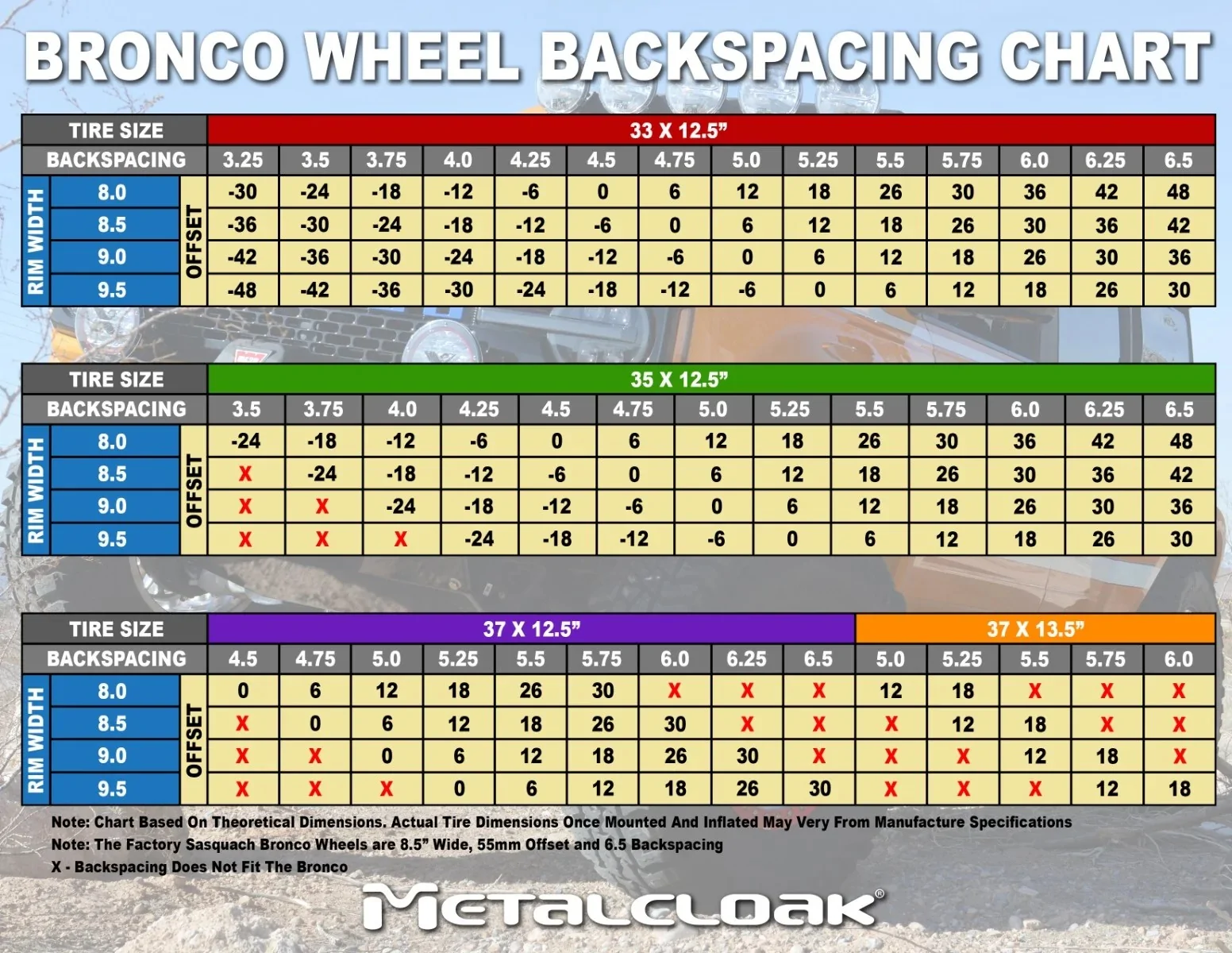

I am thinking about going with Icon stage 7 suspension lift kit and Icon tie rods as well. The tire I plan to run is a 37x13.50r17 Toyo Open Country MT one of the biggezt 37s at 94 lbs and true measurement of 37x14.6r17.. Right now I got the Badlands Sasquatch, If I get a 17x9 wheel with a 0mm offset, jks clearance kit, and removal of the end caps on the front bumper, will these mods be enough to clear those tires in extreme offroad conditions like max articulation, compression, and lock to lock wheel turning? I was on the tire size website using their offset calculator and it indicates 0mm offset wheel will clear this tire but not sure if this is rezlly the case or if I maybe need to go with a -12mm offset and maybe even an additional 1-1.5 inch body lift. Please help lol.

It looks like Metalcloak has a wheel size, backspace, and offset chart when running 35x12.50r17, 37x12.50r17, and 37x13.50r17 tires. I am assuming this only works with their new gamechanger lift kit for the Bronco, but not 100% sure. I want to run 37x13.50r17 Maxxis Razr MTs and according to their chart if you want to run 17x9 size wheels and 37x13.50r17 size tires +12mm to +18mm offset is the only safe range. . Other aftermarket lifts li,e Teraflex RTR or Icon claim that your wheel has to be a minimum 4.75 backspace fir a 17x8.5 wheel which is a 0mm offset and on a 17x9 wheel a -6mm offset is equivalent to 17x8.5 at 0mm. Well according to Metalcloak going with 17x9 with anything more than +12mm is not a good idea when running 17x9 wheels and 37x13.50r17 tires. What do you guys think about the chart numbers when running 37x13.50 on 17x9, is this legit or is it assuming something lol?
https://metalcloak.com/blog/bronco_...tJxlNvX61Gj9md5yjB3ySj7Pcbea4xxhnOC_hWTSbhV7_
