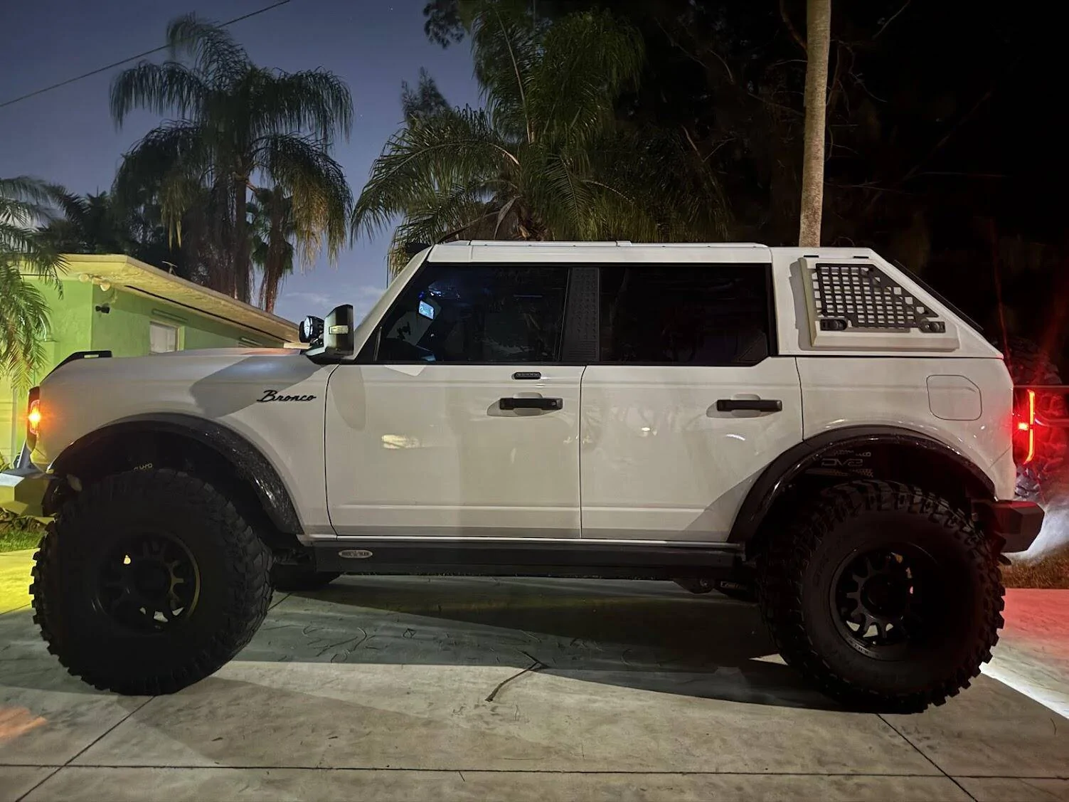

1.5” broncbuster spacers with factory SAS wheels put it at a 0 offset which lets our Wildpeak 37x12.50x17 have zero rub and clearance with a4” Zone and a 2” body
Ford Bronco WHAT OFFSET DO I NEED TO PREVENT RUBBING? IMG_7614

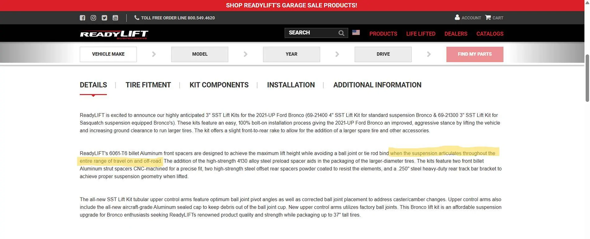

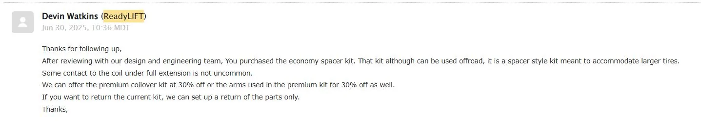

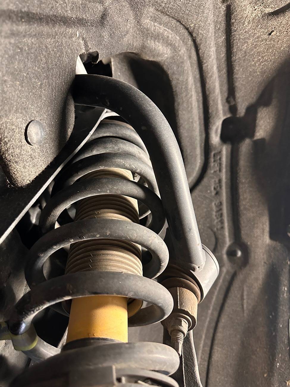

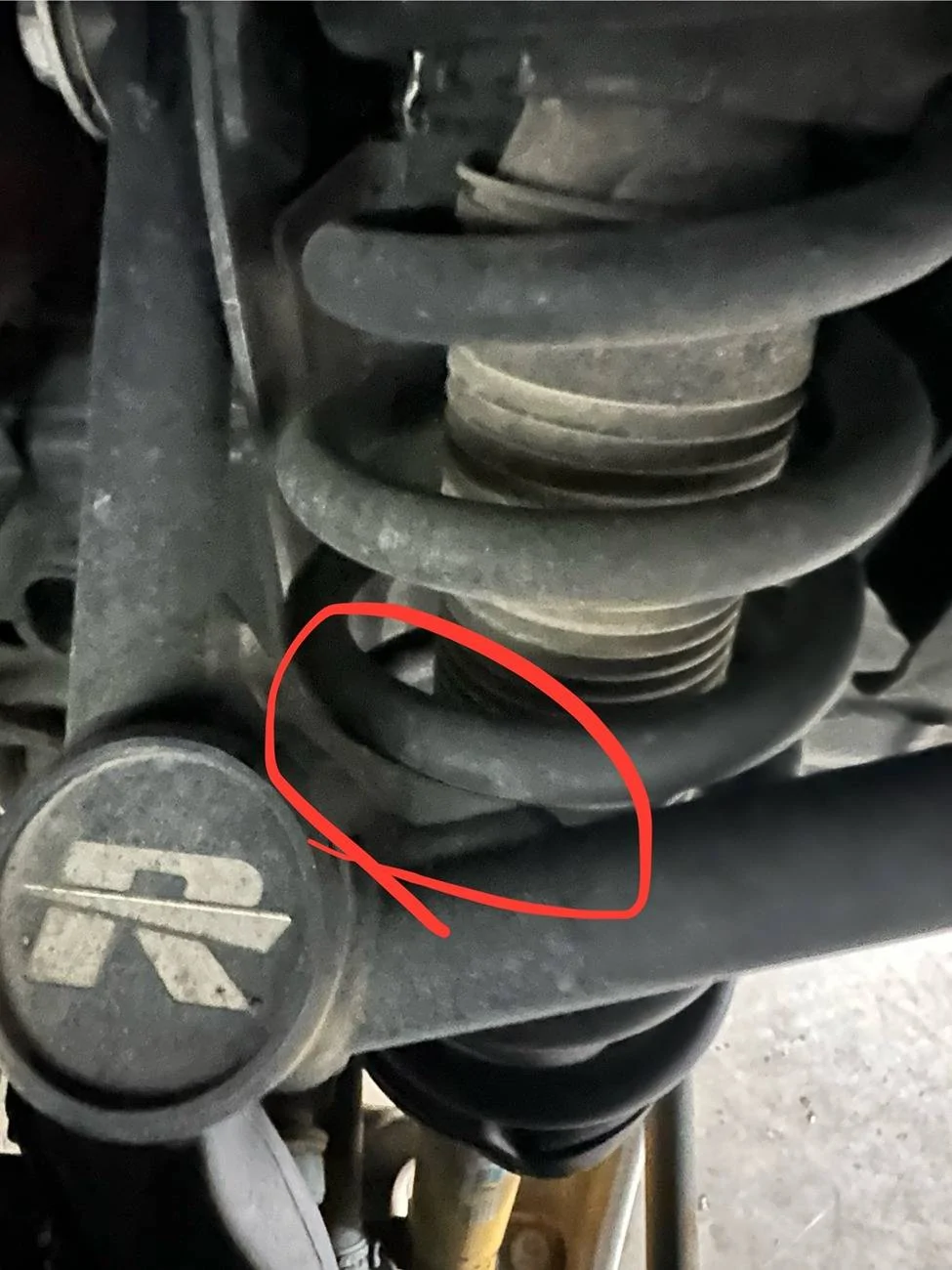

Please beware before purchasing the ReadyLift SST 3" Lift:
The UCA contacts and damages the OEM coil spring when the suspension articulates, especially at full articulation. Disconnecting the sway bar increases the amount of rubbing/damage.
ReadyLift acknowledged the issue. Claiming that with their "economic kit" (this one), rubbing is "normal", "not uncommon", and that this kit is intended for "normal driving conditions", and meant simply "to clear larger tires." They also dismissed the metal on metal rubbing and chipping the springs as not a safety concern. Overlooking the fact that some live in the PNW. Others may live with severe winter conditions. Rain, snow and salty roads are part of many daily lives. A chipped spring and constant friction between metal on metal will cause corrosion in just a short amount of time - especially if you live in a place that gets rain 165 days per year.
Their website under the product description states that this lift is designed for both on and off-road use. And there should be no issues "when the suspension articulates throughout the entire range of travel on and off-road". The problem is that this claim fails to address that the UCA will contact the springs. This is the reasoning behind my claim that it constitutes false advertising, or at the very least, not being completely transparent.
ReadyLift proposed solution is to pay for an additional $1,500 out of pocket for an ‘upgraded’ set of ReadyLift UCAs, or return the current kit for a refund. Both in which the costumer would have to pay for the shop labor.
My intention is just to bring awareness.

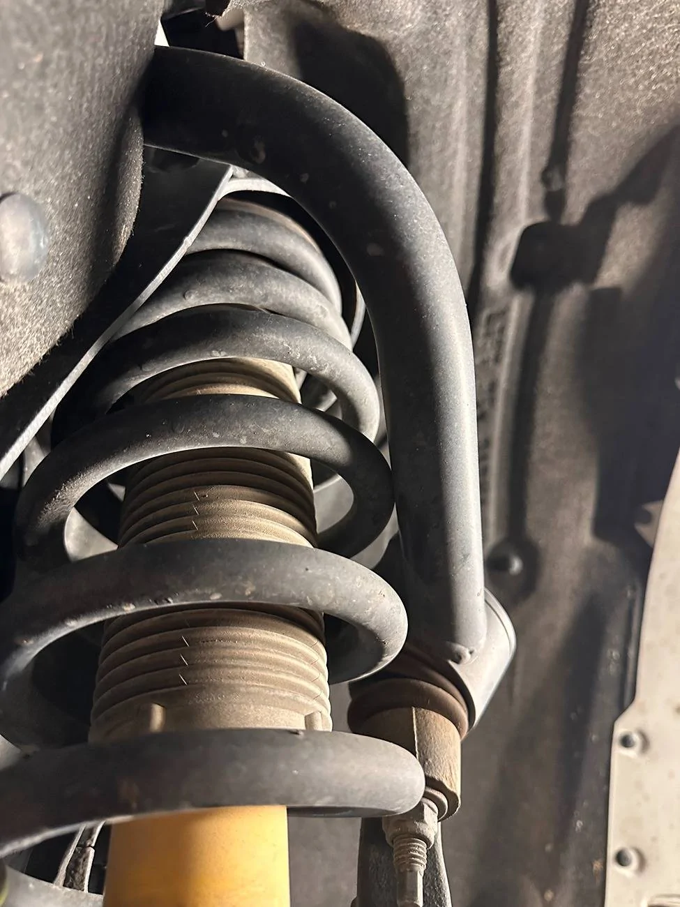

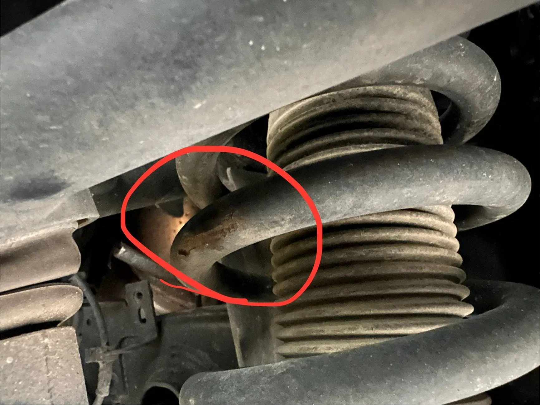

Avoid ReadyLift like the plague! I have installed their SST 3" Lift (advertised for the Badlands/Sasquatch) on my Bronco Balands, and the UCA touches the coil spring at full droop, and with the sway disconnected is even more disastrous!!
Upon contacting them, they are trying to blame the installation, saying the top hat must be 180 ° rotated. A well known offroad shop sponsors me, and the installation was properly done with top hats rotated per the installation manual. But to avoid any he said she said, I paid for the labour of two other shops to check their work and they confirmed that the installation was indeed correct.
This is a design flaw on ReadyLift's part. I have another fellow Bronco owner on this forum who is going through the same issue. In both cases, ReadyLift is playing dead and not collaborating to rectify the issue and provide a solution. They have been avoiding our calls, and e-mail communications are just "we will check with our engineers" with no follow up. Steer clear of this company! They offer badly designed products, provide poor customer service, and are not worth spending your hard-earned money on. Save up a little more and get something from a reputable shop.
Just my two cents, best to learn from others (my) mistakes than falling into the same trap hole.

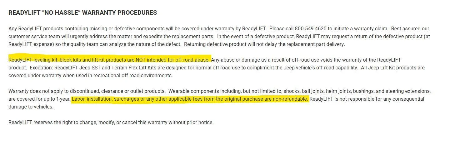

It's interesting you brought this up, I was on their page just now and they recommend +18mm offset wheels when using their kit, they also claim at the +18mm positive offset you can run 37x12.50 tires as well as 38x12.50 tires. Your picture illustrates the upper control arm rubbing on the spring, could this be because you followed their recommendations of using +18mm offset wheel but in reality this is bad advice as it is too close for inner components of that size tire. I was kind of surprised at that, I thought they would recommend 0mm offset the way ICON does; however, they brought it in another 0.7 of an inch which is kinda wild. Man this tire fitmeny crap is begining to really piss me off lol. Again thanks for sharing the pics.
Audiomate
John Doe
Dec 27, 2023
207
268
Somewhere in the mountains
Haha I feel you! Im running 0 offset wheels. For the jeep platform this is was the ideal offset when lifting the rig and running larger tires. For the Bronco I’m not quite sure as I went straight to zeros because if anything like the Jeep, positive rubs and negative stresses the suspension components. But like I said, dont quote me on that for Broncos. They acknowledge that with their ‘economic’ lift rubbing is not uncommon on the UCA and springs since these kits were designed for ‘normal driving conditions’ and to simple ‘clear larger tires’
It’s a solid product, too bad this happens. Worth checking with them directly and asking what their return and refund policy are should you have a problem
This contact (in the photo) has absolutely nothing to do with the wheel offset.
