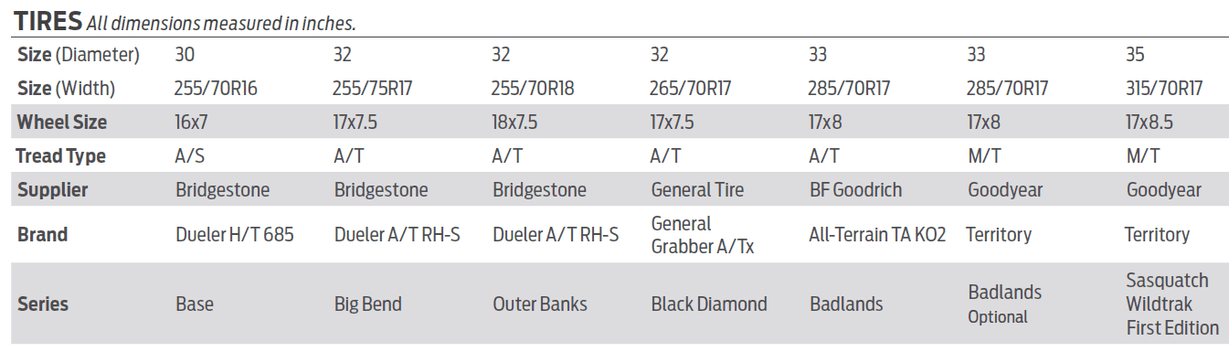

Please see the Bronco tire chart below for sizes and brands. Any pictures or videos you have seen of the Broncos are simply pre-production rigs with a mix of brands.
Your comparing the heavier load range C Wildpeak, the 33" - 285/70R17 Wildpeak A/T3W's I'll be putting on my Bronco are the lighter weight load range SL, while the specs to show they way the same as the KO2 load range C, the sidewalls have a reputation for toughness and they have thicker treads, which accounts for some of the weight. Since they are the same weight as the Bronco KO2's load range C tires the Bronco will handle them just fine along with the benefit of a better ride, lower noise, they don't hold stones or mud like KO2's do and they cost less.
Thank you so much for the post and the find, I somehow had missed the chart. This nails it.
In terms of load ratings, Falken Wildpeak will be 5-12 pounds heavier per tire, in the sizes we are considering. Example is Wildpeak 285/70R17 SL 51.5 lbs
Cooper At3 285/70R17 SL 45 lbs
