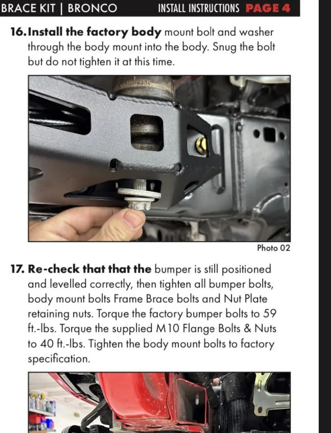

Things that jump out to me that folks might want to consider;
1) The cost! 500 hundy is a lot for this kit
2) This most definitely voids the frame warranty, this may not be any concern for off-road users. On-road is different as the crash bars are there for a reason - federal crash standards so
user beware!
3)Looking thru the instructions there are no torque specs - when tightening the bolts running
thru the frame rails, overtightening the hardware could start the collapse/deformation of the horn. My gut says if this kit had an engineers stamp on it there would be torque specs. Early collapse will change the crash characteristics. Maybe a nothin burger - maybe not
I'm not trying to dump on this kit - it's nice to have vendors working on solutions, but some do carry more risk than others. Whenever you modify the frame and alter body mounts, there is risk.
I like the idea of the kit but would definitely be asking questions from the manufacturer before I order
1) Price is definitely based on opinion. I personally think it’s pretty close to fair. There is a frame horn brace and crash bar delete that you can buy separately and they are pretty close to this price together. This is a all-in-one complete kit.
2) Your right that this probably changes crash characteristics, but so does any aftermarket bumper.
3) The instructions do include torque specifications. There is also a cross section that extends through the frame in the same area as this kit. It would be very difficult to deform the frame in my opinion.
Just my opinion on your concerns
