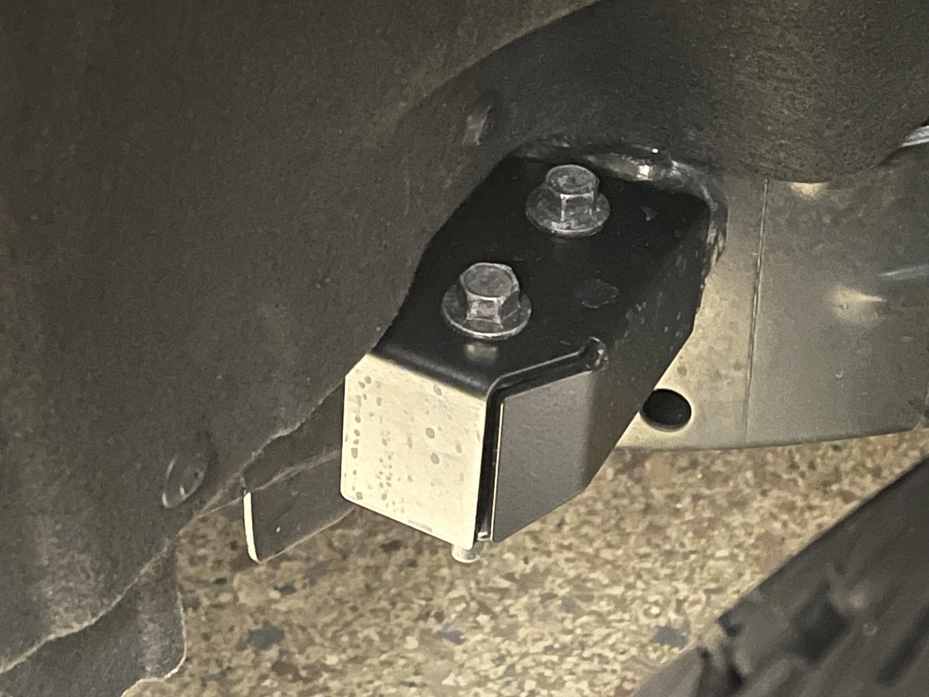

1) Price is definitely based on opinion. I personally think it’s pretty close to fair. There is a frame horn brace and crash bar delete that you can buy separately and they are pretty close to this price together. This is a all-in-one complete kit.
2) Your right that this probably changes crash characteristics, but so does any aftermarket bumper.
3) The instructions do include torque specifications. There is also a cross section that extends through the frame in the same area as this kit. It would be very difficult to deform the frame in my opinion.
Just my opinion on your concerns
@Weekends & Waypoints I missed the torque specs , thanks for posting that, my apologies for missing those.
yeah price is definitely subjective
This change is not like adding a bumper, cutting off a part that was designed specifically for crash protection is definitely beyond just adding components.
What do you mean by " cross section that extends through the frame in the same area as this kit"?
I did not see any spacers included

I like the idea of the kit but would definitely be asking questions from the manufacturer before I order
So what is your point? You are not going to buy it so you just dump on it? Maybe valid if you back that up with any real data. But you provided nothing that someone sitting in their garage after mowing the grass might come up with.
And you are worried about this bracket in crashes, but you didn't blink at the completely non-factory bumper?
Frontal crash video showing how strong the front of the frame rails are, or at least their failure mode. I do not see how this product changes this. Offset crash tests never hit the frame, it's offset too much.

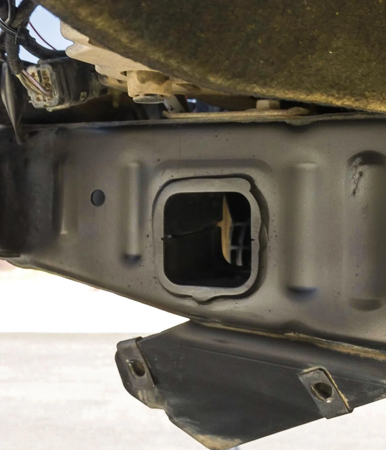

Definitely not disagreeing. It does make a difference. I was just comparing that adding almost any component can change crash characteristics, it’s the risk we take to get functions we want in our rigs. Removing a “crash bar” will for sure make a difference in that very specific situation there were added for.
I was referring to the square stock that ford has welded on both side through the frame in the same area that this kit sandwiches. This is the best picture I could find.
ahh I gotcha now. yes the square tube gives a ton of cross section strength, but where the kit bolts is right between the crash initiators for the front horn. Over torqueing the hardware could start to deform the dimples. Lots of ford design time in that area. I'm not sure how much it torque it takes to deform, but I would hate to find out lol
