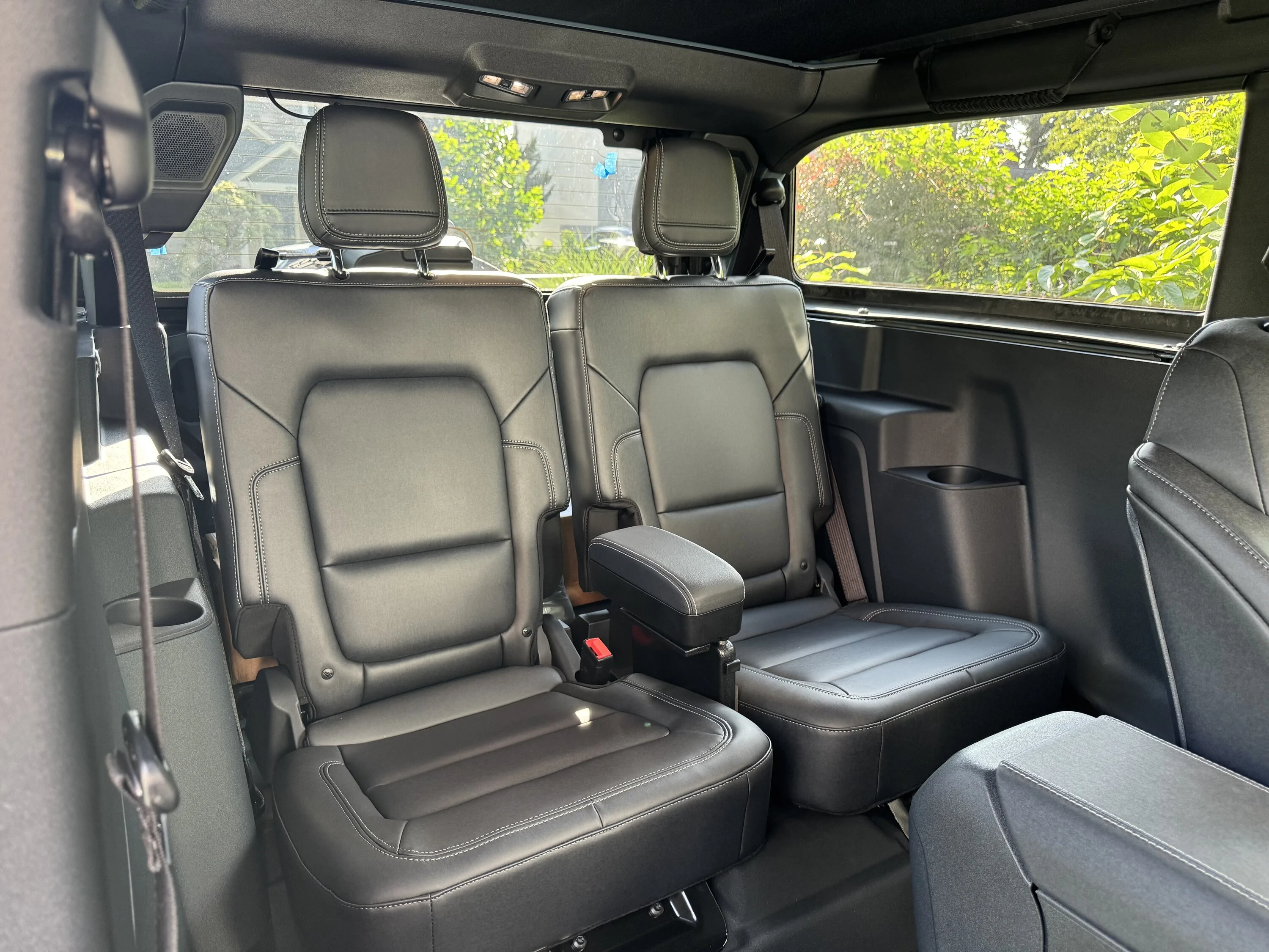

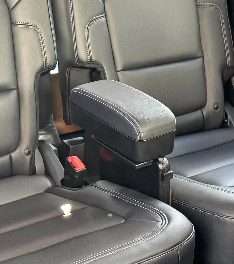

One of the only things we’ve ever found lacking in our 2-door Broncos was a center armrest for rear passengers. We regularly fold and occasionally remove the driver-side rear seat for our medium-large-sized (~110#) dog, so we wanted it to (1) allow folding of the driver-side seat without armrest removal, (2) not have to be rock-solid, but to be stable enough that one can plant their hand there when entering the rear seat, (3) be easily removable for folding both seats when/if needed with no rear passengers.
Before:
Ford Bronco 2-Door Rear Armrest Option Now Available! …as DIY from Amazon. IMG_6222
After:
Ford Bronco 2-Door Rear Armrest Option Now Available! …as DIY from Amazon. IMG_6225
We went with a simple solution that’s worked very well over the car’s first roadtrip (though we’d make some minor changes now that we know it’s worthy of being semi-permanent).
  1. Order a cheap-o removable armrest from Amazon
    In our case, we ordered one with finish similar to our new ‘25 Badlands’ interior (black MGV, White Stitching): https://a.co/d/dXzr9fr
  2. Add Corner Brackets (from Home Depot, etc).
    Notes:
    1. In our case, we installed two (2) 5" corner brackets from Home Depot with the brackets mounted low on the plastic base so that our daughter would have an above-seat barrier from the dog. But for most use-cases I'd suggest mounting them snugly to the bottom so the base rests on the floor for better stability.
    2. We only installed the brackets in 1 direction as I didn’t want the dog to damage his paws if mounted in both directions with rear seat removed.
      1. IF WANTING A REMOVEABLE ARMREST: I’d recommend installing this way or (for better stability) adding another 1-2 corner brackets in the opposite direction for added stability and maybe adding a small amount of Velcro to the ends of each to prevent slipping.
      2. If you don’t mind a SEMIPERMANENT ARMREST WITH ADDED STABILITY: I would use a bracket setup that could allow one of the seat bolts to hold the armrest firmly to the floor]
        Ford Bronco 2-Door Rear Armrest Option Now Available! …as DIY from Amazon. IMG_6224
        Ford Bronco 2-Door Rear Armrest Option Now Available! …as DIY from Amazon. IMG_6223
  3. Place the brackets under the rear seat bottom (in our case, the passenger side as we had mounted the brackets in the same direction as the armrest’s designed directional bias & wanted the driver's side to fold) and bingo-bango, you have a removeable rear seat armrest in your 2-door that will still allow 1 seat to fold without armrest removal.
  4. Enjoy!

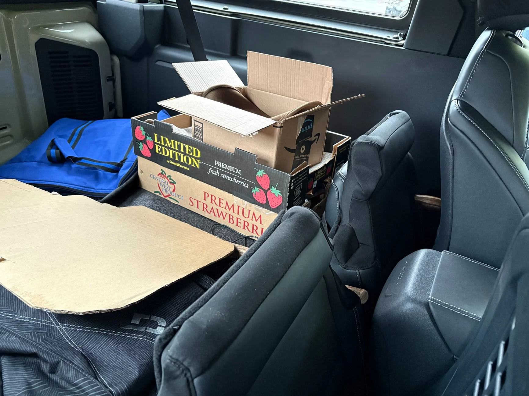

...and where does this fit in a 2-door rear seat?
:unsure:😆
