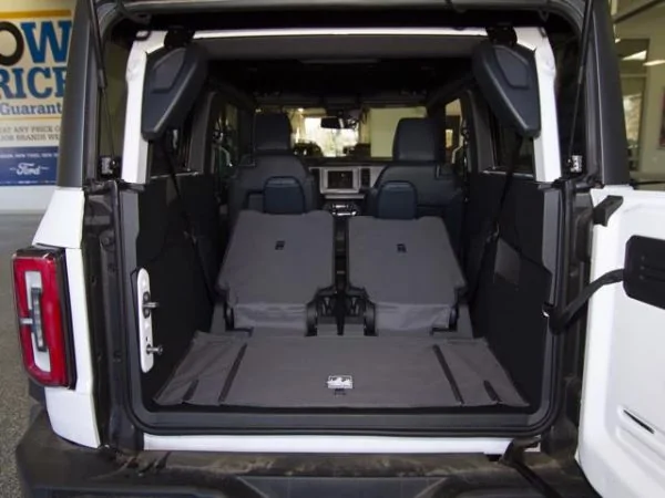

It drives me nuts that 3/4 of the people that criticize the 2 door's rear storage are clueless about how to properly fold down the rear seats.
Most do it just like a moar-door... pop the seat backs and flop them down.
If you do that... it looks like this:

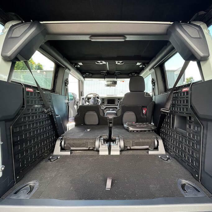

If you follow the right steps:
1. Lift rear seat bottoms forward.
2. Rotate rear seat bottoms to the backs of the front seats.
3. Pull release of rear seat back to fold the headrest 90°.
4. .. THEN.. fold the rear seat backs flat like the moar-doors.
Then it looks like this.
There is still a 4" step up to backs of the rear seats... but, most importantly... the seat backs are as flat as the rear cargo area.
With the new seat back protectors from @Mabett and a cargo floor protector, I don't see an advantage to removing the rear seats.
If you absolutely need it perfectly flat.. then pull the rear seats.
If you think you may ever possibly have a 3rd or 4th person in your Bronco, then giving up 4" and your 2 stowed seats to make your cargo floor even flatter.. then it makes no sense to me at all.
Ulimately, your decision is yours, but at least fold the seats down PROPERLY at least once before you make the decision to delete that rear seat. Just sayin-... ✌

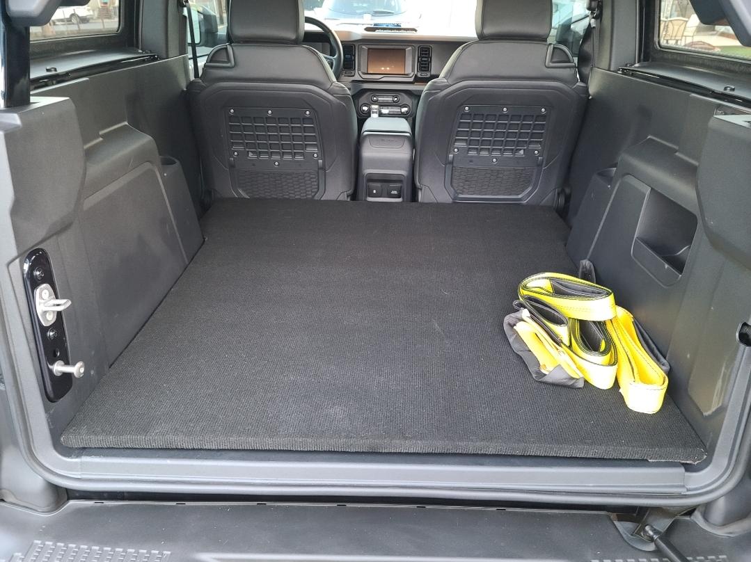

Wish someone sold a kit for this set up.
They do, Goose Gear, but it's gonna be about a grand. I'm in this for maybe $100-150.

This looks great! I’m going to do this on mine when it comes in. Does anyone have measurements of the cargo area like this? Wondering what I’d be able to fit back there with those rear seats gone.
Blaven
Jul 20, 2020
918
1,957
Pennsylvania
I made mine 51 inches in length from the center console and at the rear by the tailgate is 41.5 wide I believe. I posted more measurements in the 2 door thread. It's close to the last page.

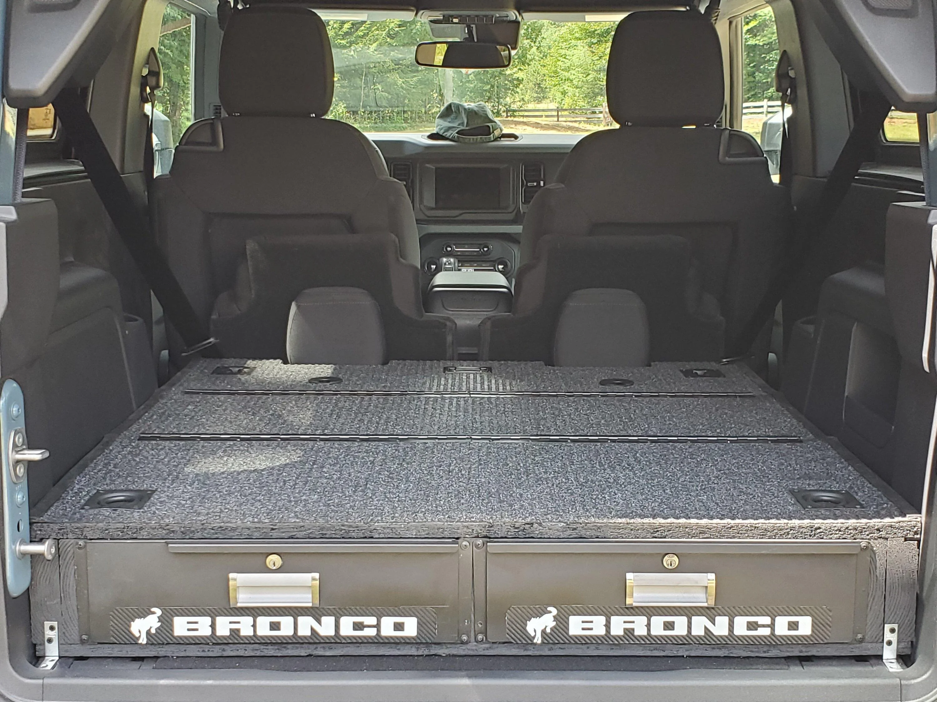

Nicely done. I wanted to keep the rear seats just in case so I came up with a storage option without removing the back seats. The panels fold back allowing the rear seats to be used. Also included tie down rings and cabinet locks which lock the panels down using the built in tie down rods built into the rear seats
