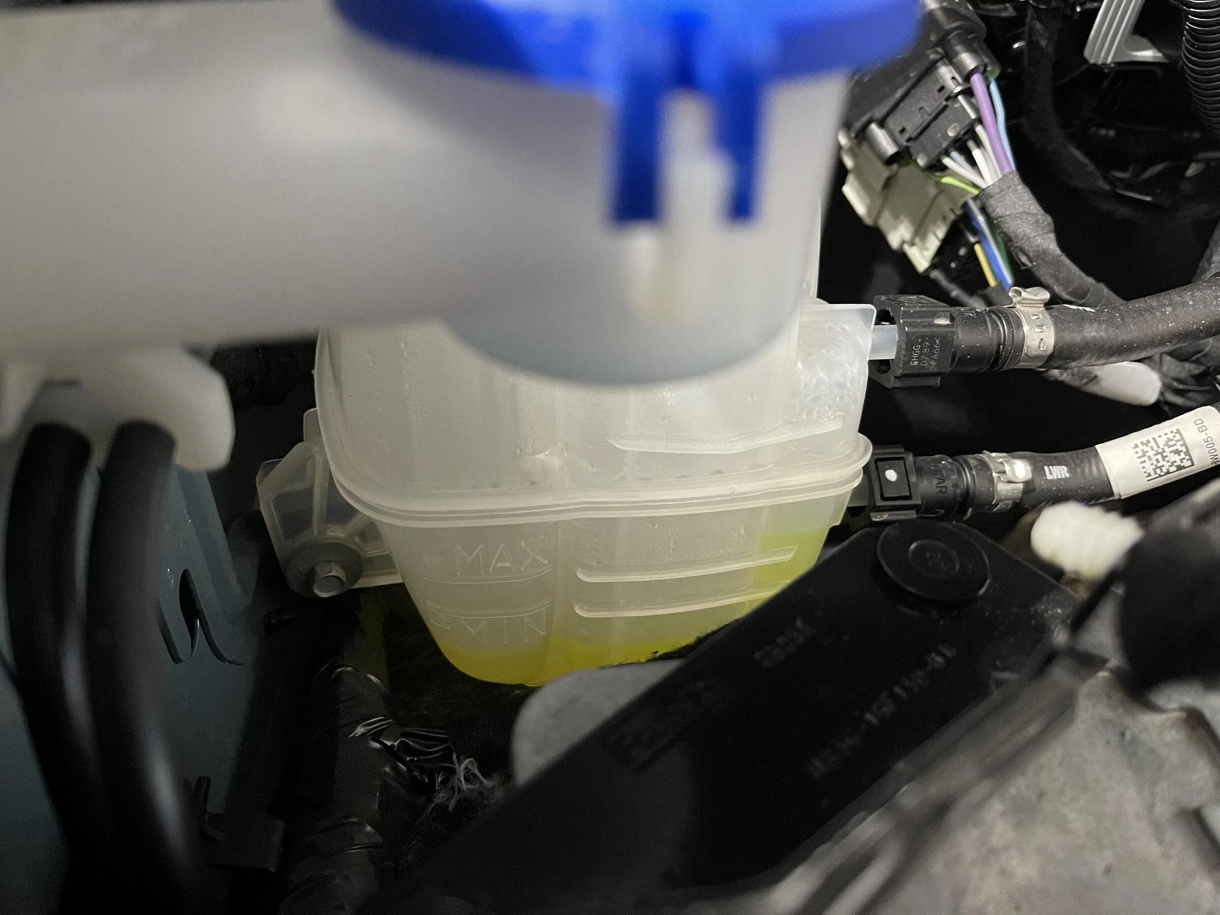

Just looked and my coolant is below the min level. I didn’t check it on delivery, but seems odd that they would give me less than the min.
Your dealer prob didn’t check it during pdi I checked mine the other day and it was still full to the max line
Monitor carefully, when one has a head crack, warped head of bad head gasket, coolant goes into the combustion chamber and out the tailpipe. You're the second person to post a level like that, unless it was you that posted before.
It should have never left ford like that or your dealer I’d send those pics to your dealer and say wtf make sure your Coolent hose is out of the way of the pulley too mine was a,ready zip tied away from it not sure if ford or the dealer did it but glad they did it cause they are so close to the pulley it will slice the hose open
