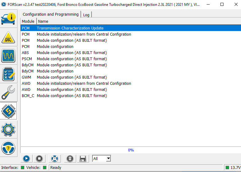

I’ve seen a person or two having the same issue I have, but no solution so far. When I go into the IPC section to disable the chimes, it keeps giving me the “service procedure interrupted” error. It worked fine on the Body BcS module and I could disable the double honk, but anything I try to do in IPC gives me the error. I’ve got the OBDLink EX that everyone else seems to use, I’ve downloaded and reinstalled Forscan and the updated drivers and firmware for the cable. Anyone have any thoughts?
I got it sorted out! I emailed Forscan and they sent me a Beta to install. I just got rid of Key in Ignition Chime...finally!
https://forscan.org/download/FORScanSetup2.3.47.test20220406.exe

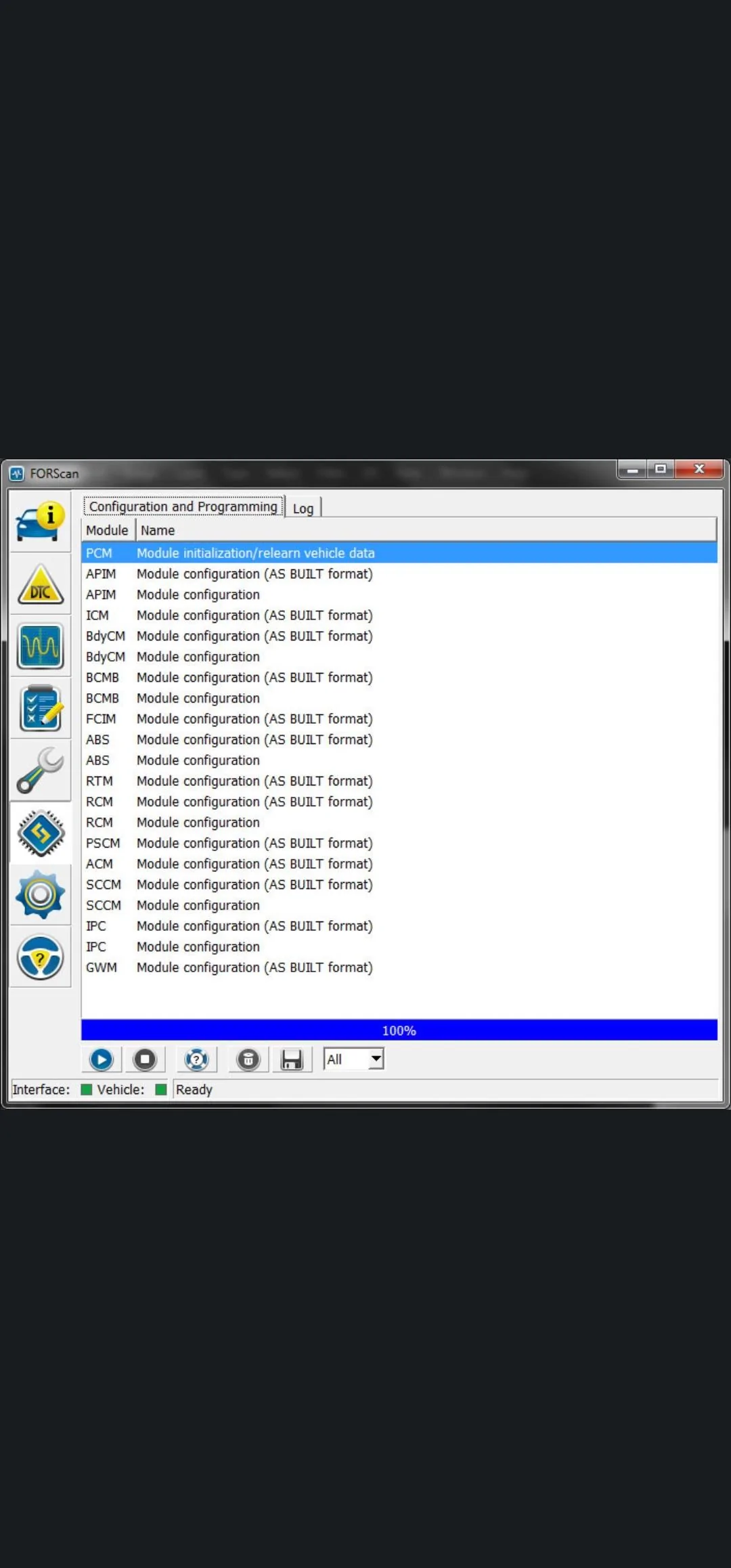

Try to relearn the PCM and TCM using forscan after you make tire change size. You have to do this sometimes. Possibly ABS as well if it's available start with the first 2 I said

I did the relearn as indicated in the Tire Change thread. Those cleared the DCTs in PCM. I have a feeling these were around before messing with the tire circumference. I will go back out in a few and see if I can clear them. I started a new profile.
I got my speedometer to be within 0.5-1 MPH of Waze and another GPS app on my phone. I ended up adjusting it down to 2620mm for 285/75R17.
