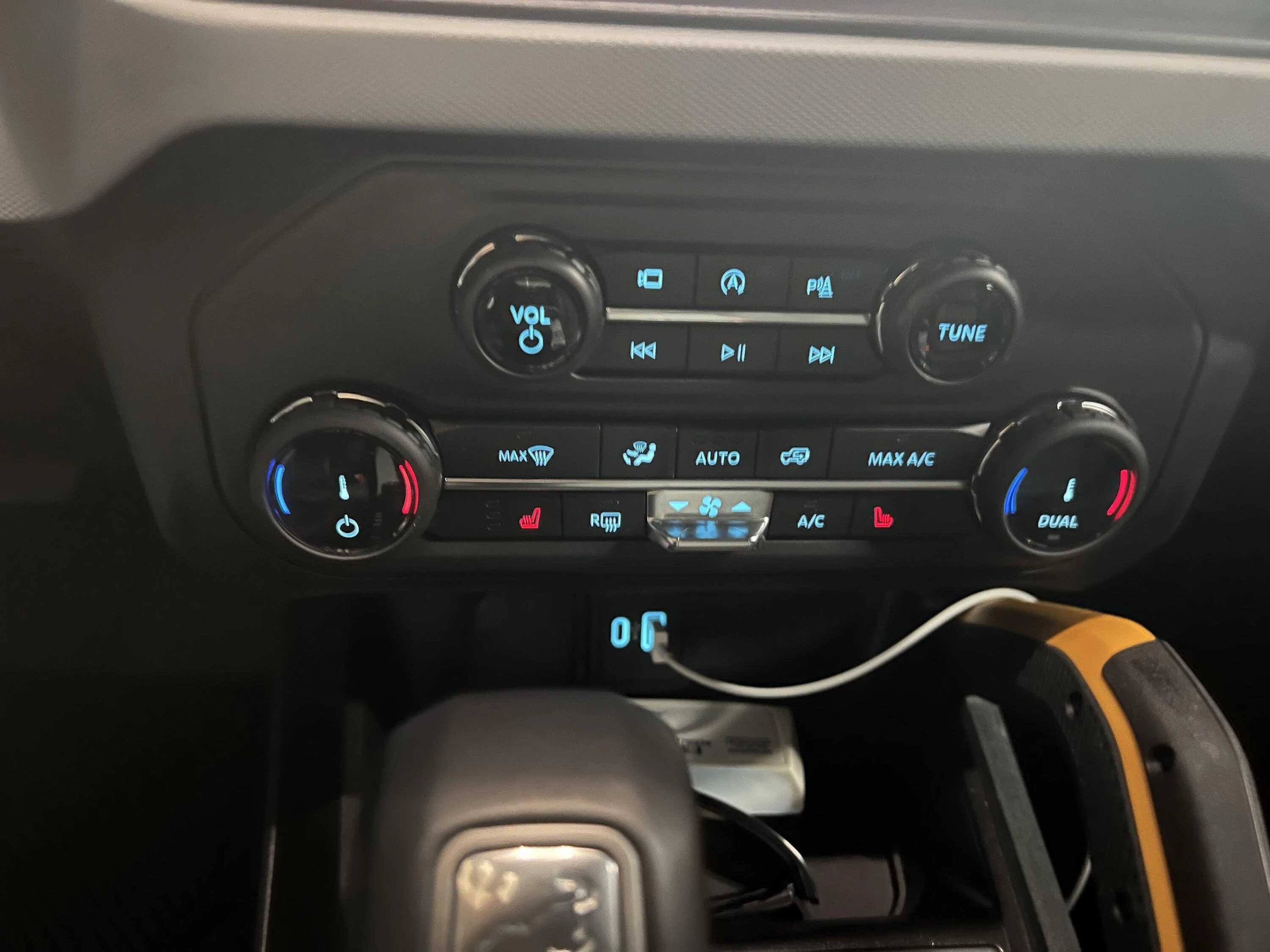

I have a 2022 Badlands with mid package. Was reading through some other threads and wanted to try adding the 2021 display dials.
Anyways, part just showed up and I can confirm M2DZ-19980-C is setup for heated seats, heated rear window (hard-top prep package), and dual zone climate control.
Will post more pics when I get the dash apart and the new piece installed...

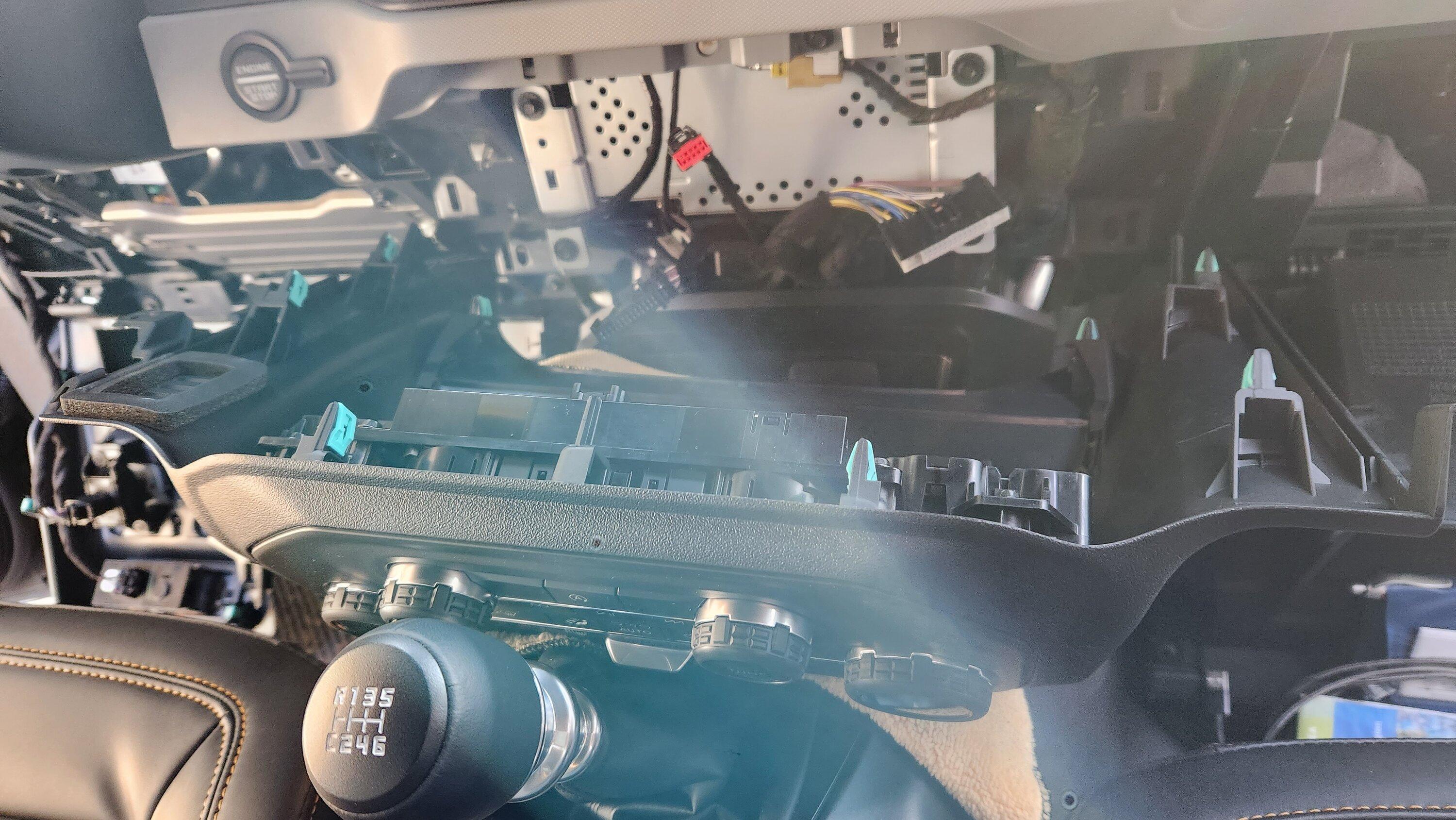

Video above is good to get the console out. Then three clips and some care to remove from the car fully.

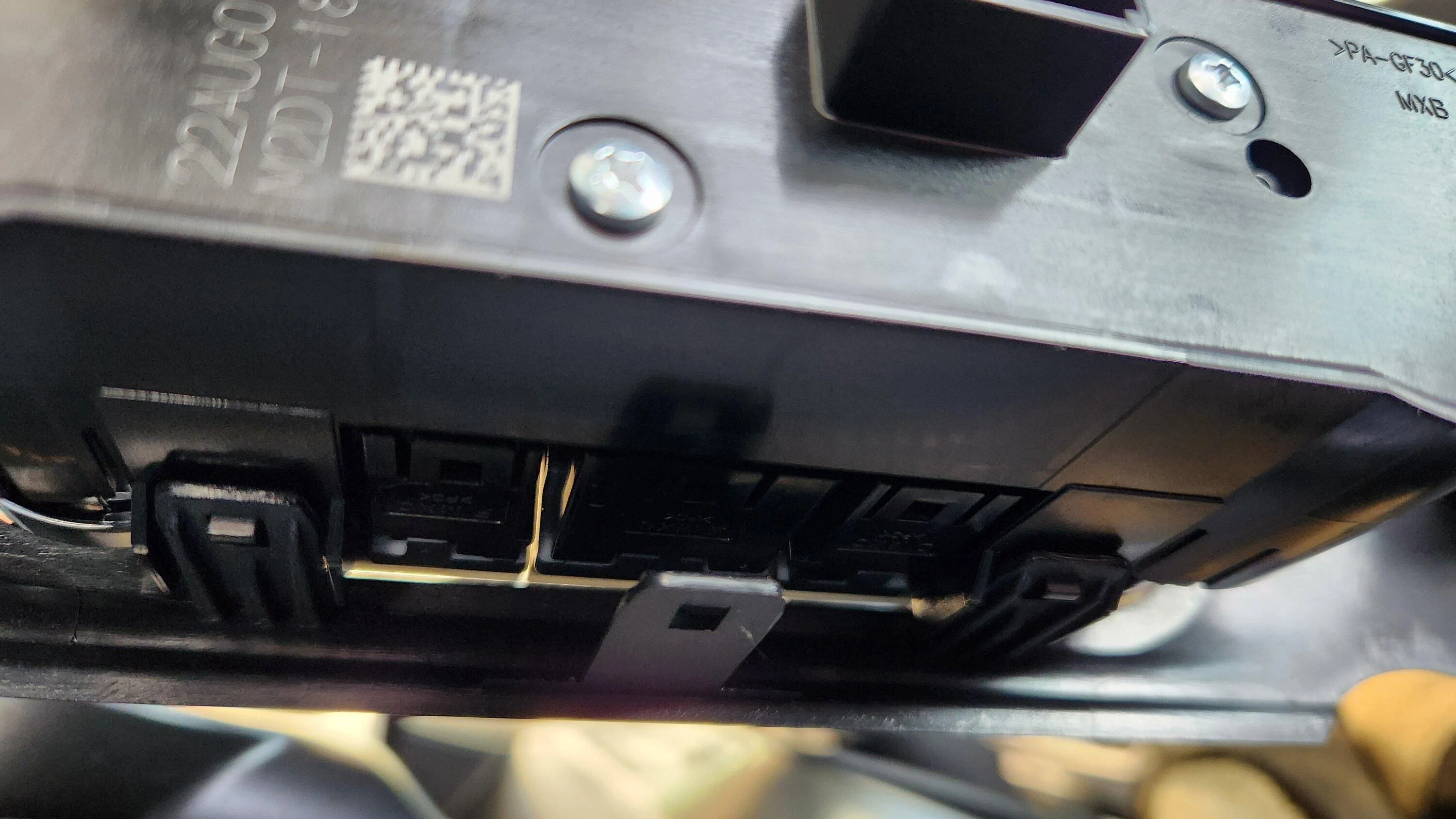

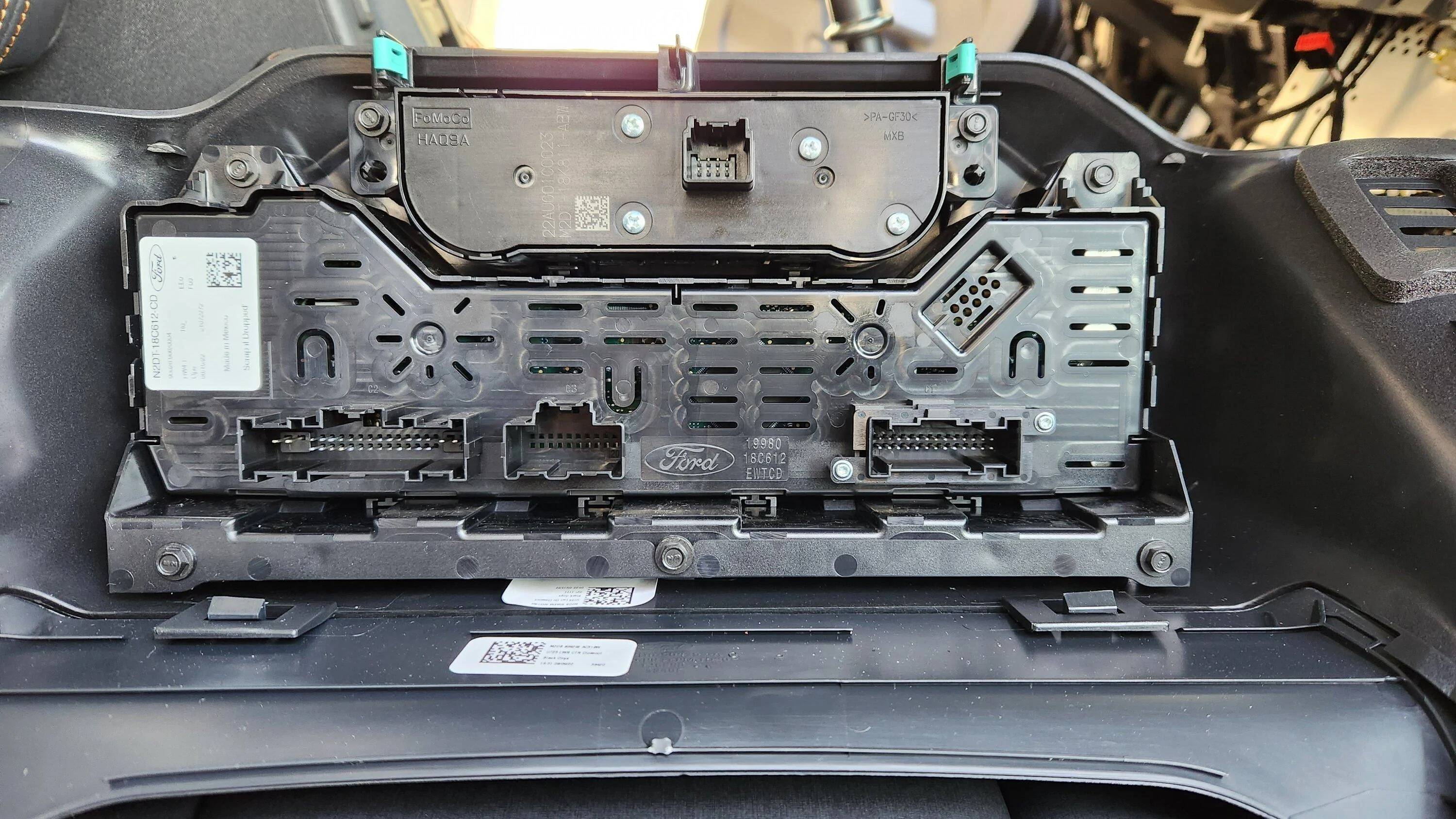

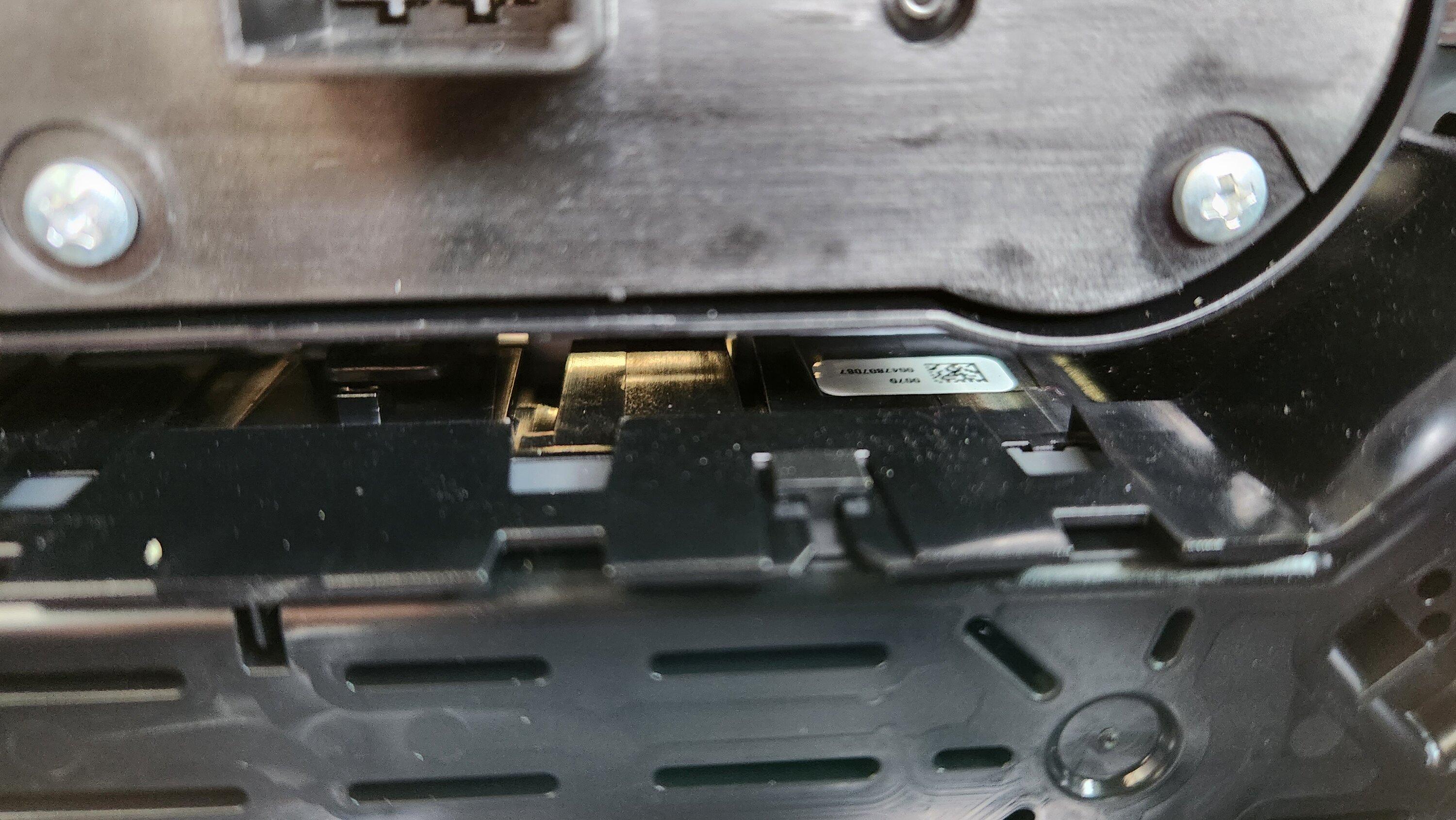

After that, there are 5 6mm bolts holding the unit into the housing and a clip at the top. Panel popper to release the clip.

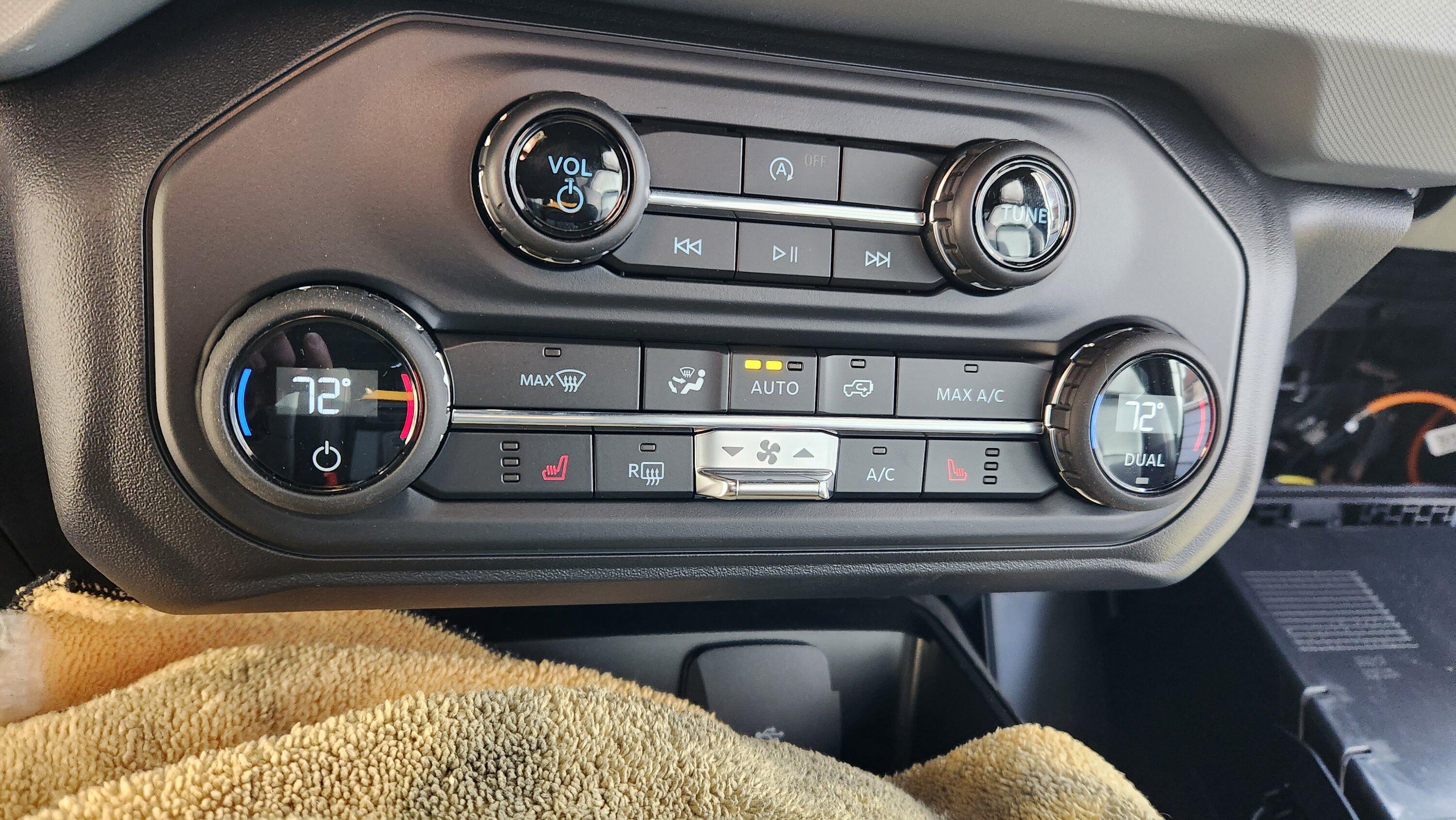

Reverse to install the new unit. Turn the car on and bingo! No coding change.
