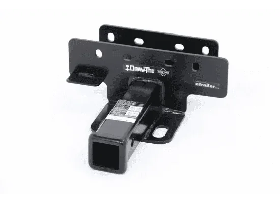

UPDATE: etrailer has this one which has an extension to clear spare tire Drawtite brand $123
Ford Bronco UPDATE new Drawtite extended hitch now available.  Aftermarket trailer hitch, Curt CRT-13493, arrived. No drilling required 1631586090738

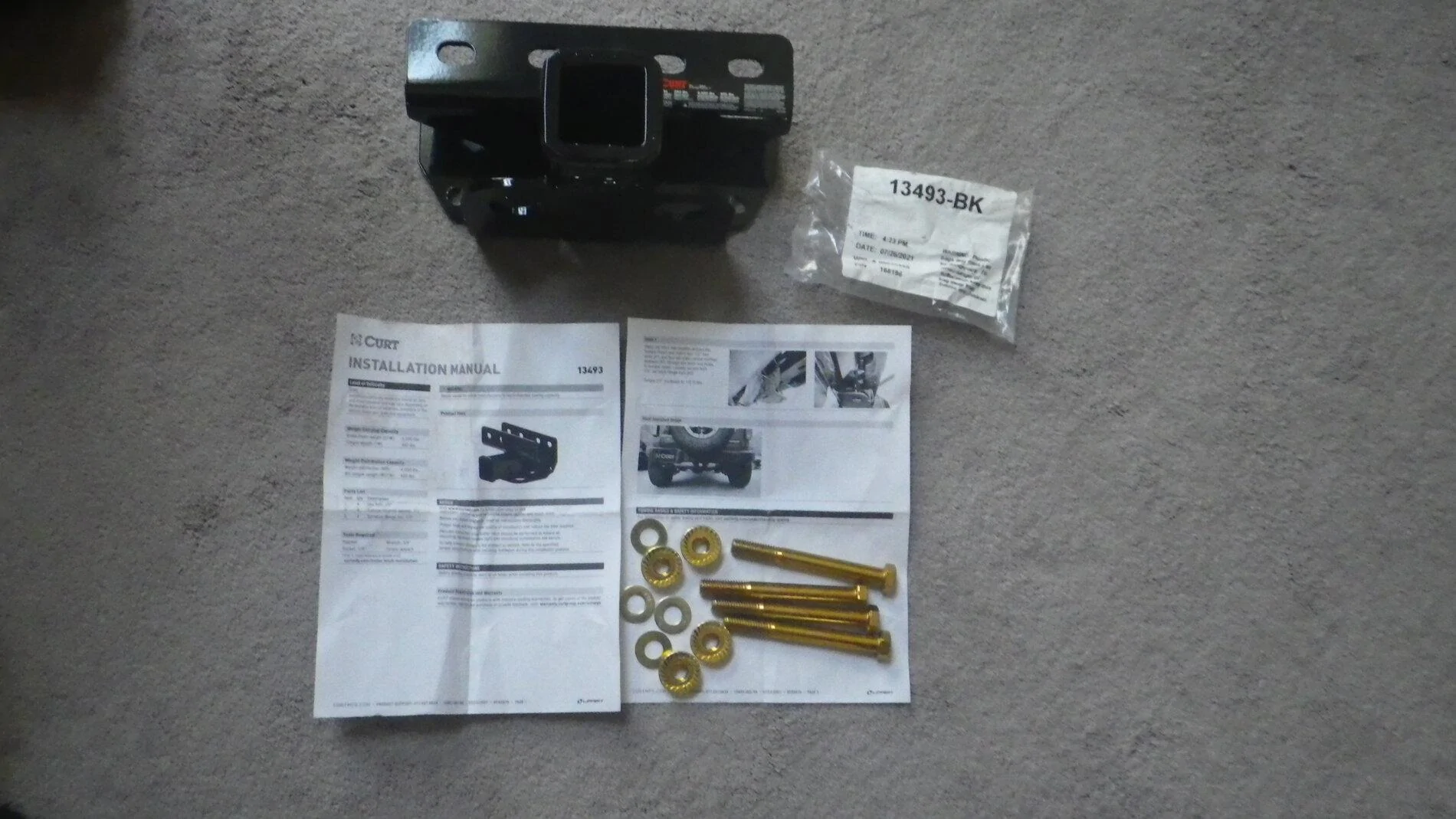

I'm beginning my "If Ford won't build it I will" Bronco build
I received my after market hitch today, Curt 13493, 350/3500 lb, same design, layout and capacity as Ford Factory hitch. This hitch will be great for those wanting to carry a cargo/bike hauler, add a recovery point or tow a light trailer. It's for those who didn't order the factory set up because you couldn't with your trim, thought $600 was too much or forgot and will be happy with Ford's 3500# tow limit. I will add a 4 pin wiring set up when flip, Curt or etrailer figure it out.
How to get it:
Short version: I ordered from Real Truck (Curt #13493) for $111 last Thursday, shipped from Curt Friday arrived Colorado Monday.
Long Version: Stumbled upon it at etrailer for $245, which is as much as the Ford version. Checked Curt Website for $147, but sold out. Checked Curt's dealer network one at a time finally found Real Truck @$111. (Odd it shipped from Curt even though they showed sold out)
I've always liked Curt's quality and this is the same, good design, good welds, good paint. Side note this one will be easier to install than the Ford one because you don't have to remove the bumper facia, bolts are installed from the front (muffler side).

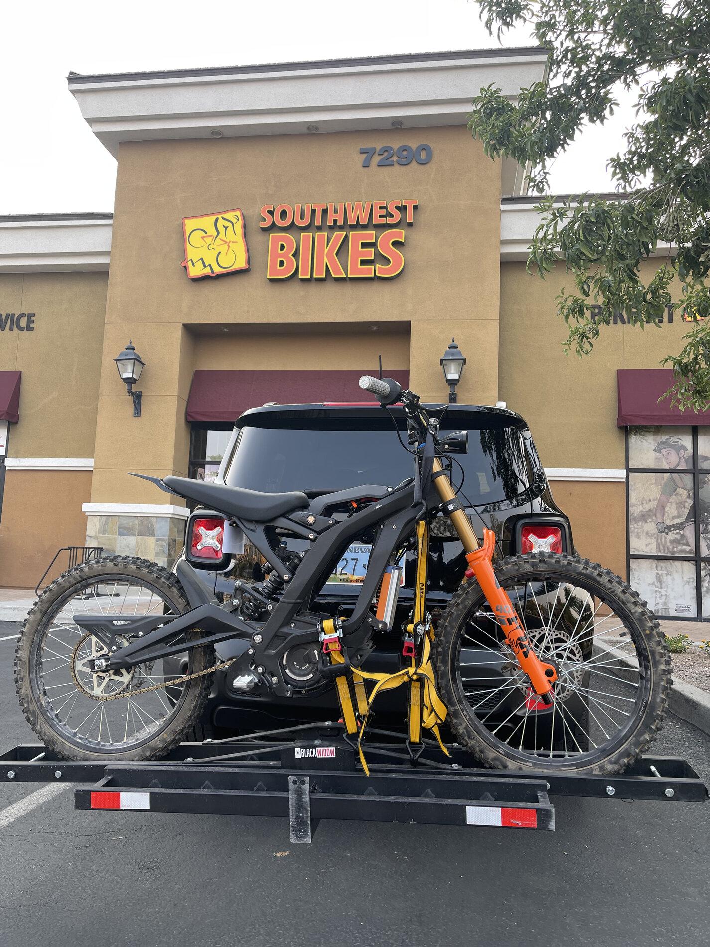

I just went ahead and ordered one even though mine is on dirt mountain. You did all the dirty work and I appreciate you. I wouldn't want to be caught looking for one later. You said they were sold out on the official website. Yah, I have an electric dirt bike and a few mopeds I like to haul around for leisure. I thought the cost of the official ford tow package was a bit much. This will do for now.

I did pull the installation instruction from Curt and it does look like an easier install then the factory one due to the smaller footprint.
https://assets.curtmfg.com/masterlibrary/13493/installsheet/13493_INS.pdf
