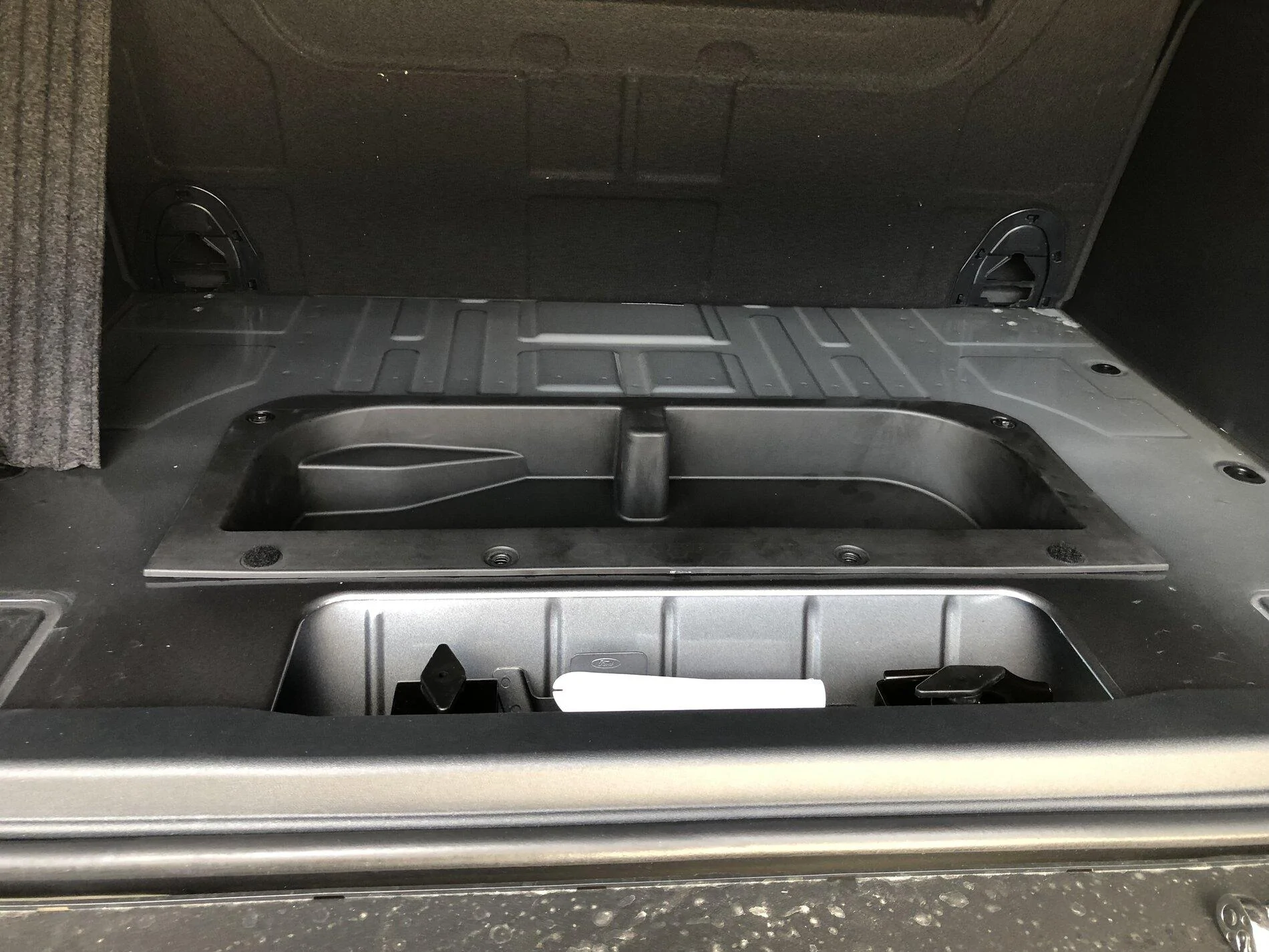

So I removed the built in floor liner by removing the four "lasso" hooks in the corners of the cargo area. Once that was lifted up and out of the way, the four bolts holding down the plastic insert could be removed. With the floor liner down, the two bolts toward the front of the car that hold the insert down are visible but difficult to get a wrench or socket on to. That's the first challenge for a would-be thief that might want to try to unbolt the plastic liner and remove it with the vault.
Ford Bronco Cargo Safe (Locking Storage) by Console Vault - installation and review on 2021 Bronco 1 liner
Liner door lifted up:
Ford Bronco Cargo Safe (Locking Storage) by Console Vault - installation and review on 2021 Bronco 2 lineropen
Liner lifted up:
Ford Bronco Cargo Safe (Locking Storage) by Console Vault - installation and review on 2021 Bronco 6 lineroff

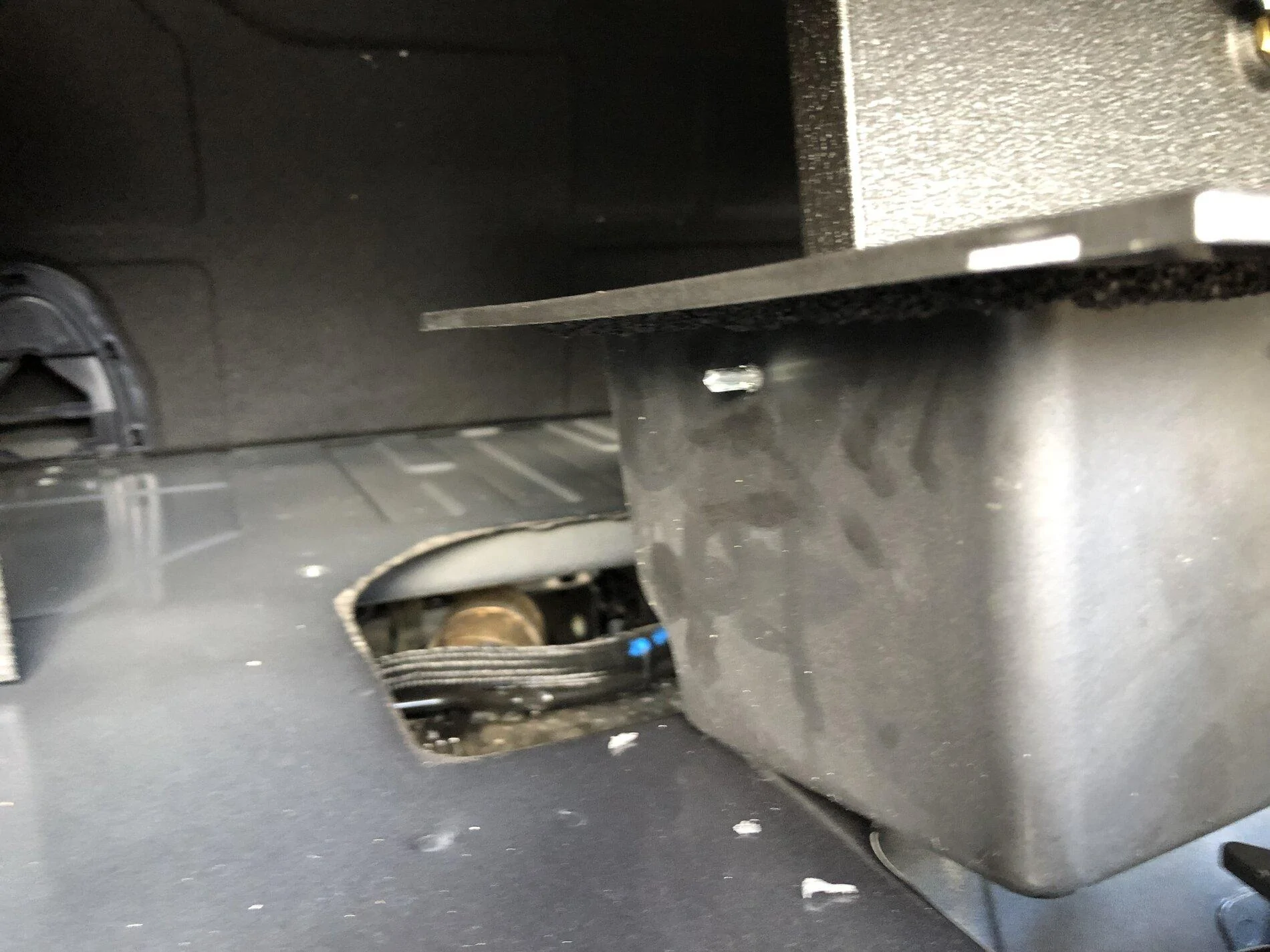

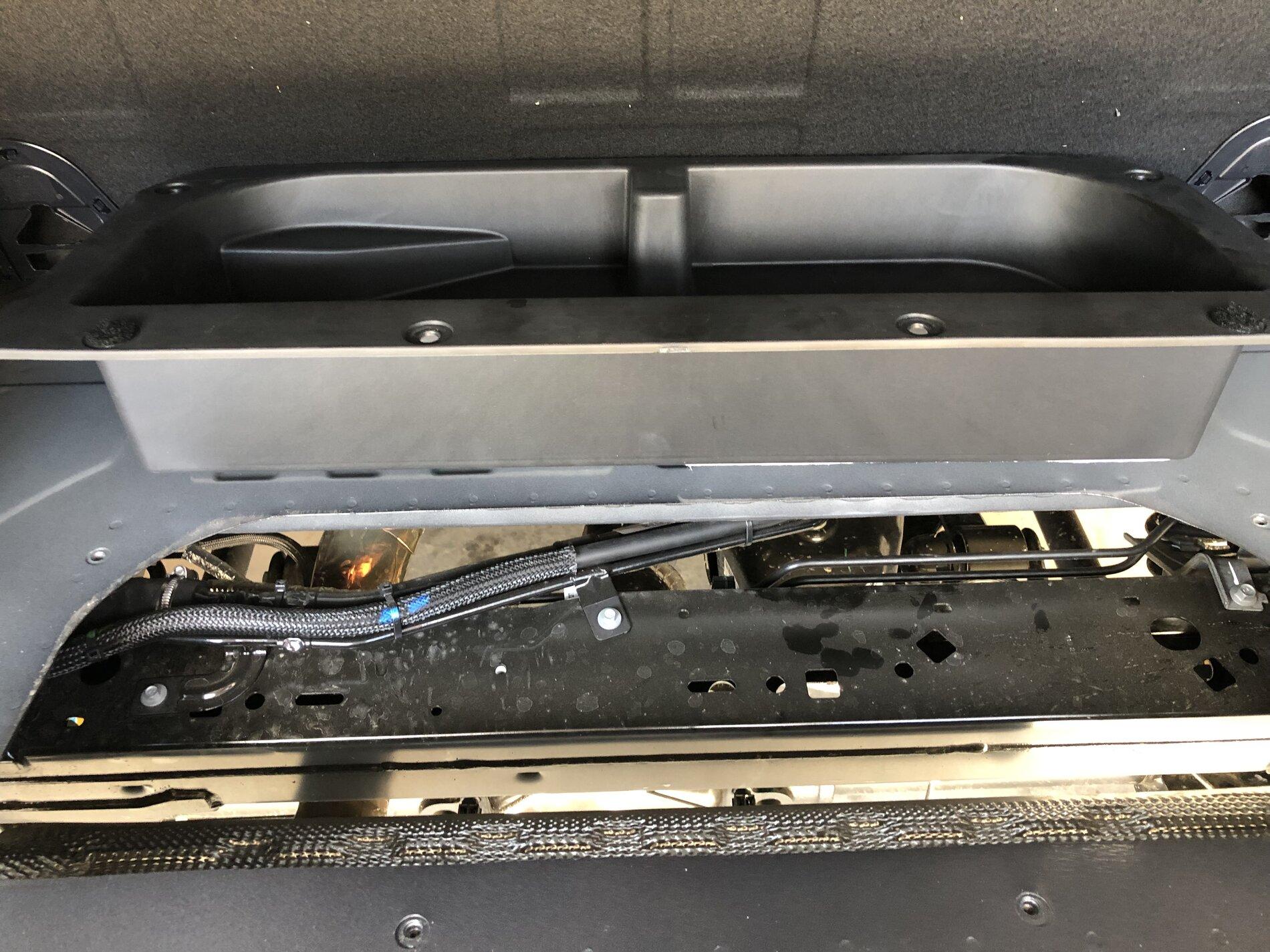

After removing the plastic insert, I looked for any nearby metal that I may be able to tap into with longer screws but nothing looked usable or easy. Then I realized that they key to this method of securing the vault is that the screws are long enough to go under the metal cargo floor in every direction.
Ford Bronco Cargo Safe (Locking Storage) by Console Vault - installation and review on 2021 Bronco 7 insert out

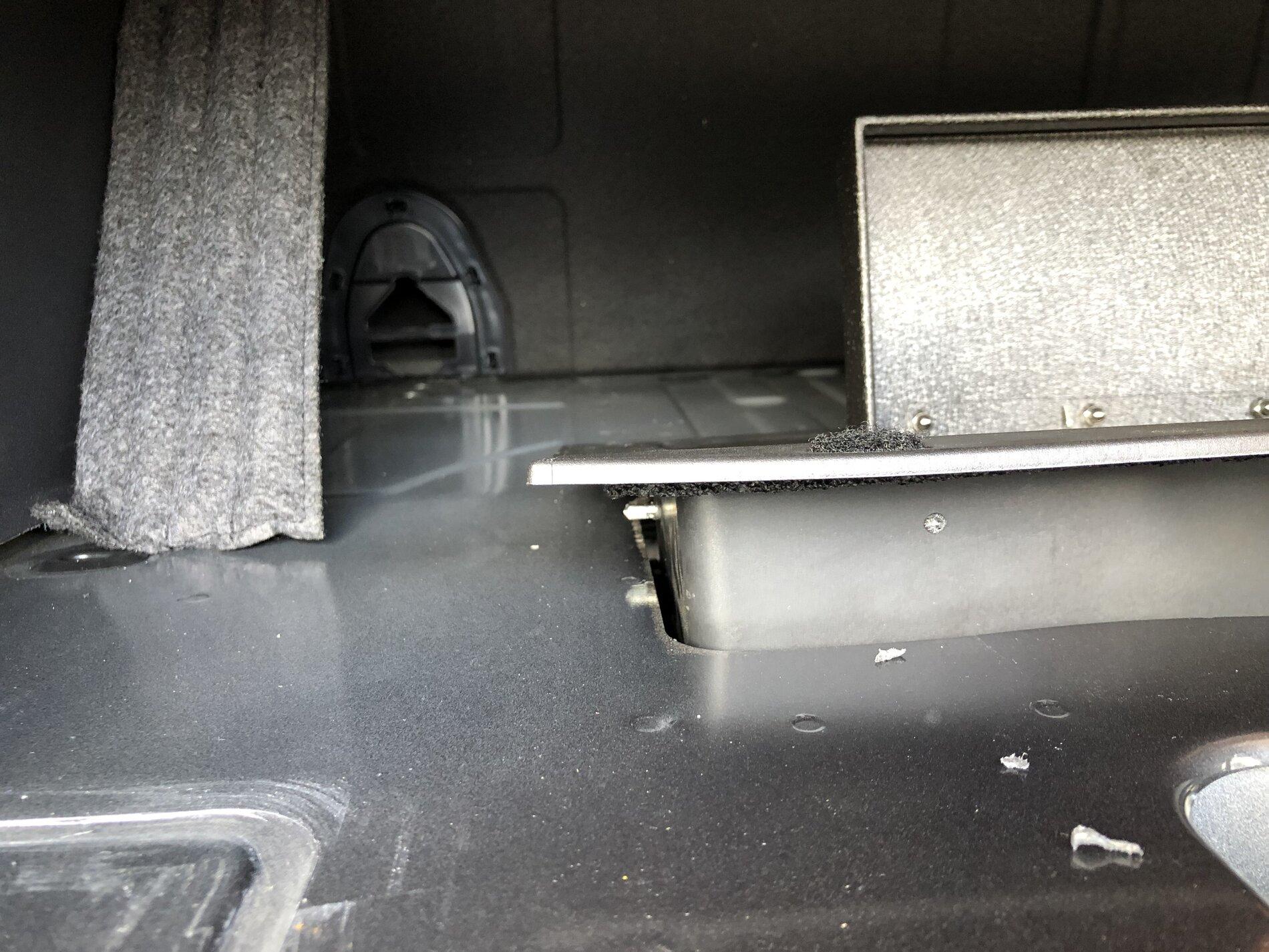

This picture is after placing the vault in the plastic insert and screwing in one screw. I wanted to see how far they stick out.
Ford Bronco Cargo Safe (Locking Storage) by Console Vault - installation and review on 2021 Bronco 8 screw showing
Ford Bronco Cargo Safe (Locking Storage) by Console Vault - installation and review on 2021 Bronco 9 screw over metal
The vault walls have thick, threaded screw holes. So the screws are securely connected to the vault walls. The connection to the plastic insert is mostly cosmetic because the way this thing really stays put is by having the screws extend below the metal floor.

If someone wanted to remove the vault, I hate to think about the damage they would do to the floor and plastic insert but they would likely leave frustrated. I also got under the car to see if the screws could be cut off but I couldn't get a single glimpse of a screw. The vault sits right over the muffler, which is under a heat shield. There's just too much stuff in the way. Score another point for security!

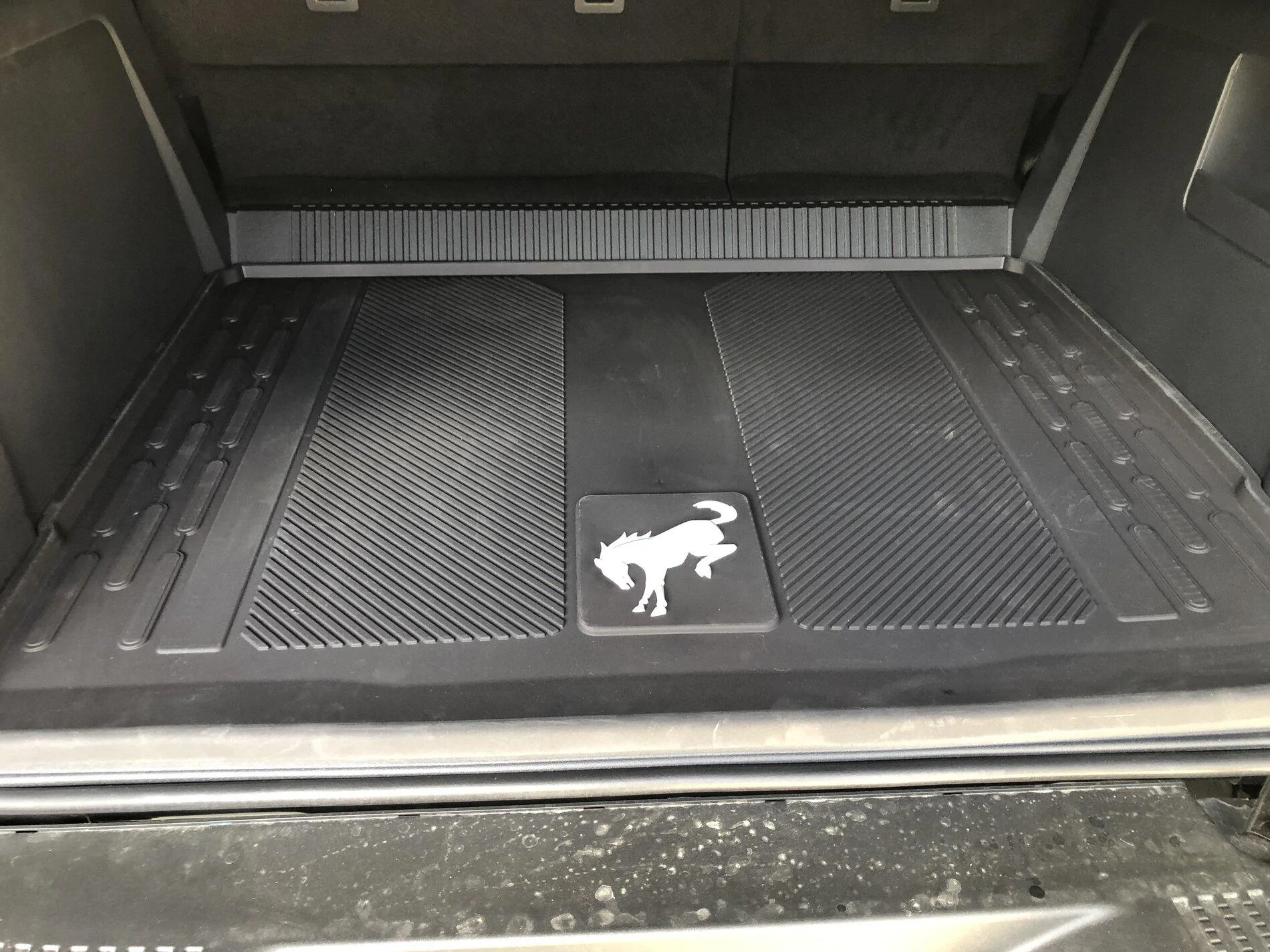

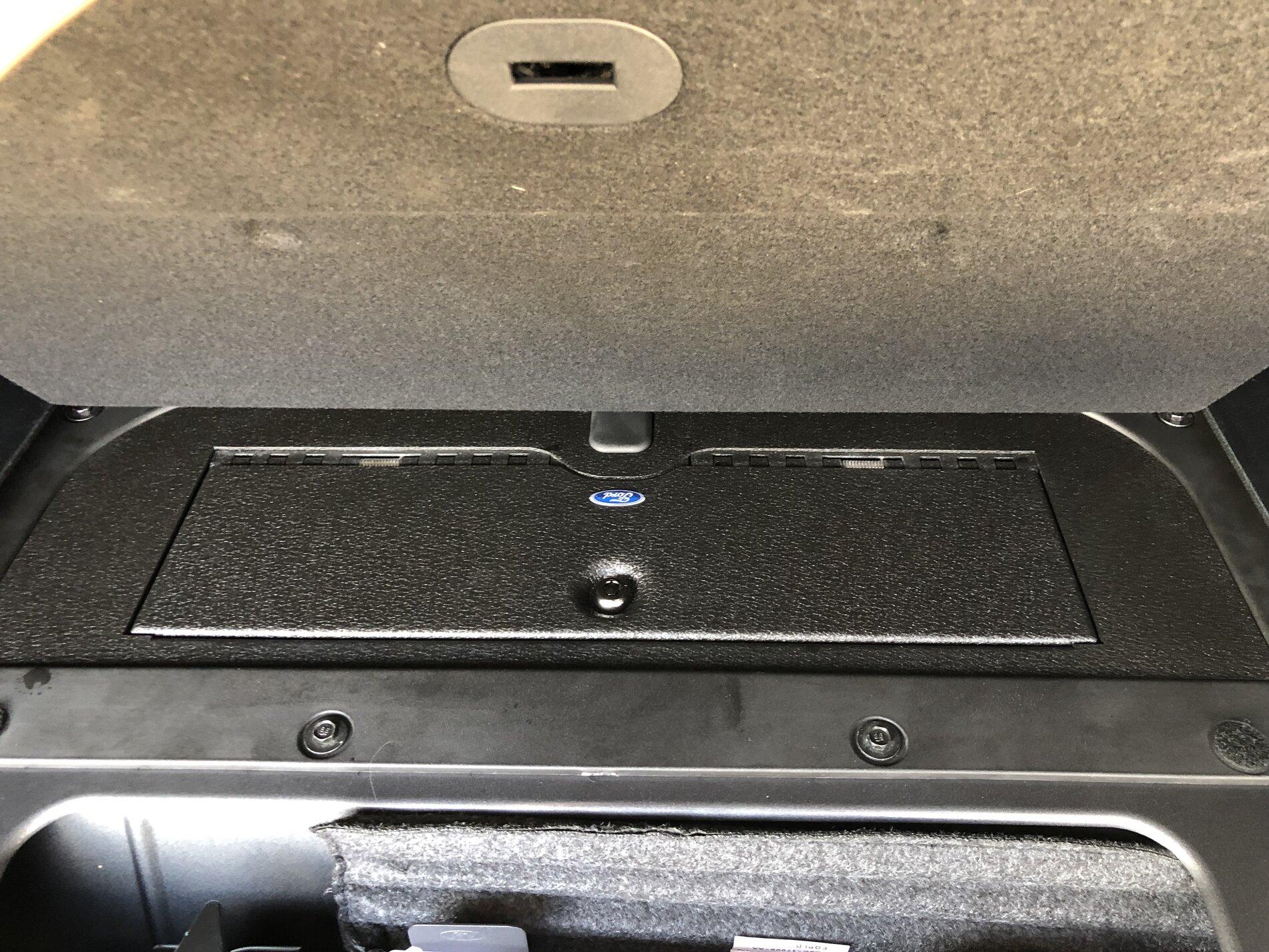

I'm pretty happy with it. It's solid and heavy. It comes with two keys. A standard installation could NOT be easier.
Ford Bronco Cargo Safe (Locking Storage) by Console Vault - installation and review on 2021 Bronco 10 installed
Ford Bronco Cargo Safe (Locking Storage) by Console Vault - installation and review on 2021 Bronco 11 cargo mat

Is there anything underneath the tray that takes the space of that strange hump? Just wondering if you could get a little more space in there.
I didn't think about that but that's a good question. I don't think there is anything there. Maybe it adds some stability? I'm not sure why it's there.
