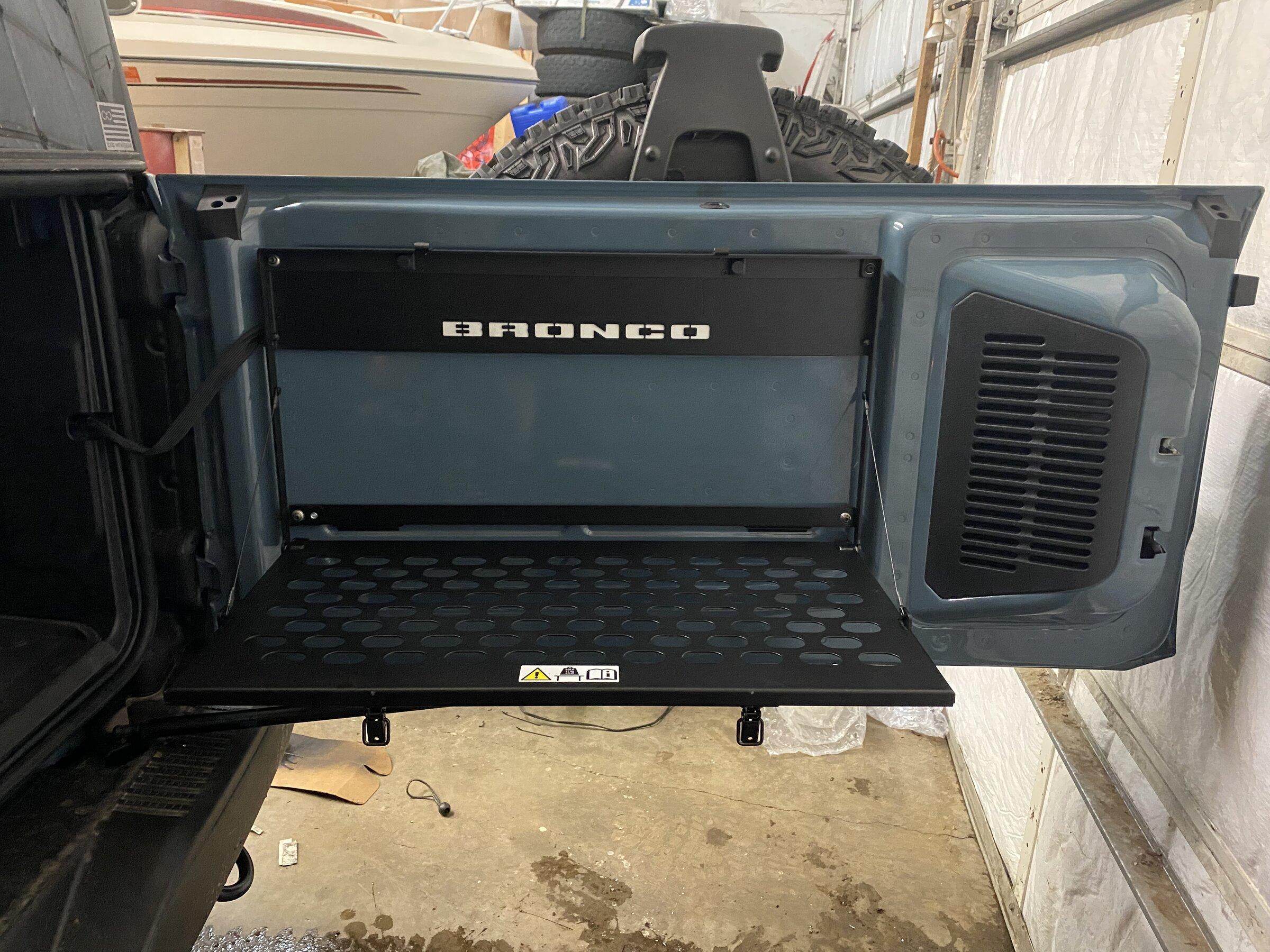

The tailgate table is easy install, the instructions sheet sucks. Do like another user did and put the rubber strips on the bottom in the bottom slots and on the top on the top slots. I added glow in the dark white vinyl behind my Bronco Cutout looks pretty cool I think.
