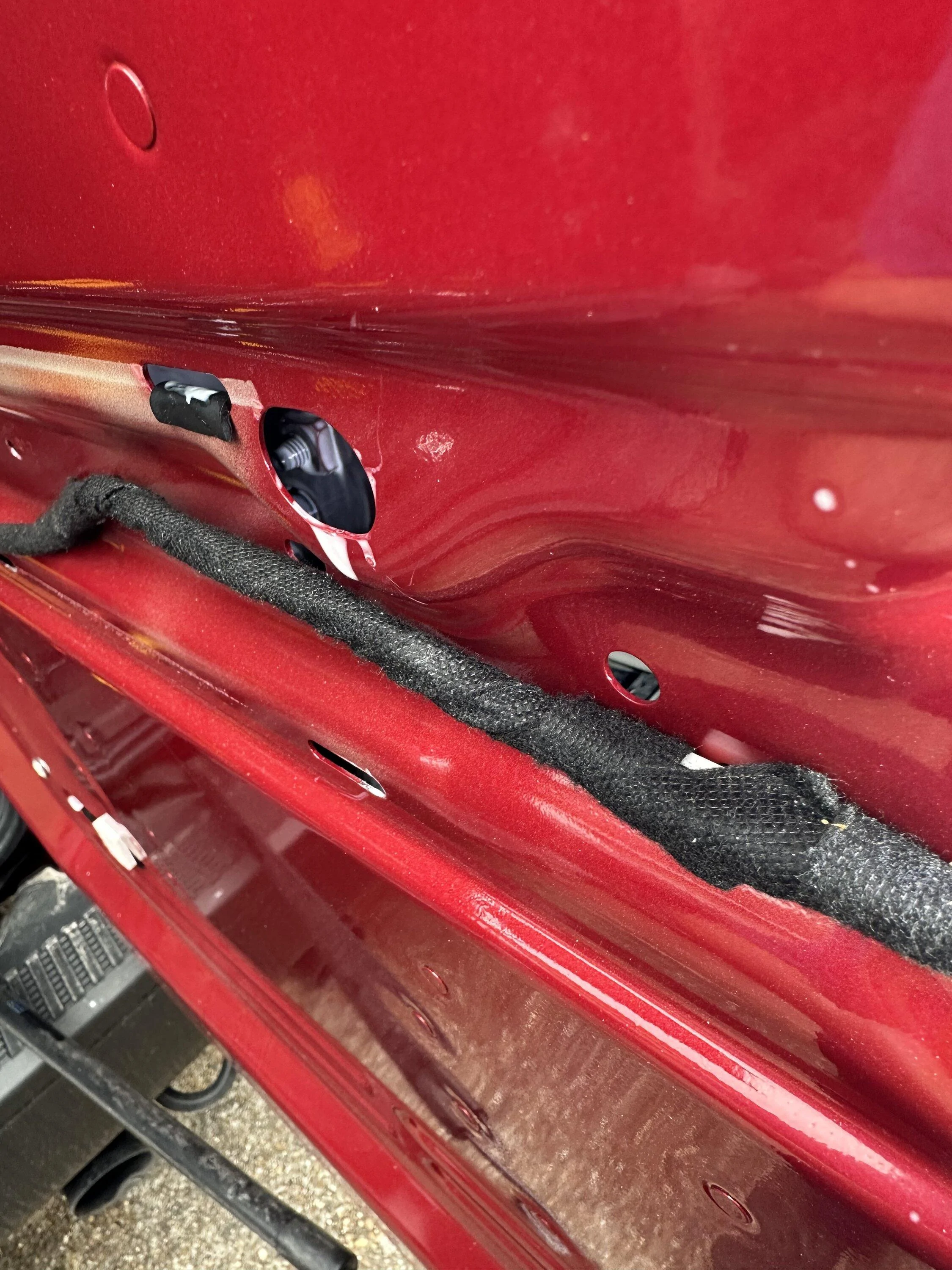

I think you’re talking about this wire bundle. Which in case yes I think you would need to take it off. There is a small section exposed before it goes behind the table, not sure what your wiring and if that worked for you I assume you wouldn’t be looking into taking the table off lol.

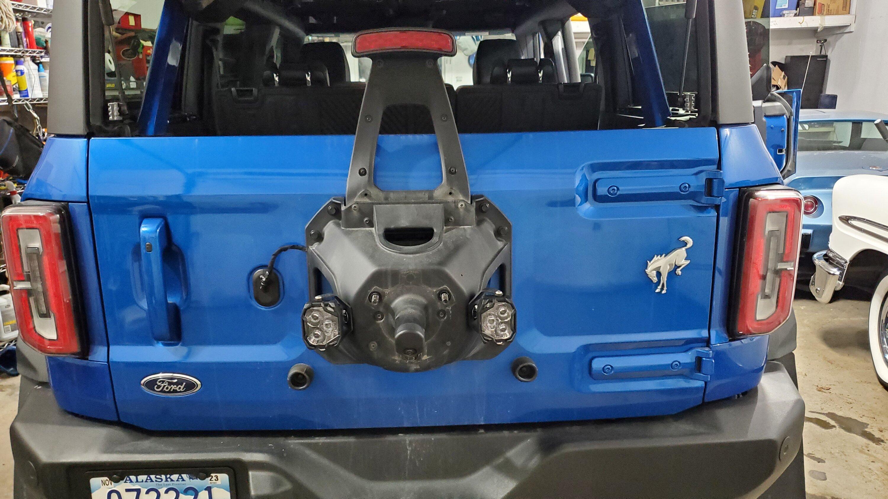

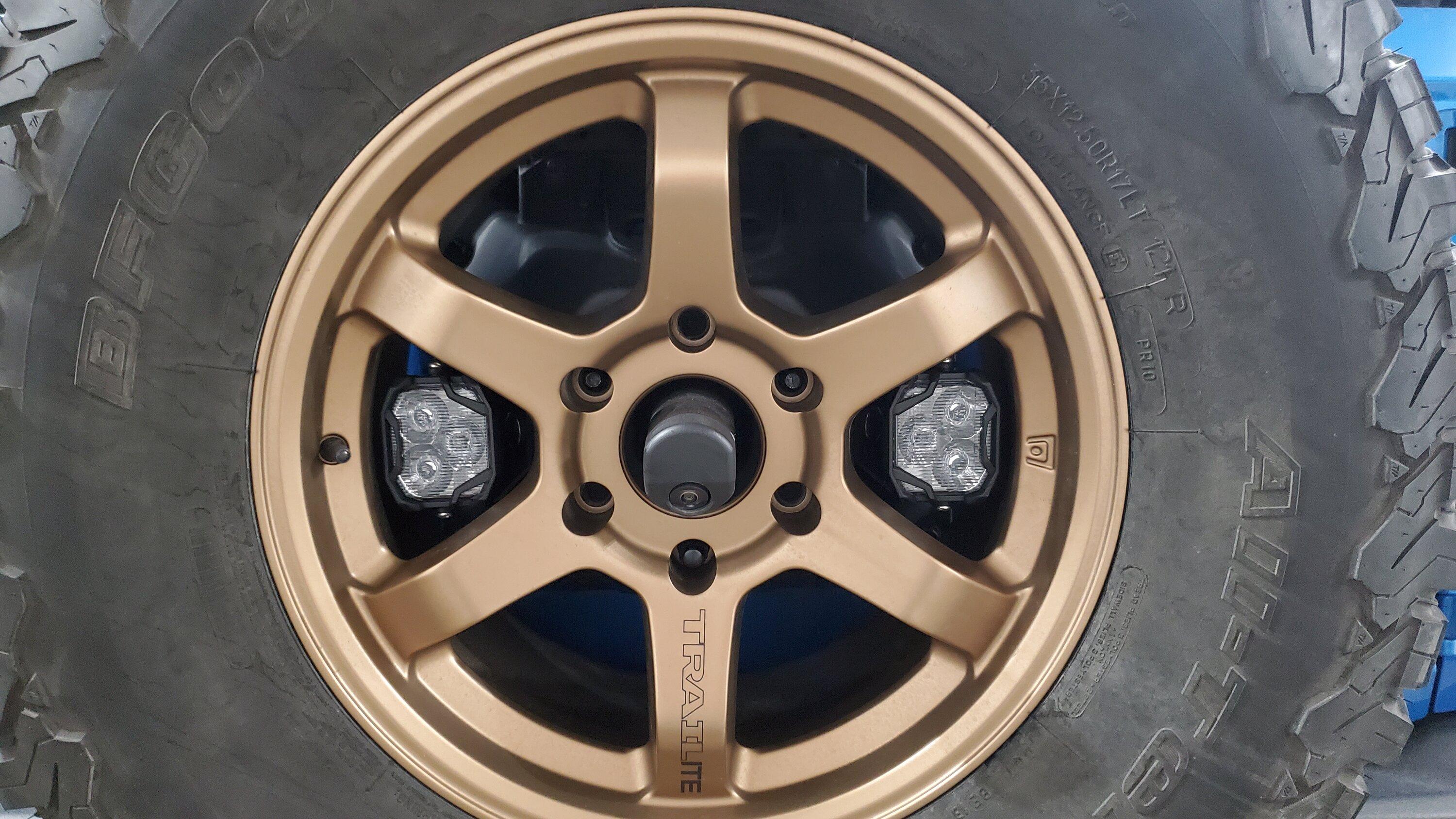

I've got a pair of LED light pods on order, which will be mounted "inside" the spare tire, similar to the example picture below (this is not my Bronco).
I feel like that stupid table is going to be the pain in the butt on this *sigh*
Ah some lights. Why do you need access to the wire bundle behind the table? You will be running new wires to the aux pass through behind the cargo panel, should be pretty easy to run those without taking the table off. You can pop that big platic vent panel off and get access to the grommet.

So that bundle of wires is just wrapped in cloth tape. (pretty poorly as you can see in my pic) I would fish the new wires through the grommet, wrap them in cloth tape, and fish them behind the table along the same route, with a zip tie connected to the factory bundle at both ends. Off the top of my head this would be very simple. Im not next to my Bronco to verify, but I think you can run these cleanly without removing the table.
I just went out to my Bronco and looked. I think you might be onto something - I can't imagine the LED pod wires are overly thick. I think I could pop off the plastic trim cover on the right side of the door (near the handle), push it through (thankfully there's the molle panel and you can fit fingers or needle nose pliers or something through to move it along), and then pop out the other side.
Great idea - Thank you!
