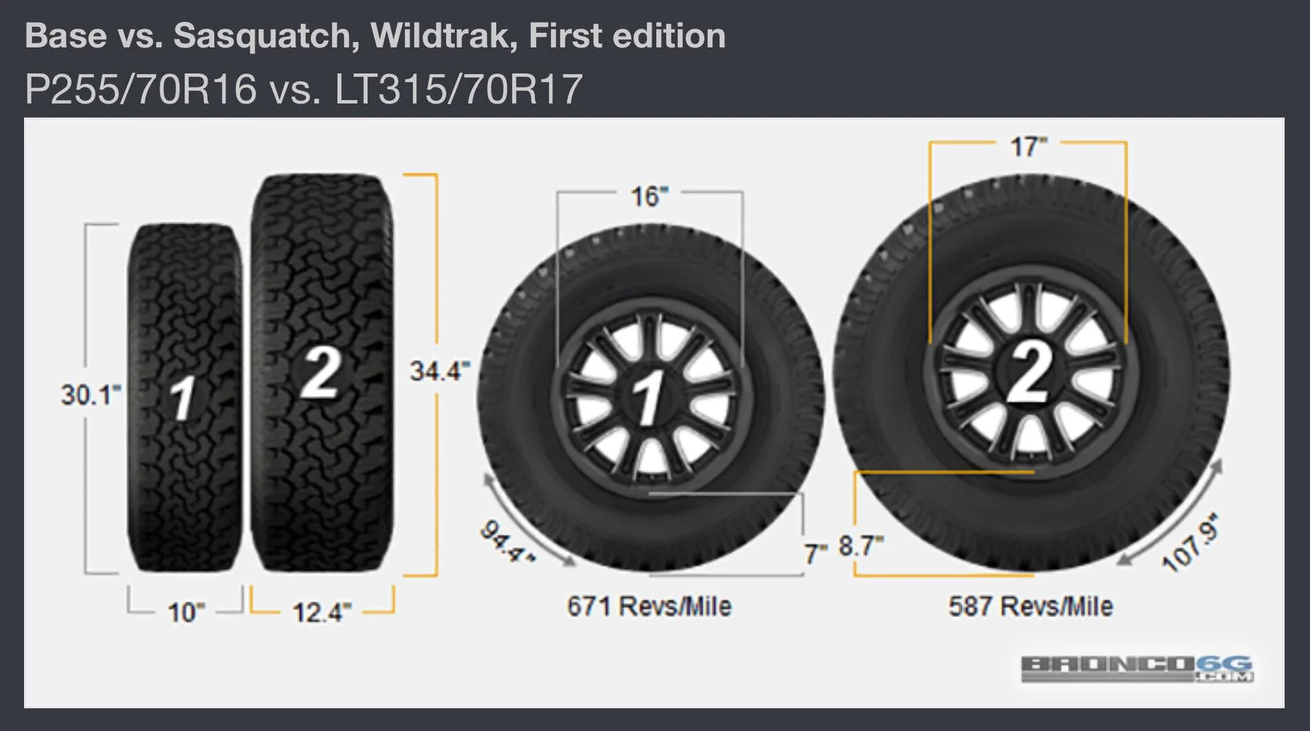

My tires are 35/12.5R17 I got 2791 for the circumference. Am I right guys?
I’m going from base tires.
Tarikh, most 35s aren’t exactly 35.0” in diameter. For example, Sasquatch tires (LT315/70 R17) are 34.4” diameter, so the circumference for that tire would be 2741 mm. Not a big difference between 2741 and 2791, but it’s still smaller. So be sure to use your exact tire diameter, and not the nominal diameter marketed by the tire maker. Might as well be exact, if you can. 👍
Ford Bronco How to: Recalibrate Speedometer with Forscan for 2021 Bronco 2E71A43C-3914-4506-B1FD-E4302BFBE9FF
Source: 2021 Bronco Factory Tire Size & Wheel Size Comparisons (Circumference, Diameter, Height, Width, Bolt Pattern, Center Bore)
From my research in general, each Manufacturer could be a little different, but maybe not enough to matter.
