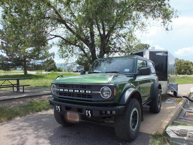

We just came back from the Moab Off-Roadeo. Because our dog travels with us, we didn't even consider flying out. We pulled our small camping trailer/toy hauler with the Bronco from northern Minnesota all the way to Moab and back -- about 2,800 miles total. Thought some folks here might be interested in our impressions of the Bronc's towing capability.
A little background: We have a 6x12 cargo trailer/camper conversion that we use as a fully featured camper, and as a toy hauler for our two dual-sport motorcycles.
Ford Bronco Our 2 Door Bronco's Towing Performance CamperWithBikes
Ford Bronco Our 2 Door Bronco's Towing Performance CamperInterior
In the past, we towed it with our 2005 Ford F250 SuperDuty. Obviously, no problems towing! Because of the truck's age, we decided to retire it from towing cross-country. Last year when we towed the trailer out to Steamboat Springs, CO, we used my husband's 2022 Tacoma. The Tacoma pulled it, but the lack of torque was a real disappointment! So we decided to try towing with the Bronco, and we really hoped that we'd be pleased with the results. My Bronc is a 2-door Black Diamond Sasquatch, so we didn't know how the shorter wheelbase would affect the towing.
We were really shocked at how well the Bronco pulled the trailer!! Absolutely great performance on high-speed Interstates and going up and over the Rocky Mountains! We had no trouble maintaining whatever speed we wanted, AND.....we got 12-13 MPG, which we were really pleased with! The Bronco just made the whole towing experience effortless! We had also installed an Andersen Weight Distribution/AntiSway hitch, and that thing really works! The tongue weight was perfect, and there was absolutely no sway or bounce. The Bronco was just amazing as a tow vehicle!

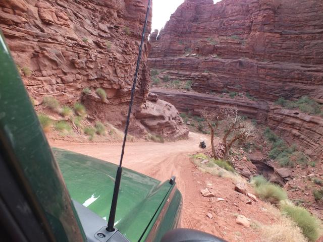

The Off-Roadeo at Moab was a blast!! We had a great time, and met some really nice people. The next day we took our Bronco out into the canyons and did some exploring of our own. Moab is a pretty cool place!

The trailer weight is probably about 2,500-2,700 pounds when loaded. The tongue weight is about 350. Our Bronco has the towing package, and we installed a brake controller.
The hitch we use is an Andersen Weight Distribution Hitch. It's amazing! The hitch is a different concept than most. Backing up and tight turns are not a problem, and it doesn't make any noise.

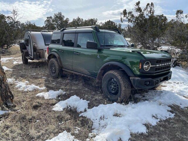

Thought that I'd reply since I have a '22 4 dr non-Sas BD w/2.3 and MT. My tear drop is a '23 Tag XL Boondock, weight of approx 1500 lbs + about 500 lbs of gear, tongue weight of approx 200. Ball mount is a Curt long shank w/3 balls, and it's very heavy duty and heavy (weighs about 50 lbs, I'd guess) and clears the spare tire allowing pretty sharp turns. Brake controller is a Curt wireless, and works flawlessly, although i do ziptie the connection from the 7 way to the controller, as I don't completely trust the little rubber tie. I have about 700 lbs in the Bronco while towing, and never dropped a gear while towing at 68-72 mph, even during steep hill ascents at 7500'+. MPG's dropped from 22.3 to about 18 while towing, so not too bad, and I hardly knew I was towing. Have about 2200 miles towing, 7500 overall. Hope this helps!

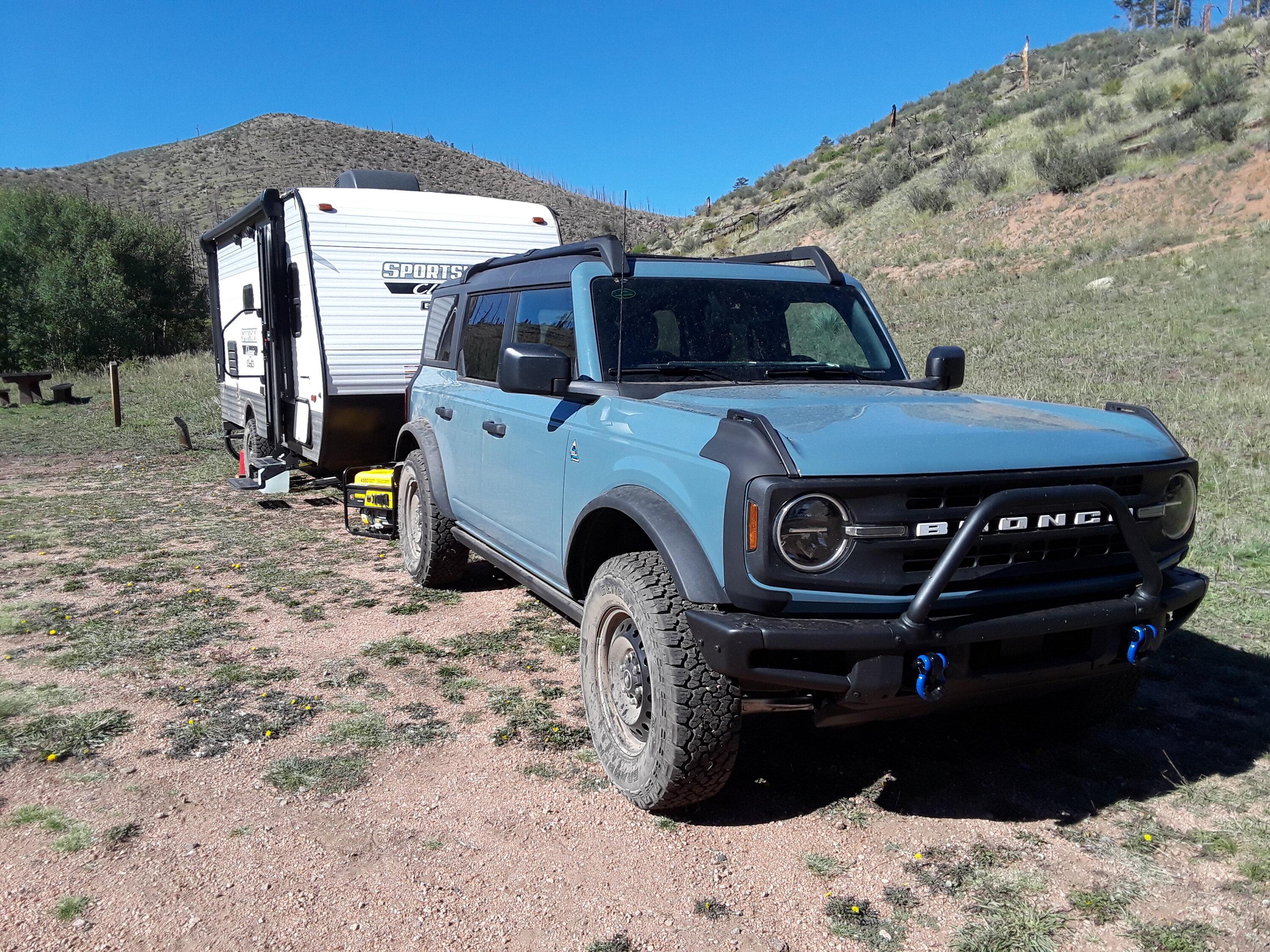

Thought I'd add to this one as I am totally impressed with the broncos abilities to handle the mtns of colorado with a trailer.
So I went out and bought a 21' KZ 2700lbs camper just before my 22' 4dr Black diamond with a 2.7ltr, w/tow package arrived. It handles Colorado's mtns with ease. I've been up a couple dirt hills that should have been a concern but it handled with no problems. The switch backs out by boulder were effortless. And I just took her to the off rodeo in texas a few months ago and while towing long distance was a little taxing on me the bronco handled it without problem. I get 11 to 12 mpg @70mph here in colorado down to 8mpg in texas( I think it's the altitude.)
