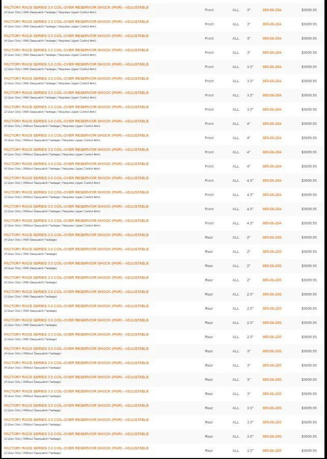

i was going to ask if anyone done there fox 3.0 yet but it looks like fox just add it to there site . Would love to see if worth the upgrade form 2.5 or form the kings.
Yea, surprised to see them release that shock line only a few months after the 2.5 shocks. The 3.0 IBP shocks sure do have a lot going on, no doubt, just a tough price tag to compare to a 2.5 that will do excellent for 99% of Bronco owners.
will that true but it's really only 2,600 difference between the shock before taxes/shipping is it really worth an extra 3k? would not mind saving extra 3k for way better performance but if it's just ok then not worth the extra 3k.
A better question will be if Fox 2.5 with a tune will be better out of the box than the Fox 3.0 with the factory tune?
Thats a pretty big price jump with my wallet, but I cannot say for sure without us getting a set to test out and experiencing them. Fox IBPs are really a totally different animal and tuning can be extremely time consuming and expensive (if needed). We tune a lot of 3.0 IBPs for Ultra4 4800 buggys that have the same technology and it's pretty wild what we have to do sometimes to get them to perform. Very different vehicles, but same shock technology.
