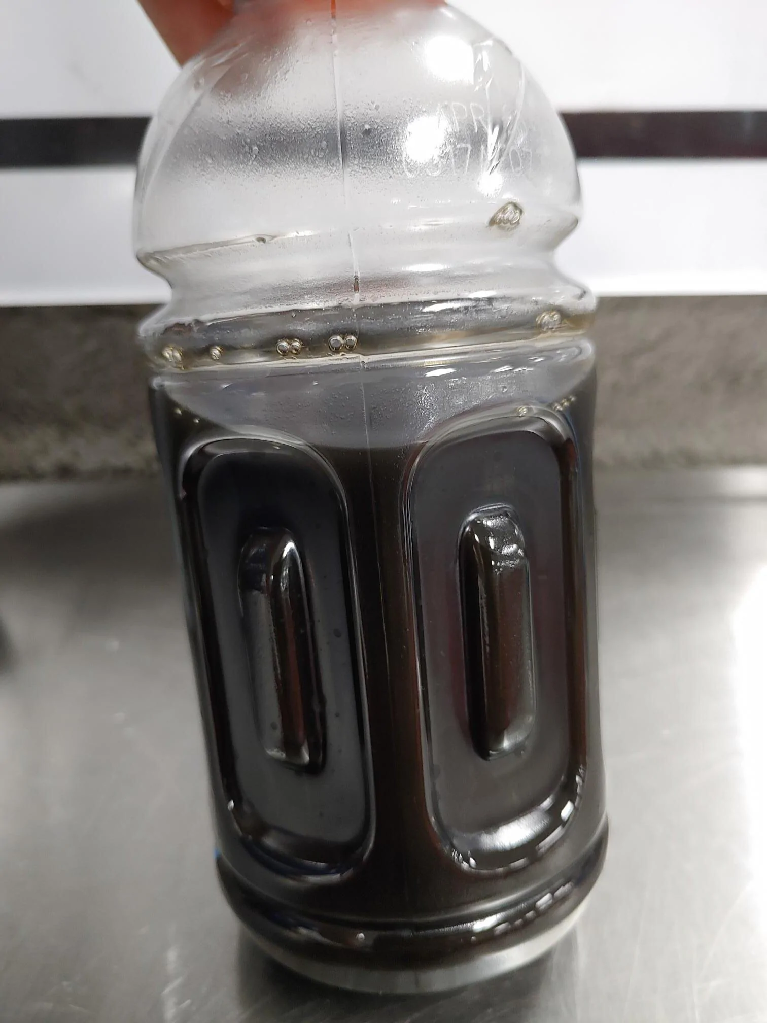

Fluid seems pretty dark after one year.

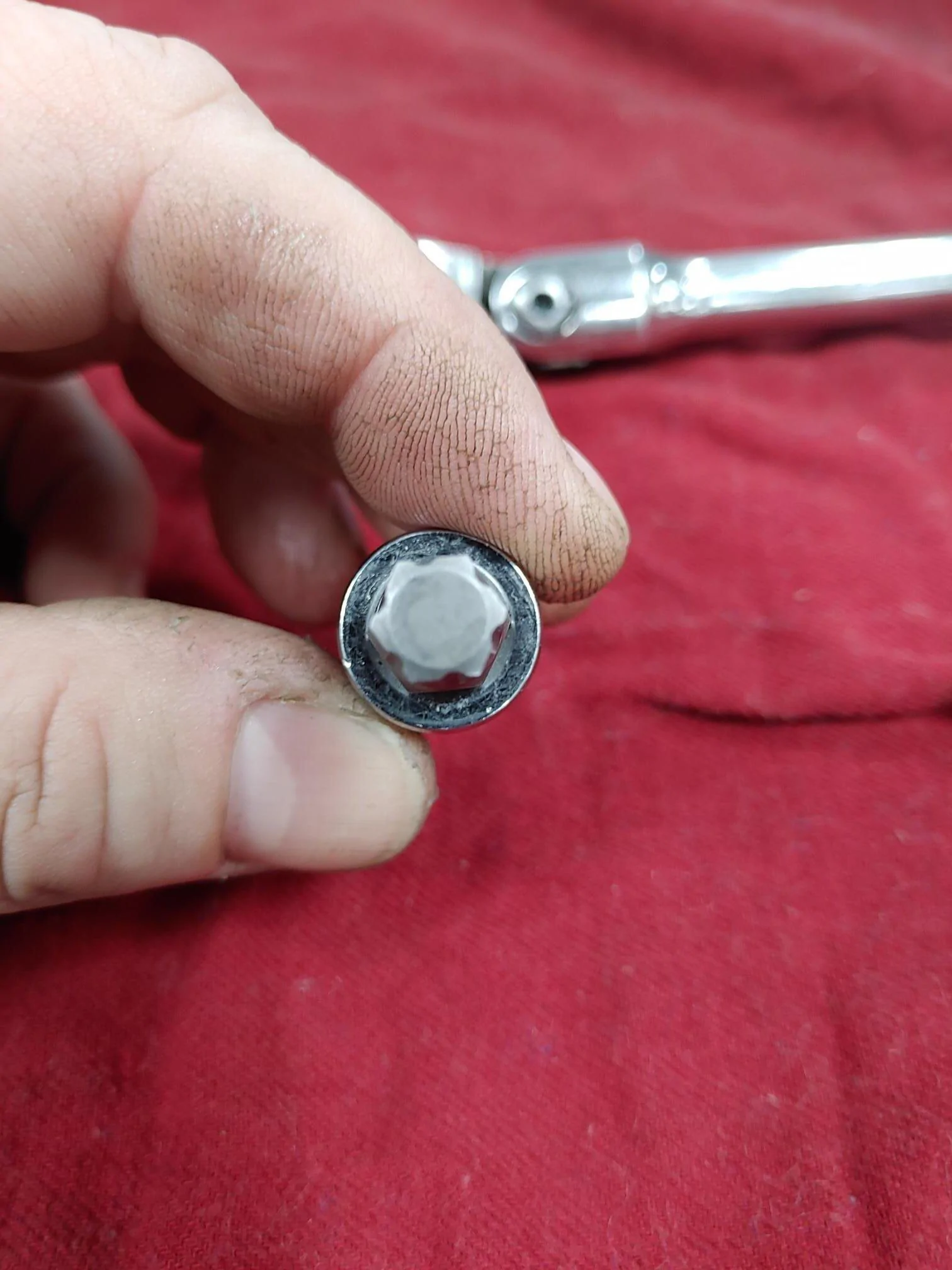

I used a different style bit, instead of an allen socket. Grips the allen fasteners better, with less chance of rounding out.

Fluid sample.

Cornwell Gripedge sockets. Better version of allen bits. Other brands have similar style bits.

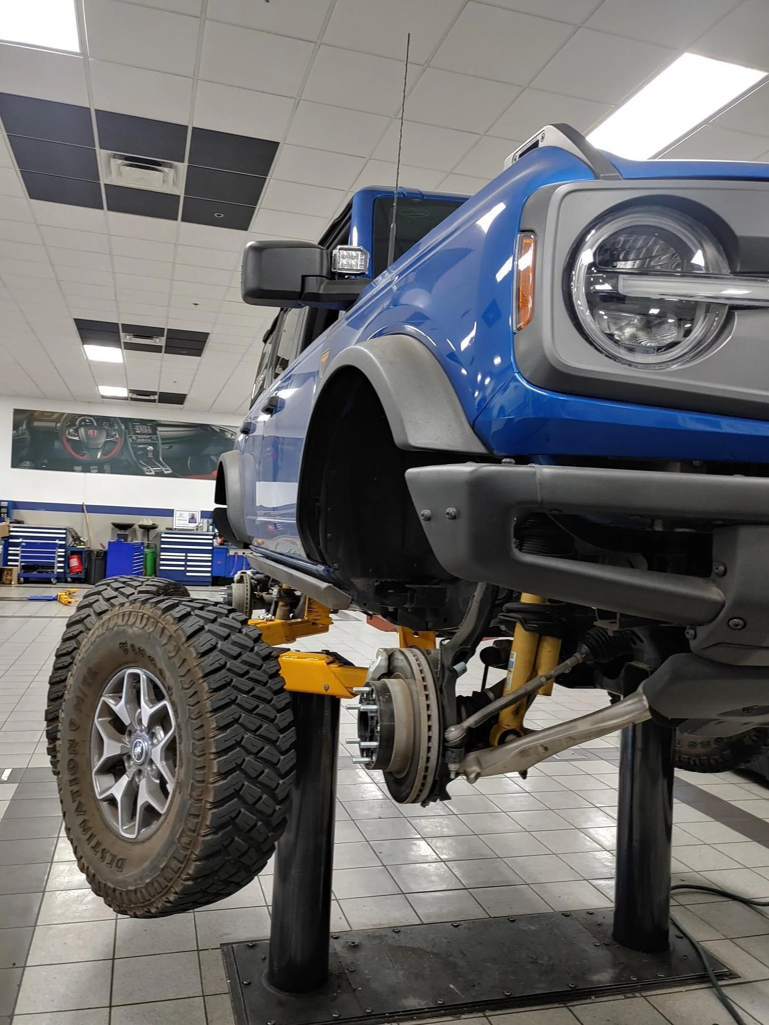

NICE SHOP....what you got going on for hanging the tires like that on the lift?
