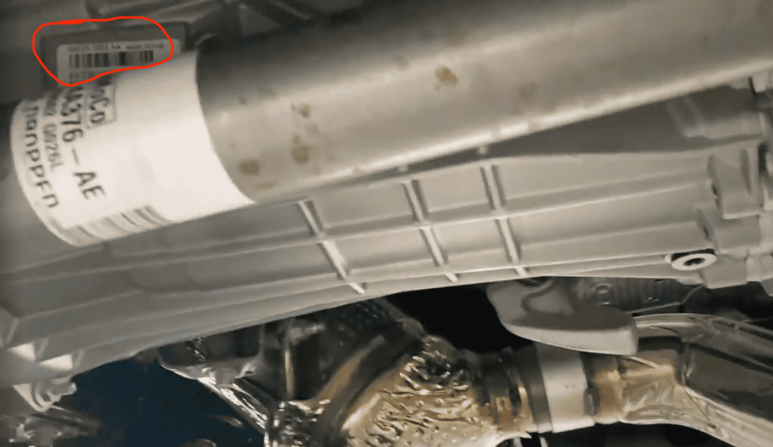

Where is that sticker located on the trans?
Drivers side. Just bend down and take a look, you can't miss it

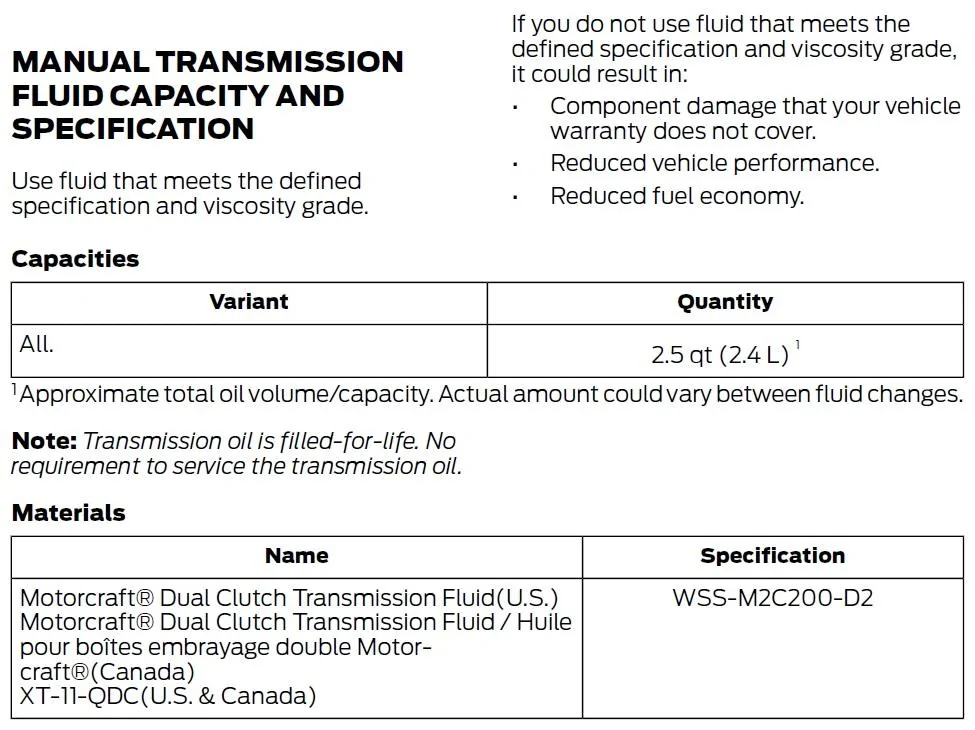

What’s the maintenance intervals on the fluid with the manual transmission? I’d probably do it the same time I do the axles.
It says "filled-for-life", lol!
“lifetime”. Absolutely BS.
I’d inspect the t-case and diff fluid at 50,000kms and again at 75. If all is ok, I’d swap all fluids at 100,000kms.

Ford transmission now revised to revision E
New Asmbly #: MB3Z-7003-E
Need to see what all was updated. Good to see they did something but 3 model years in when the issue was present early on? Wow!
Here is what is in mine :(
Ford Bronco 2.3L Manual Transmission fluid discussion MT Fluid
You were previously having the manual trans noise issue, and waiting for a replacement trans? Is this "E" unit the replacement trans installed in your Bronco? Did it get rid of the noise issue, or too early to tell?
