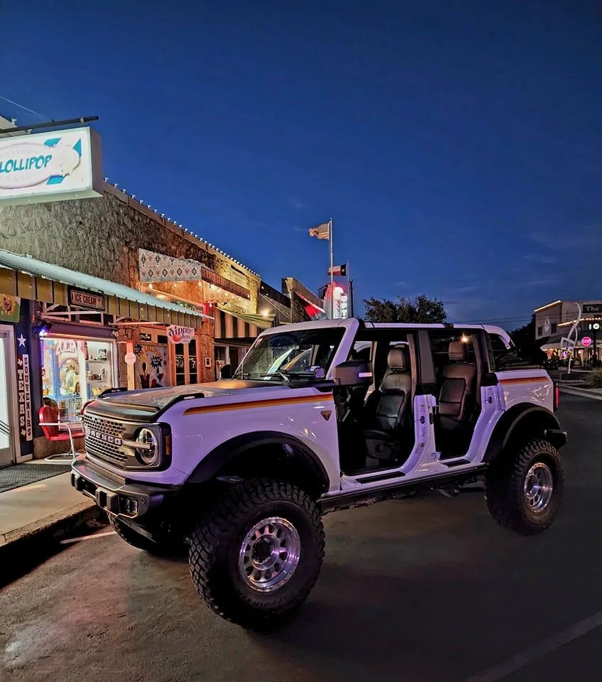

Started off with just some new wheels - Method 315 17x9-12 with some 35" General Grabber X3s. Before I started wheeling it, I had all the Broncbuster steering upgrades done (which I still have) as well as the 3" Body Lift and Zone 3" with their UCA's
Ford Bronco Bronco Badlands gets ADV widebody kit + 37's [Gatekeeper crawling & jump videos added] Build1
I loved the look and the height, it looked very nice. Paired with the stripes from @Underground Graphics it felt perfect to me. Also installed the @MandRautomotive dual pods in the bumper and his 40" lightbar which fit just perfect on the capable bumper. Ditch lights I went with @Diode Dynamics. Wanted to go 37's but there was a shortage with General Tire at the time so I went with the BFG KM3s which did great.

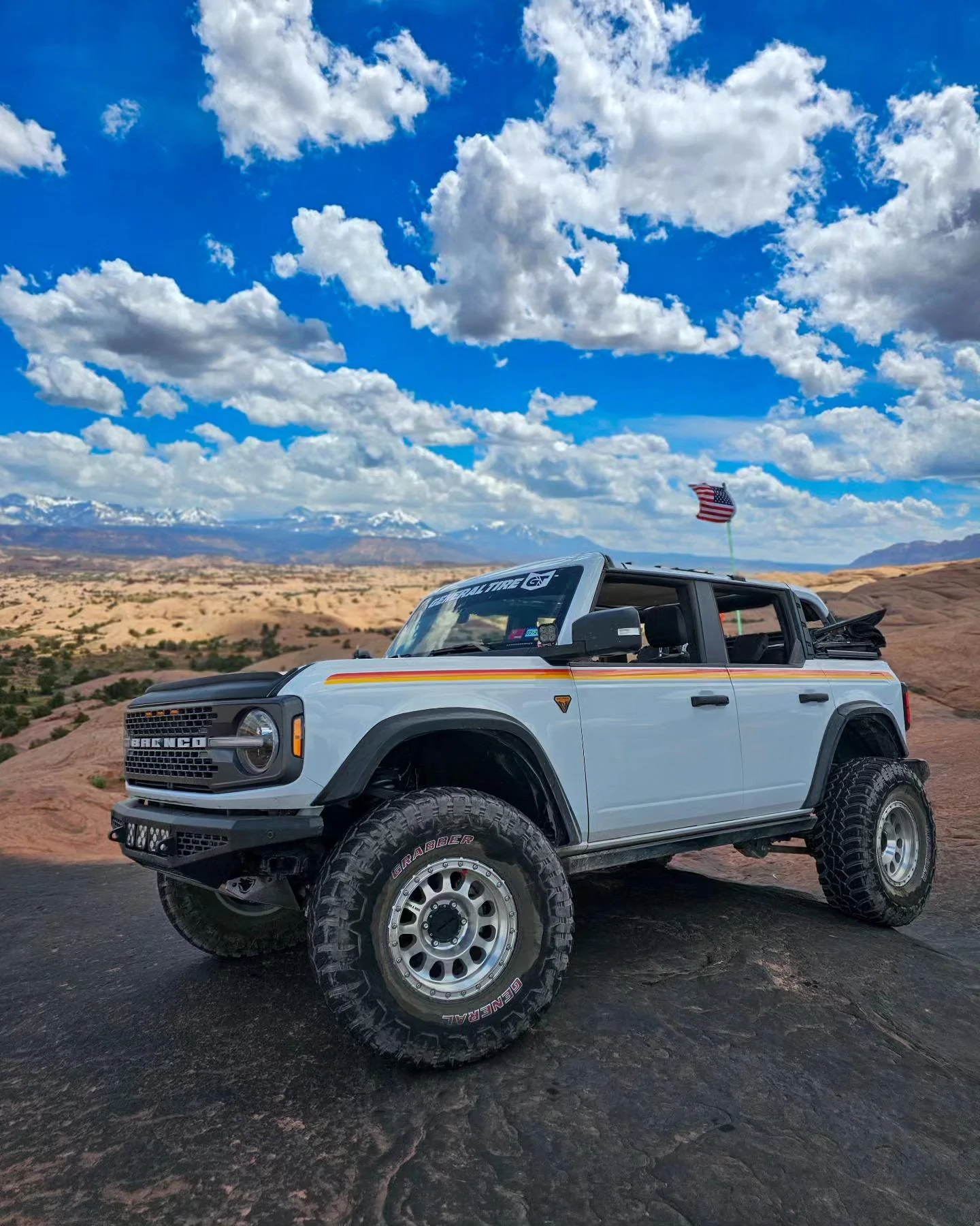

Made it out to Sand Hollow for the first time and it was amazing. Jumped and wheeled the Bronco a lot in the dunes in Sand Hollow with zero issues. From here I met Chris, the owner of @Lobo Off-Road and thought his high clearance bumpers looked great. Ended up adding his bumpers and front skid to the Bronco and his rear plate relocation. In the process, I removed my body lift which made it a lot lower but it felt so much more grounded. Also picked up the @Quake LED trail site deletes and their 4.5" square pod lights for the front bumper.
In Moab we did a lot of wheeling and some dunes, that's where I kinda F'ed up and jumped a little too high. Crunched my fenders all around. Got a hold of @ADV Fiberglass and talked to them about running their 8" widebody kit.

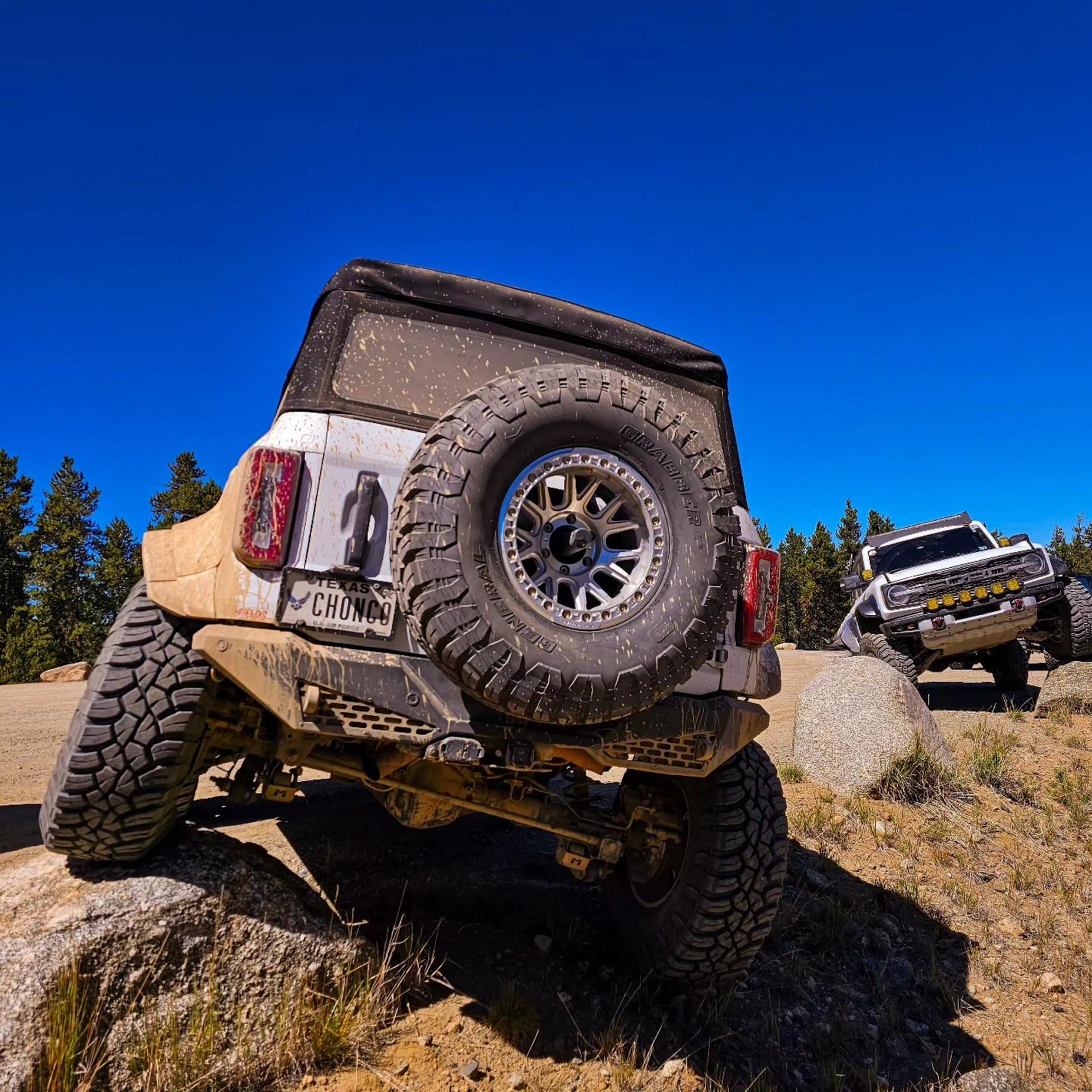

Recently I got the fiberglass panels installed and have been testing it off-road a bit here in TX and out in Colorado for SuperCel. There's hardly any rubbing and it looks great! I also swapped out my wheels for Fittipaldi Beadlocks with 2" spacers (until I get my Long Travel kit) and back to 37's with General Grabber X3's. Installed the Hammerbuilt tailgate reinforcement as well. Have a few @Metalcloak goodies on it as well, their trailing arms and some lower control arm skids.
Ford Bronco Bronco Badlands gets ADV widebody kit + 37's [Gatekeeper crawling & jump videos added] Build5
Colorado was amazing!

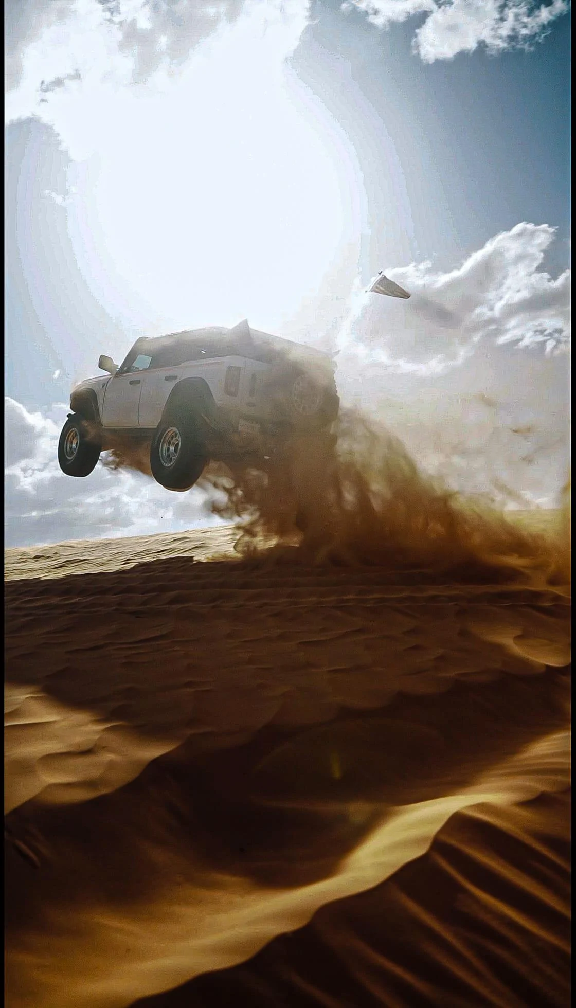

That LAUNCH is CRAZY!! I do some sketchy stuff, but only at slow speeds. You've got guts doing stuff like that.

How did that landing go?
Curious since I’m also running the Eibach coilovers and 37s.

It went rough lol. There was a bad bounce at the end. I ended up crunching the main harness on the driver side wheel well and everything shut off. After zip tying it back, everything eventually came back on after a few hours thankfully.

Damn bro!! Totally sent it! Are those the stock rock sliders? They did good on the rocks.

Wow your suspension clearly isn't set up well. That was a big send but especially in sand you shouldn't have bounced so radically. You need more rebound damping and possibly multiple other changes. A rig can crawl and jump on the same setup but fast, real time electronics also help a lot...
