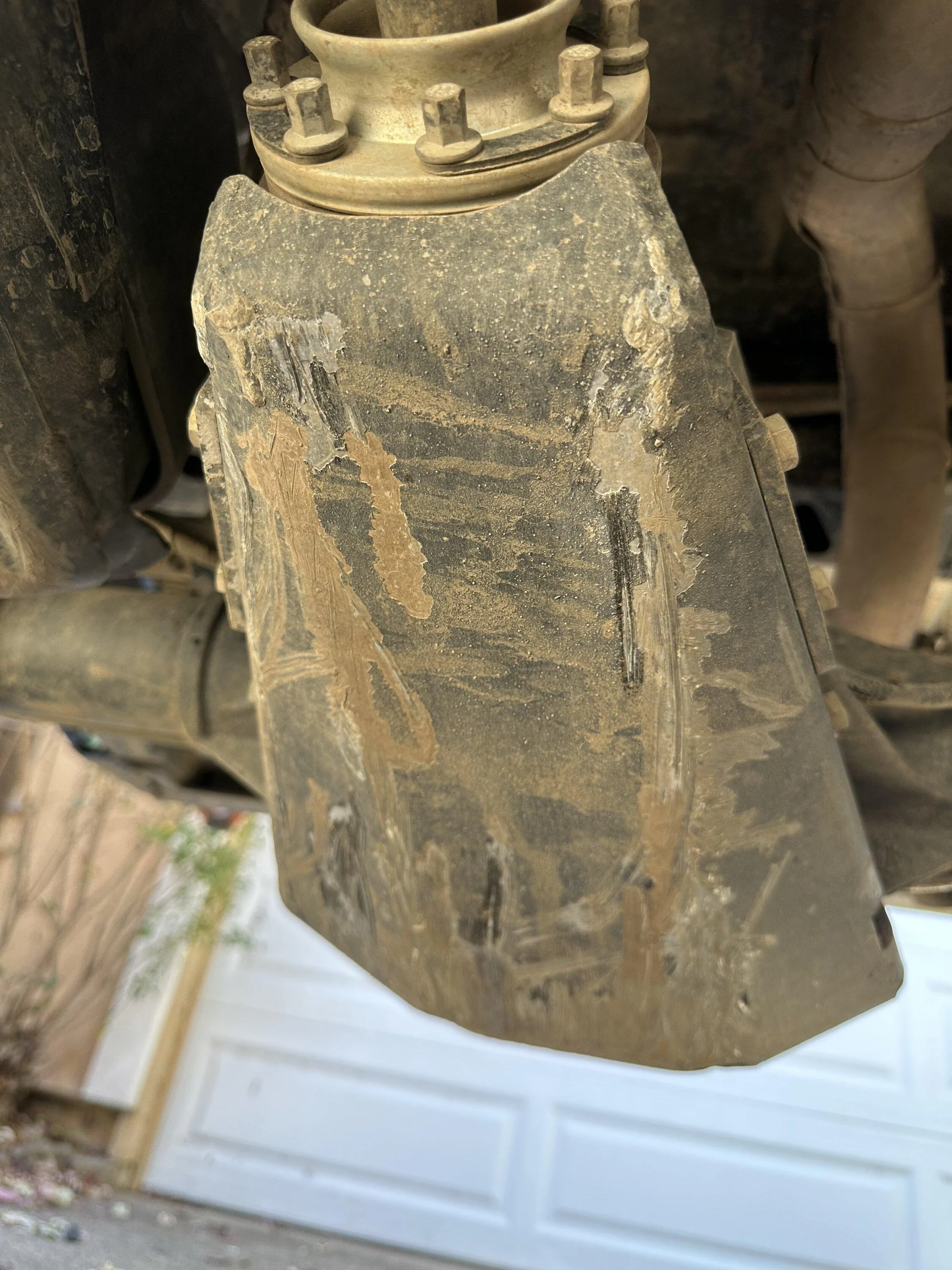

I also wanted to test my Talons garage transmission skid so I set the Bronco down on it twice to see how it would hold… it held:)

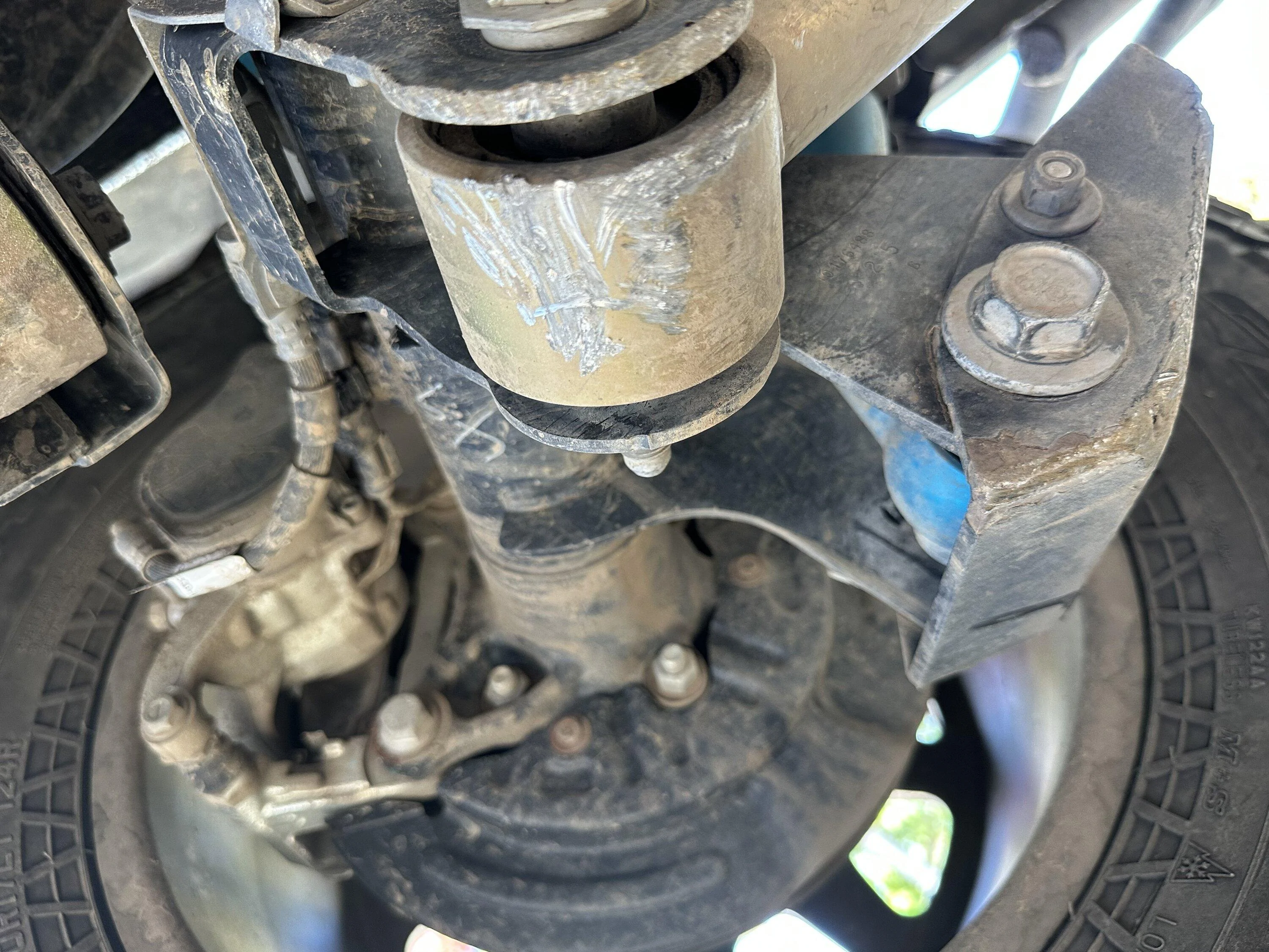

I’m also very happy with my Foutz lower control arm gussets up front. No more bending my brackets on the rocks!

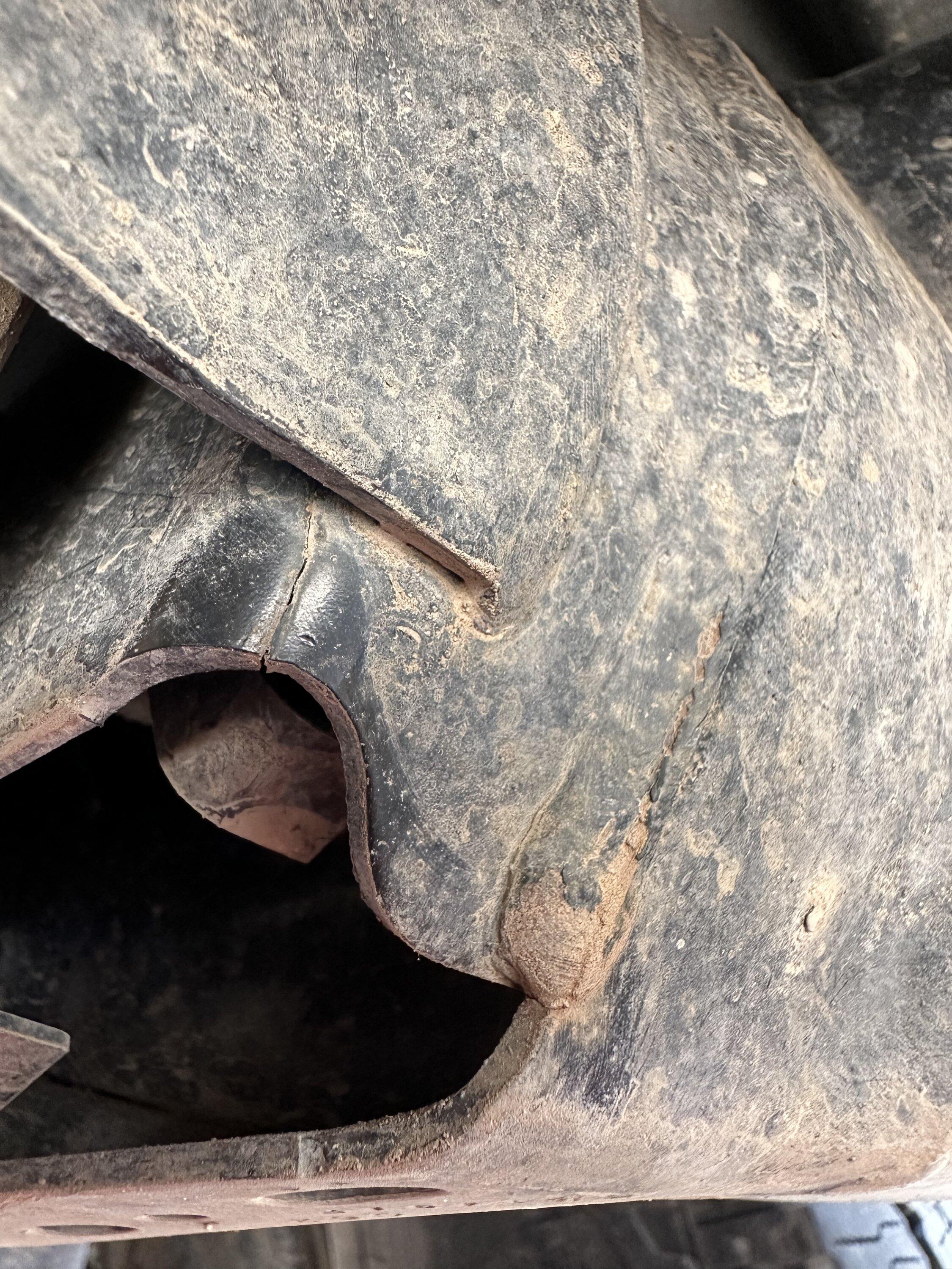

All in all I had a blast and didn’t retain any body damage. I did start to crack my rear, upper control arm bracket as I’ve seen happen to a few earlier Broncos now. I’m told they now have gussets to prevent this. Guess I’ll have to add my own. Here are some photos and some of my rock scrapes. Can’t wait to go again!

Looks like I missed out on an amazing trip, we have just got to love living so close to one of the best known trails around. Only 1 /1/2 hours from Home, one my favorite places to wheel right up there with Moab. It was the Rubicon trail that made me go to 37s, on 35s it just beat the shit out of the undercarriage and Bumpers. Last weekend when we were out on the trail it was so much easier over the boulders. Thanks for the photo of the crack in the mount I need to check mine after two years of wheeling. Rock on.

That looks awesome! What causes the crack?

21’s and 22’s have a lot of stress there apparently that the engineers didn’t catch. 23’s and on are gusseted. I’ve only seen a few people have that crack and they wheeled a looot.
