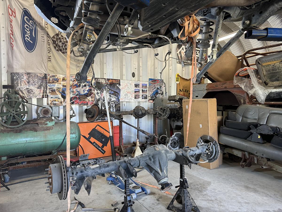

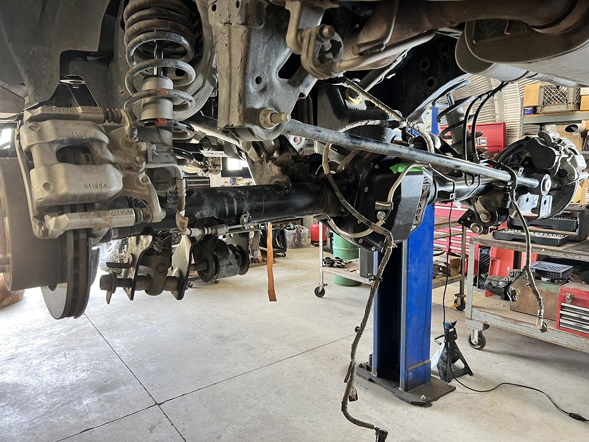

Hey guys here's a video of my wife and I removing the M220 rear axle and swapping in a "new" one. It's the second video in our series on re-gearing and axle-swapping our '21 Ford Bronco Base. This video covers the process, in-depth, of removing and and re-installing the M220 rear axle assembly. In our case we swapped in a used Badlands rear end that we had already re-geared and freshened up. But the process would be the same for those considering installing a brand new M220 complete axle assembly from Ford Performance or the Ultimate D44 from Dana.
Disclaimer: This is our longest video to date as we wanted to capture the entire process for anyone considering doing this work themselves but might not be sure what it entails. Experienced mechanics might find it a bit basic and ponderous so it won't hurt our feelings if you choose to find something more brief to view for your Bronco entertainment. But for those considering this as a DIY project, it's all in there so grab a beer and follow along!
Ford Bronco Complete Rear Axle Swap (M220) - In Depth DIY Video IMG_6752
Ford Bronco Complete Rear Axle Swap (M220) - In Depth DIY Video IMG_7026
This is the second video in the series. Please check out our 5.13 Gear Swap video, the first installment in this series, if you haven't yet. The next video will cover the process of swapping our Bronco's stock M190 front drive unit for a re-geared and locked M210, so stay tuned for that one. After that we'll cover the process of buttoning everything up, hooking up the locker switches, and installing ProCal to delete the FAD.

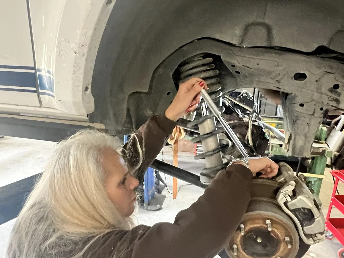

And yes, Steffie did do some of the work!

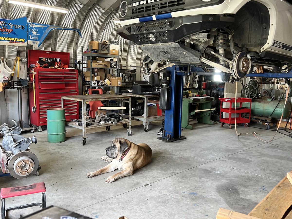

Who cares about your axles. Tell us more about your pup. 😀
Bullmastiff?
