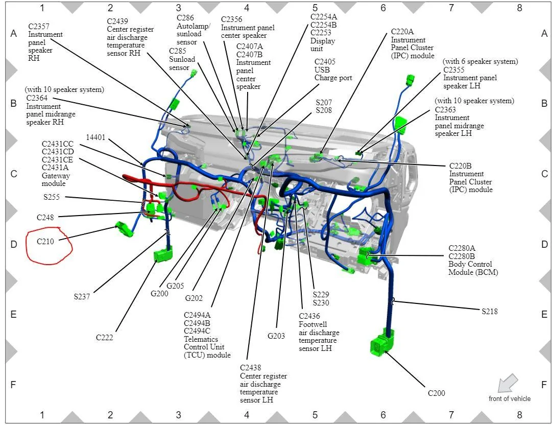

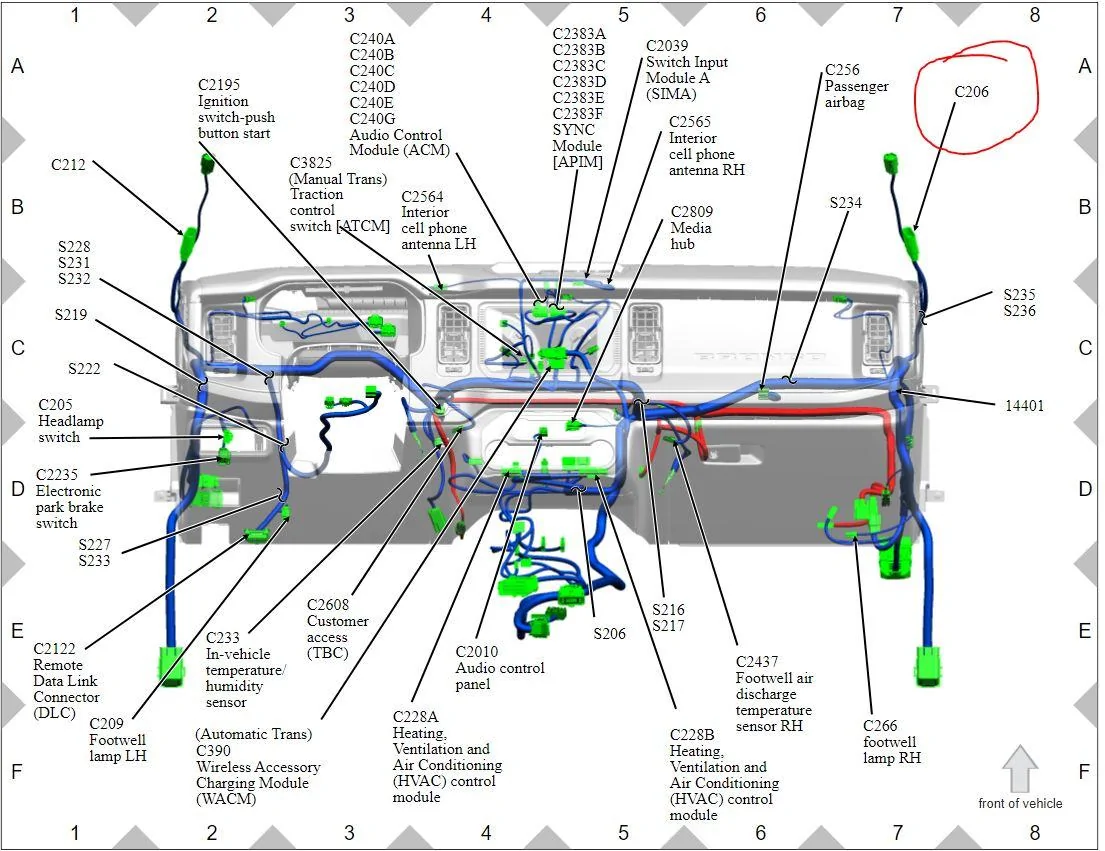

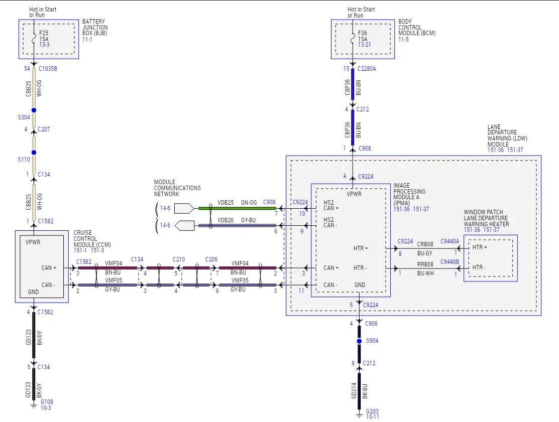

The main wire harness should have the sensor wires but for the life of me I could not locate the correct pins inside the cabin on connector C210 (under the dash passenger side) so I soldered a pair of wires from connector C206 (A pilar passenger side) and brought it out to just under the grill and splice it into the M2DZ15A211B wire harness.
If someone wants to take another shot at it and locate the pins in C210 with pictures, everyone would benefit since they would not have to pull the wire all the way through the engine bay. The pins should be #20 and #4 but I could not get continuity signal from them. I am not sure why.
You can look at the diagram below to understand the issue better and locate the connectors.
