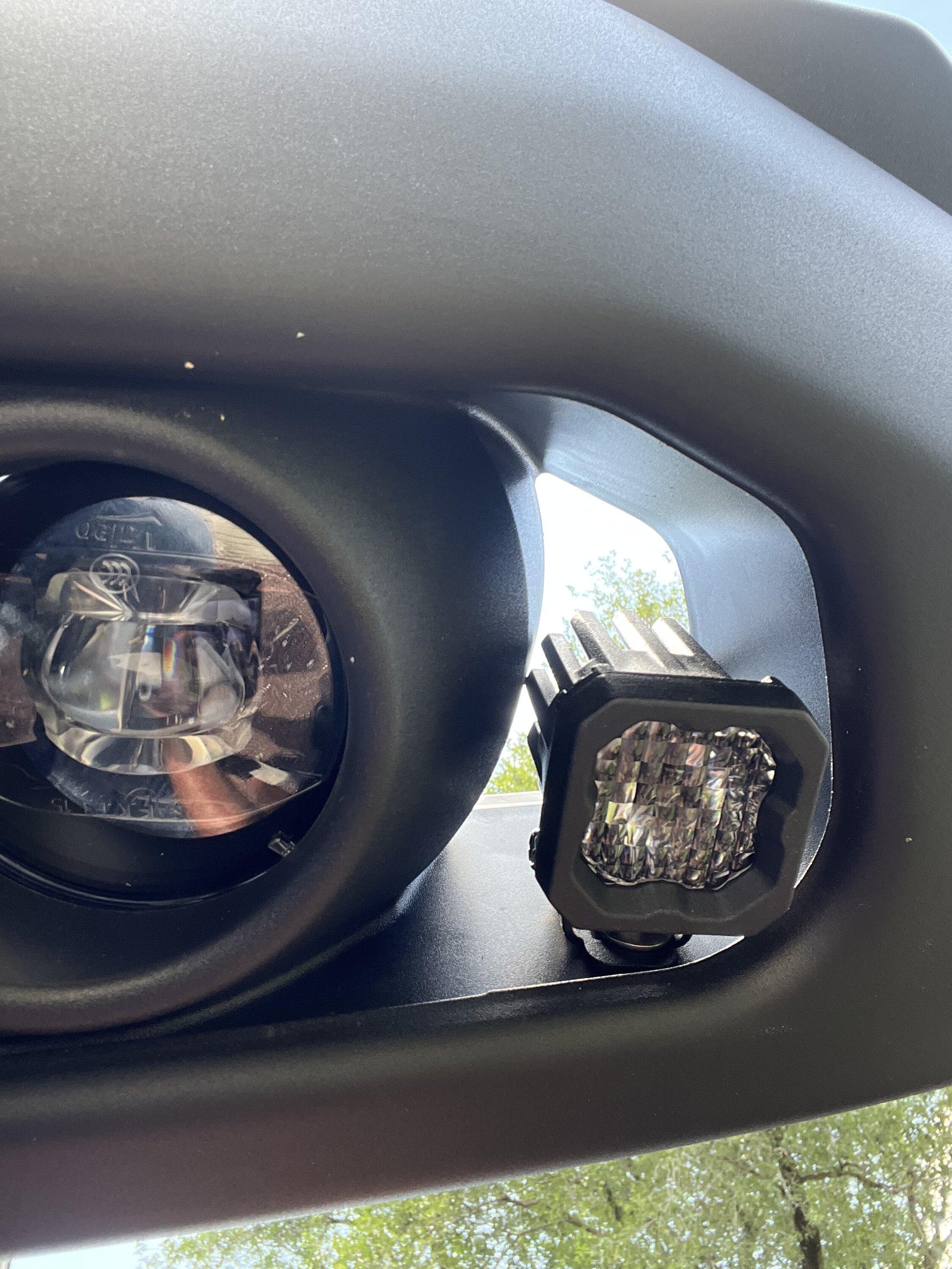

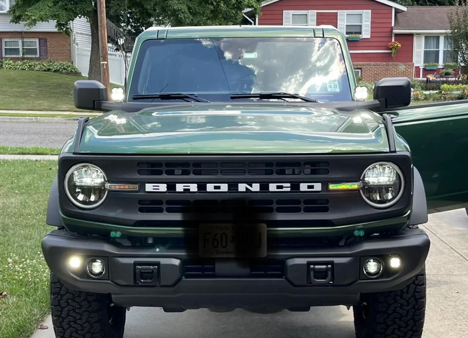

I put diode dynamics C1 fogs next to my factory fogs on my black Diamond capable bumper. The second pic is upside down but shows the mounting location. Easy install. They are back lit via the factory fog switch and full fog via the aux switch.
There’s another thread on here that details the set up.
https://www.bronco6g.com/forum/thre...aded-with-diode-dynamic-fogs-and-spots.46551/
Hope that helps.

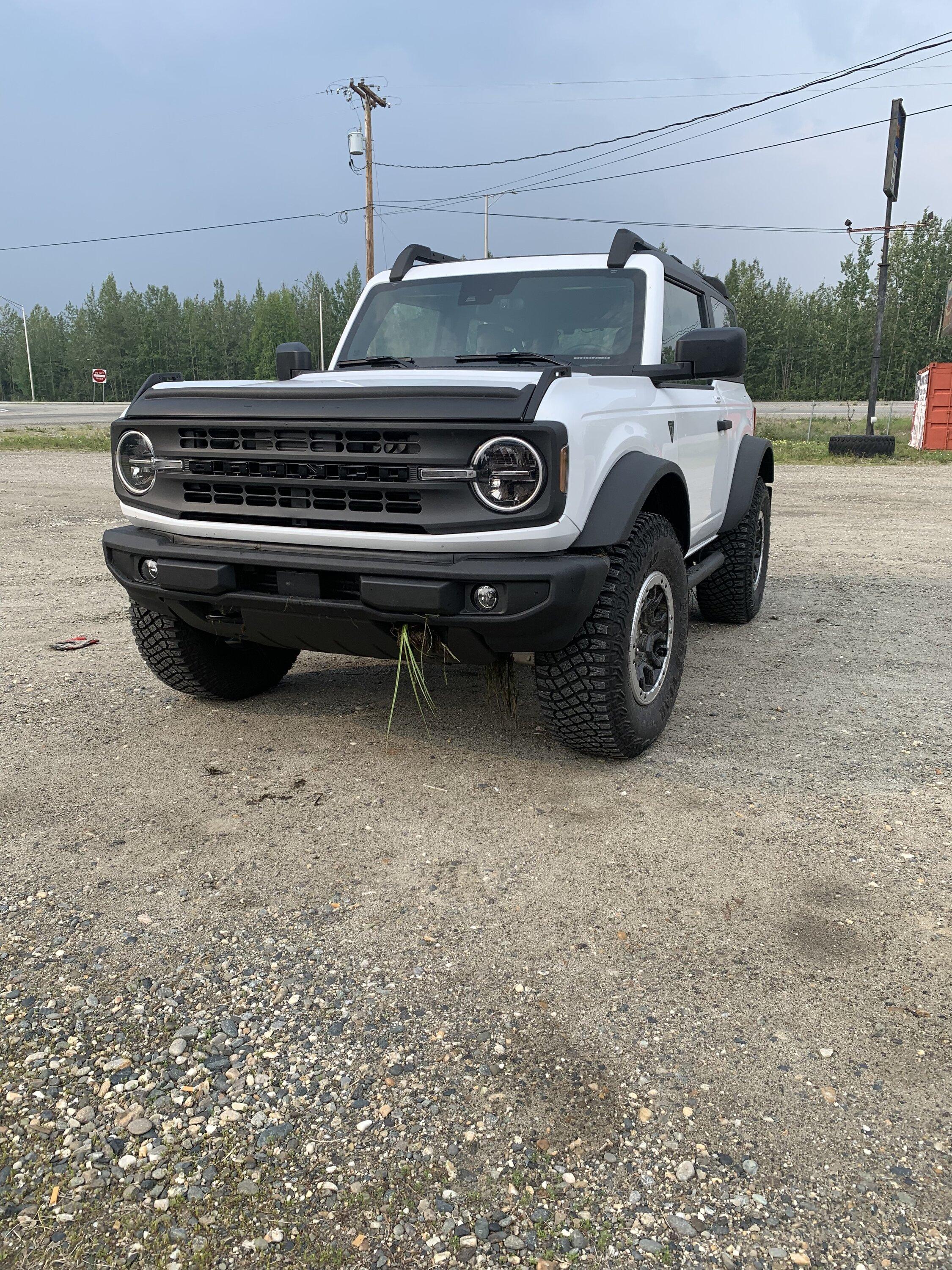

I used generic ford knockoffs off Amazon paired with a h11 harness and led bulbs. Used a 3” hole saw on the covers. Whole setup was $40, I figure If they suck I’ll buy the OEMs. Still need to finish wiring to Aux 6 but it hasn’t been dark here yet.

Looks great. Can you share the link to the lights?
