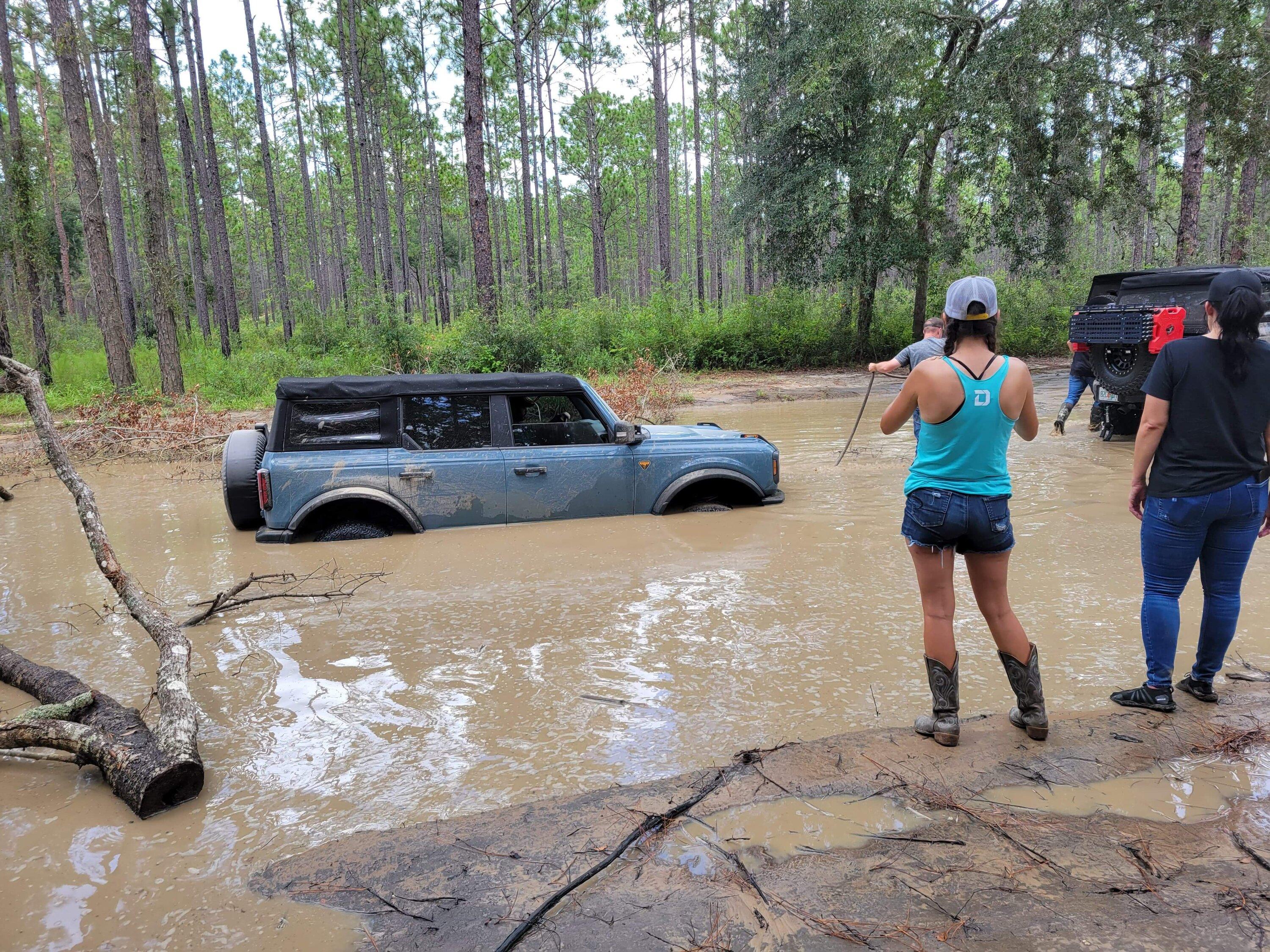

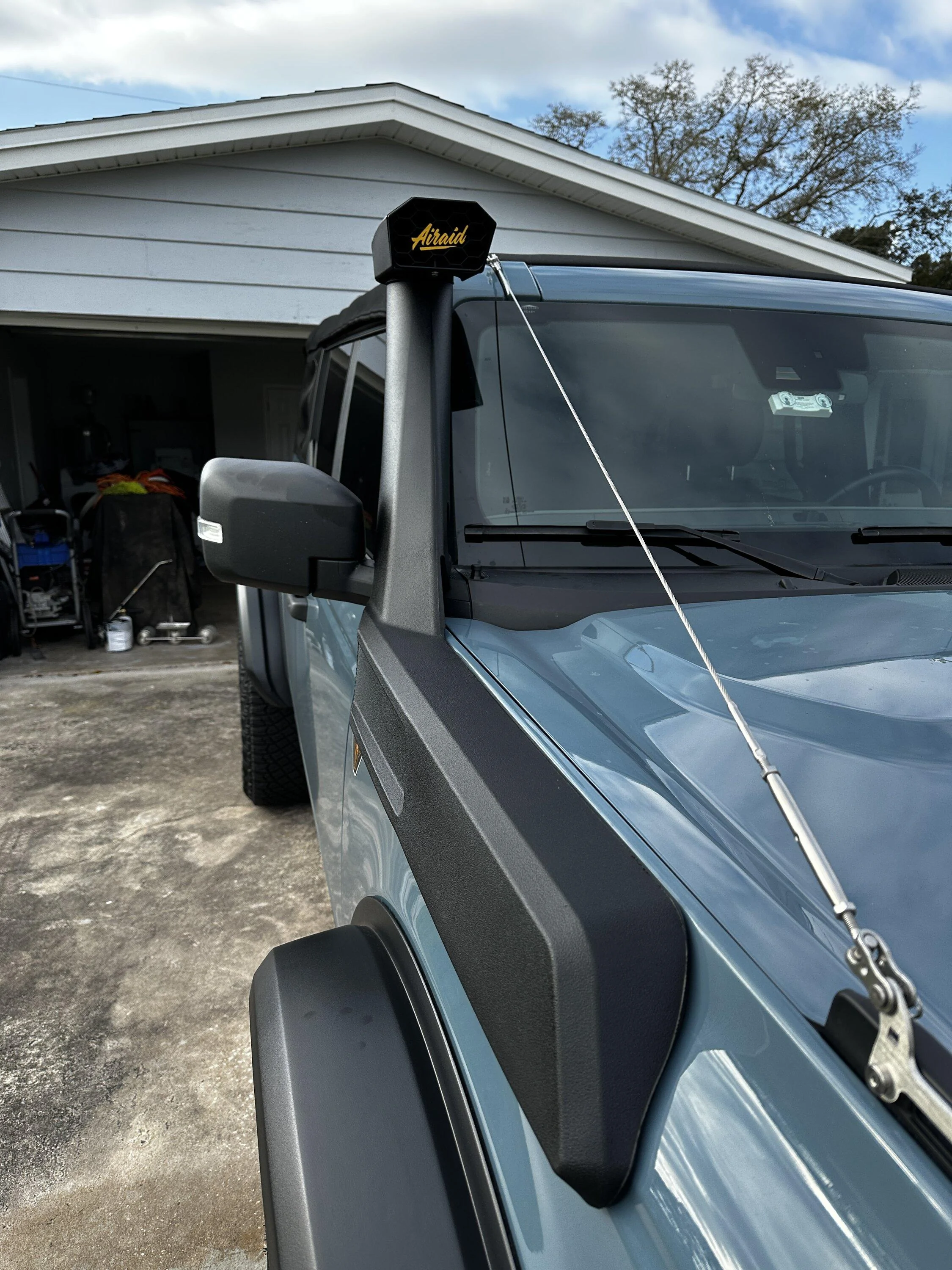

Well I took the plunge and purchased the Airaid snorkel for the Ford Bronco. I had my ten minutes of fame when I was stuck in the middle of a mud hole and my motor stalled because of water intake. Everyone jumped on the picture/video claiming alternator but the alternator was fine and still is.

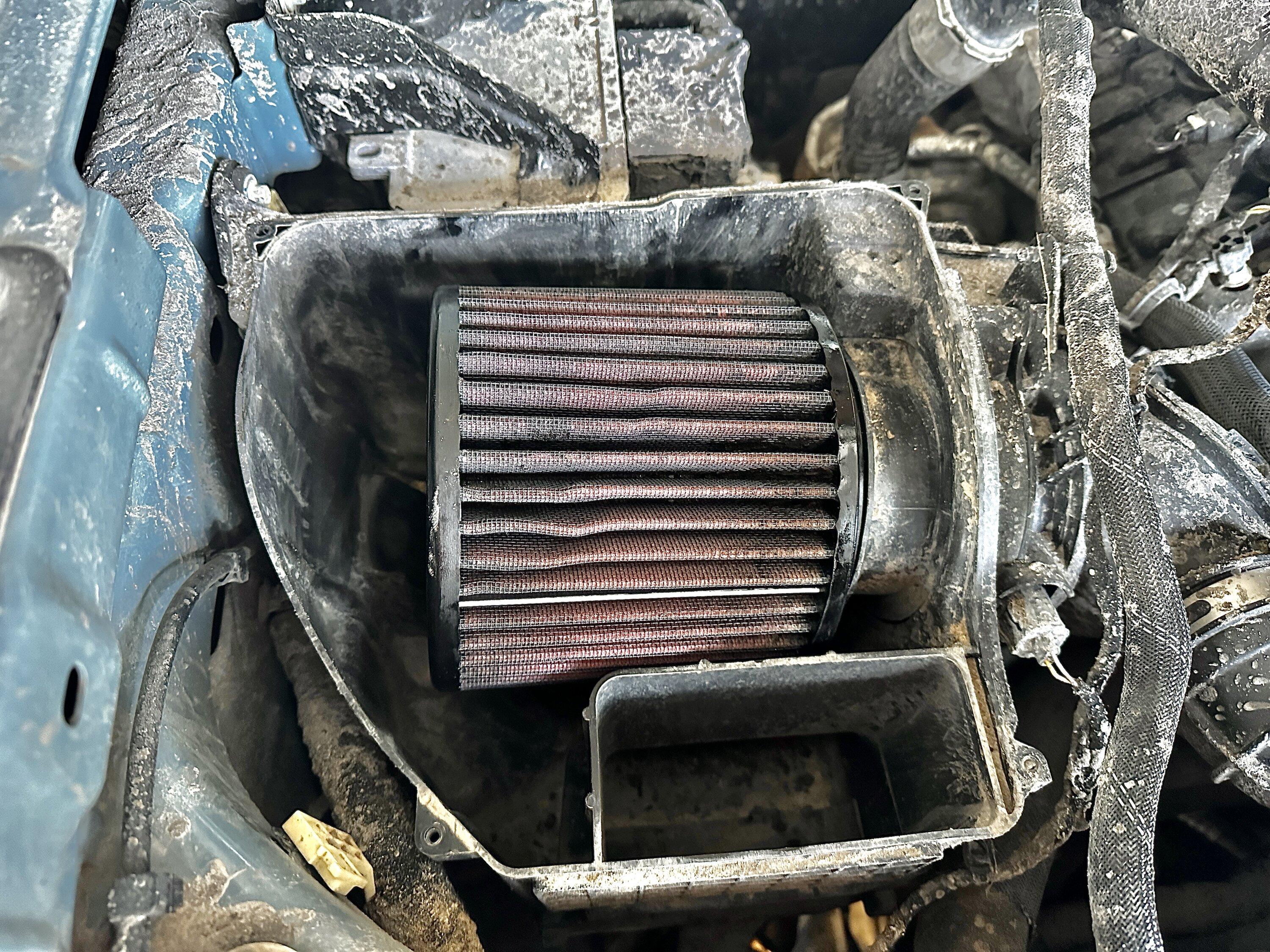

If you have been off-road and looked at your air filter, you will know that a lot crap gets into the air box.

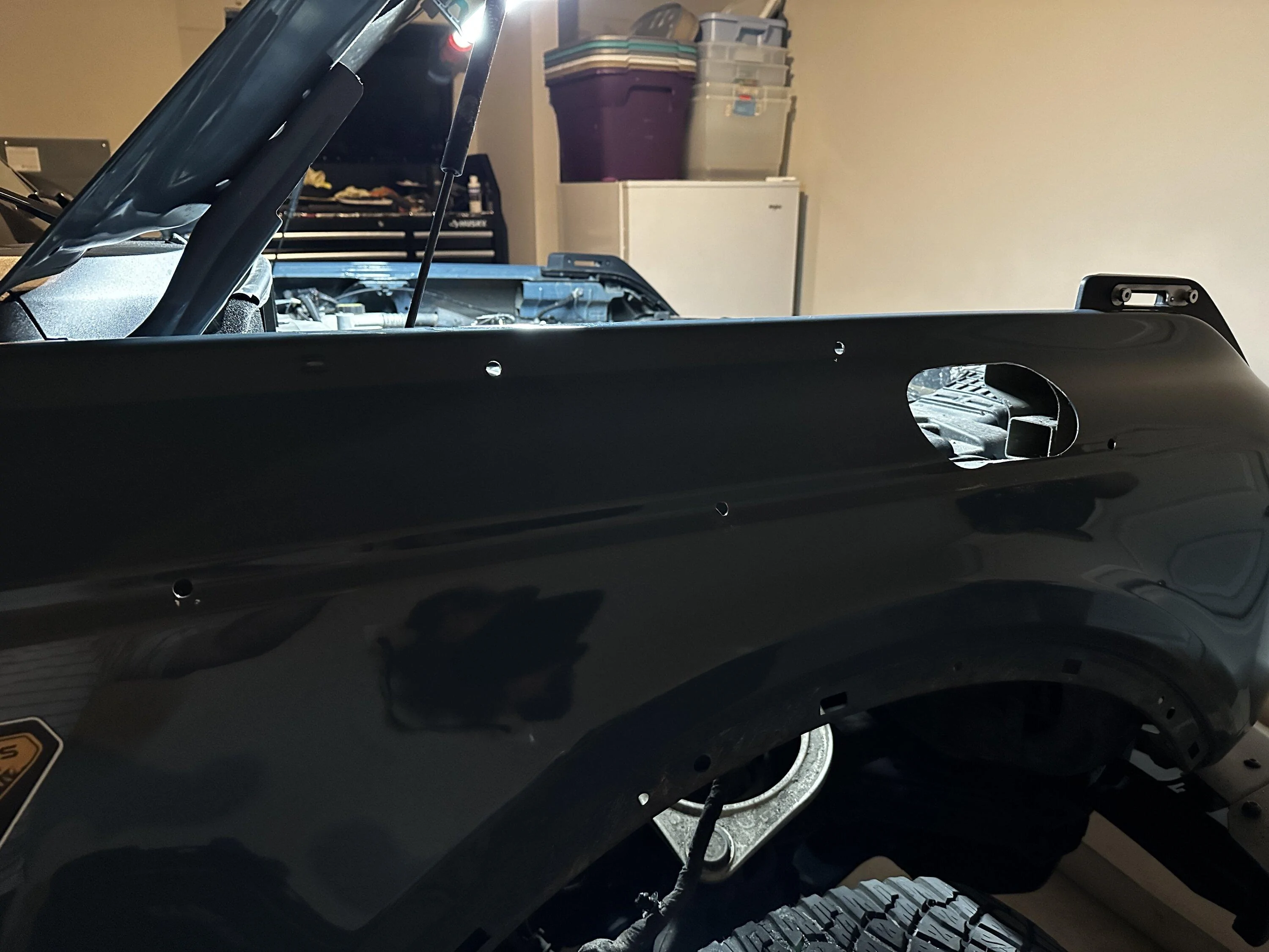

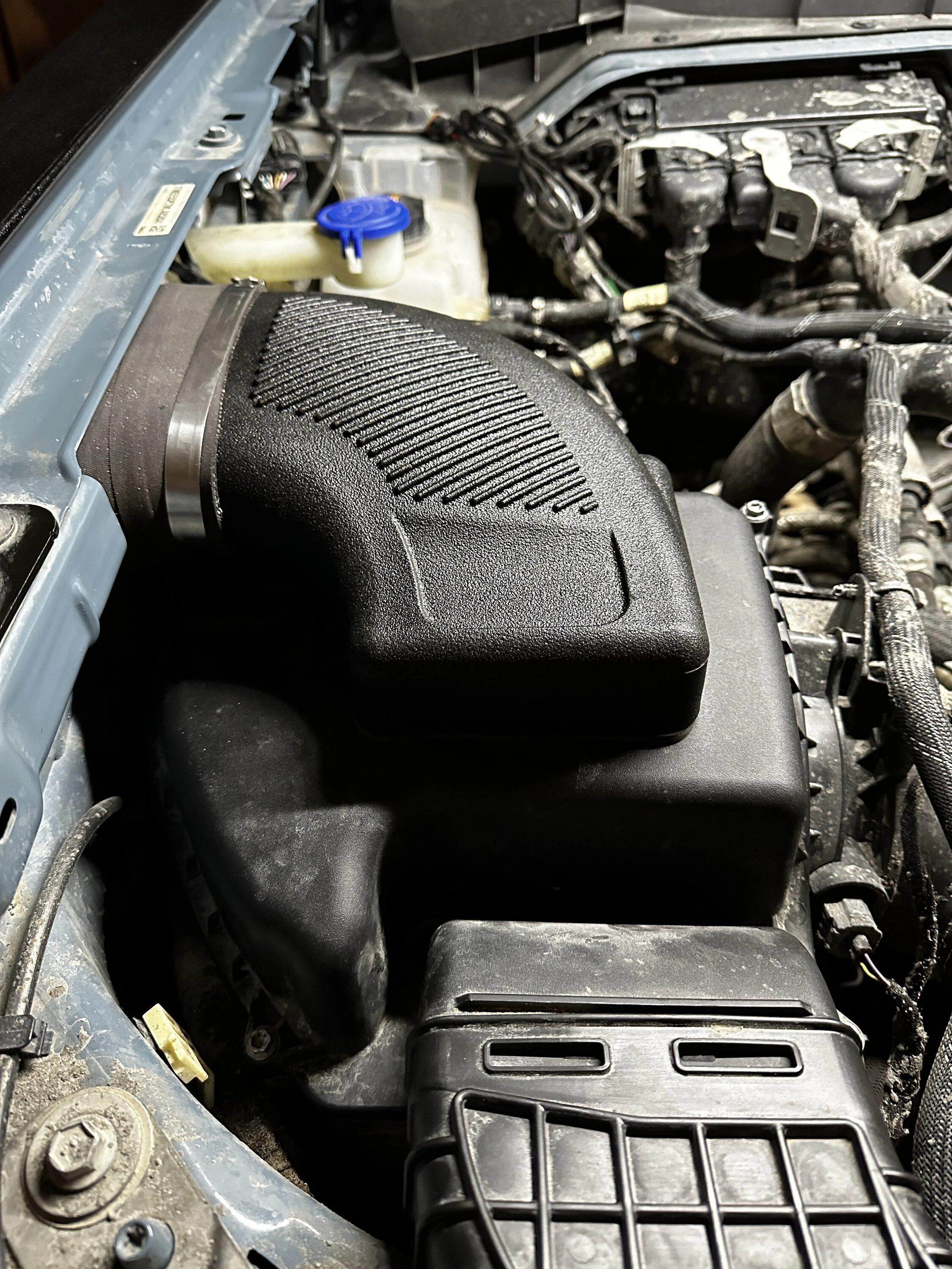

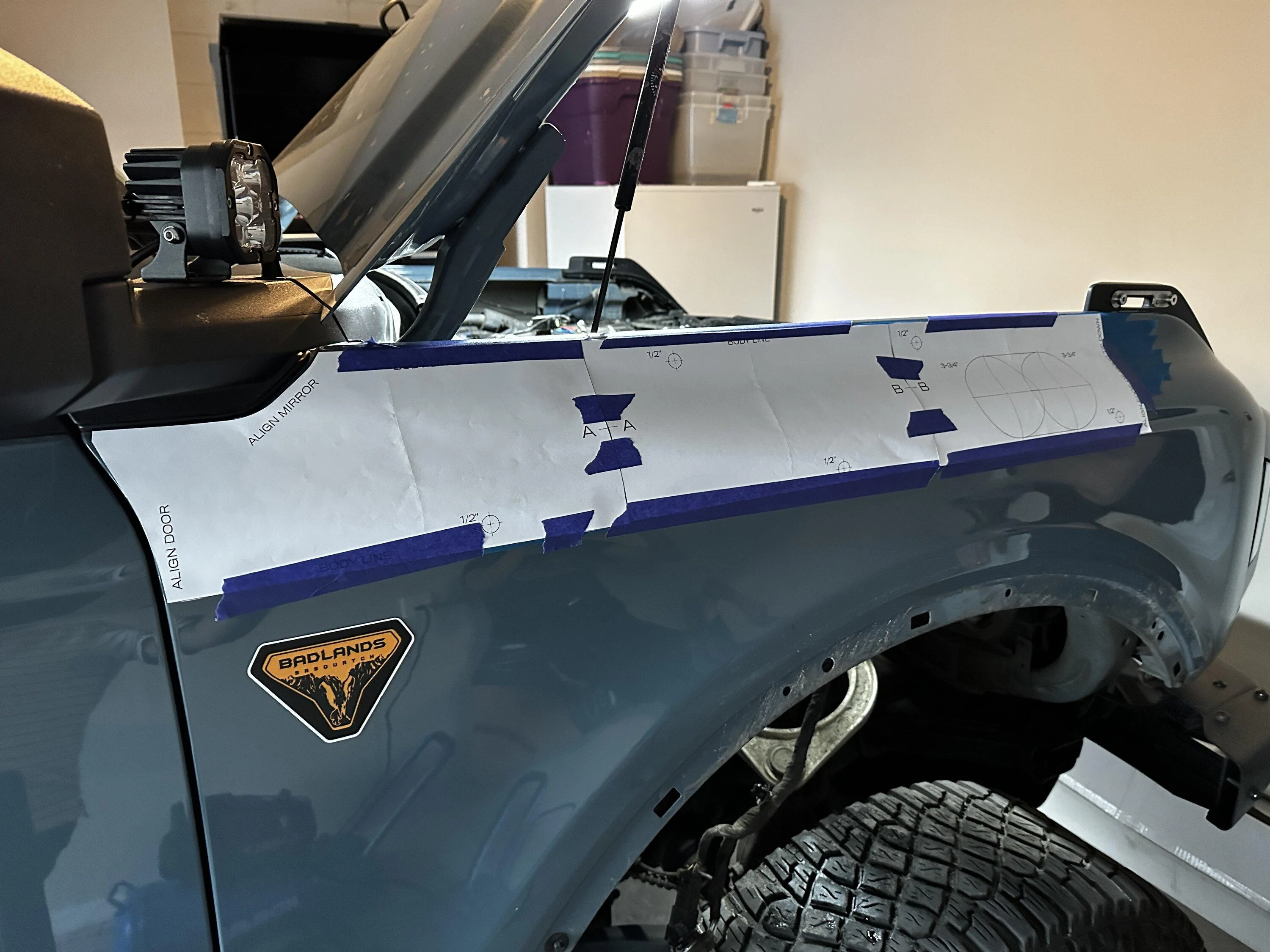

So with the install, I sought the help of someone experienced with these sorts of things. I didn’t trust myself in cutting holes into the fender. The install took a little longer than we thought but in the end, it came out great. Some holes had to be made bigger because things weren’t 100% lining up but it wasn’t too big of a deal.

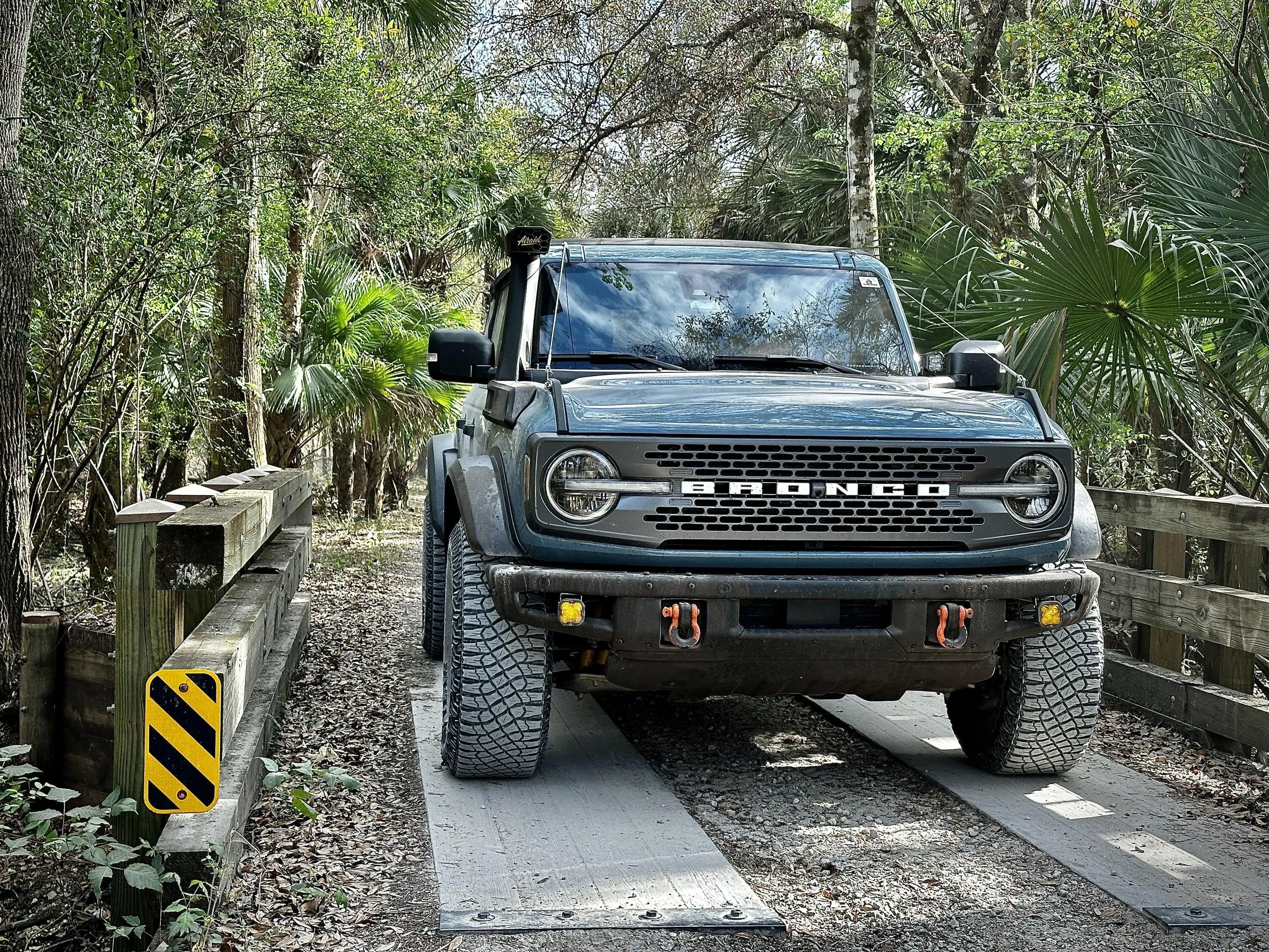

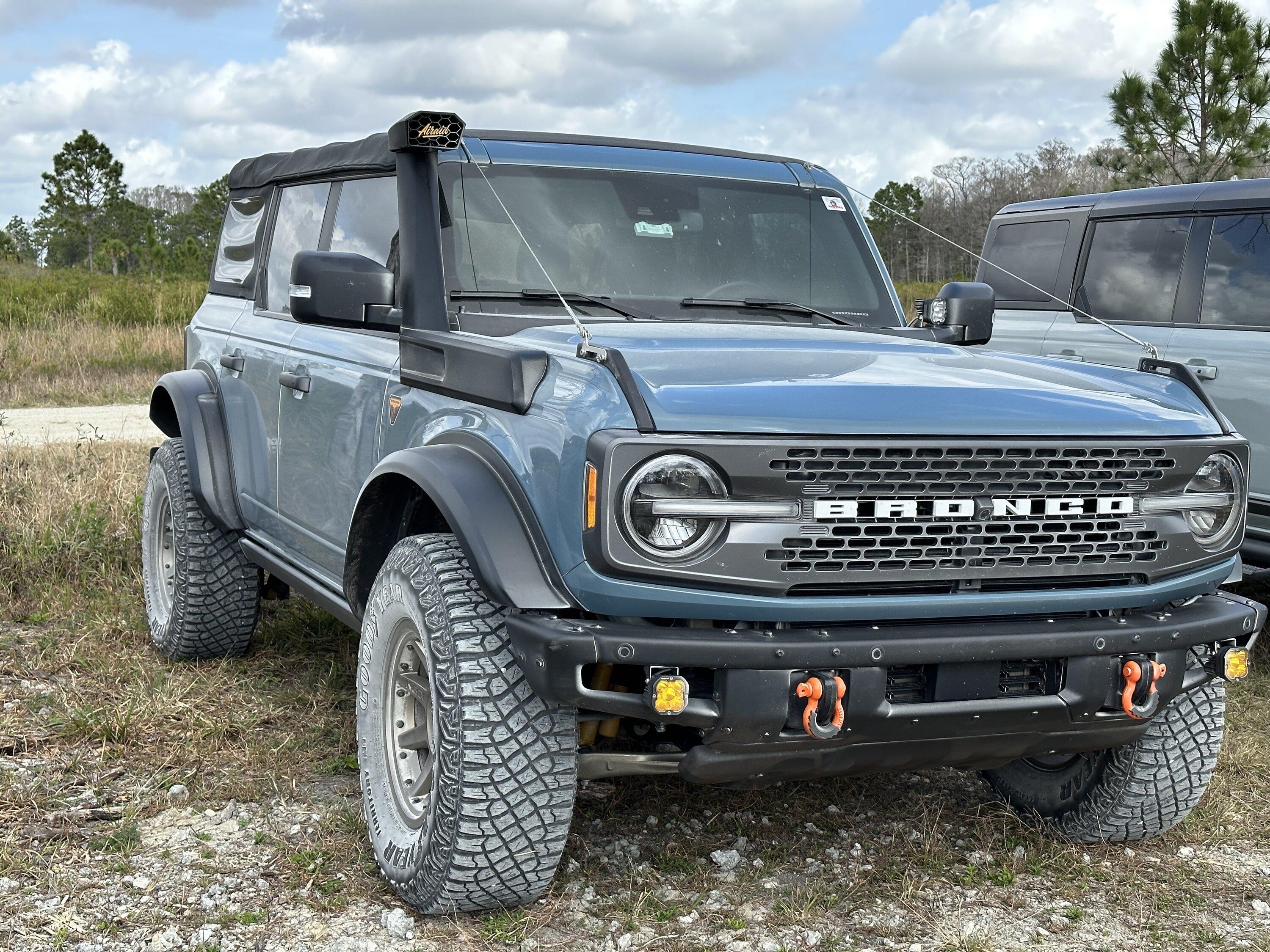

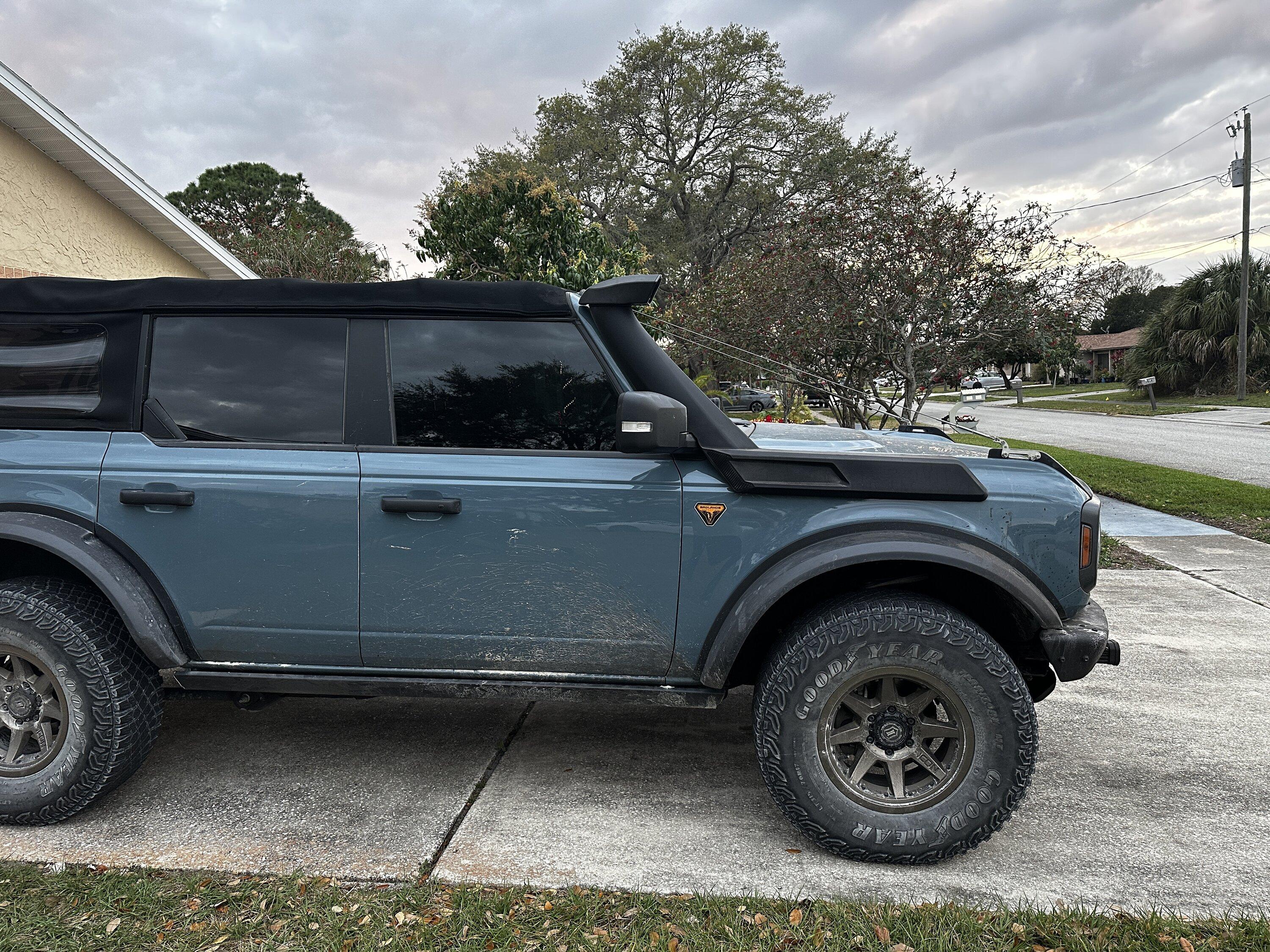

The snorkel looks amazing. My only grip is that they provided no way to close the stock air box intake. I am working with a company to come up with a solution but I don’t quite understand why they wouldn’t provide a way to seal off the air box. Even if this was for just cleaner air for dusty applications, the dust and dirt can still come in through the factory intake so that doesn’t make sense to me.
For those who will say that I will have alternator issues before I suck in water... I say that is incorrect because I have stalled the motor once already and that I rather fix/replace the alternator than get water in the motor.
