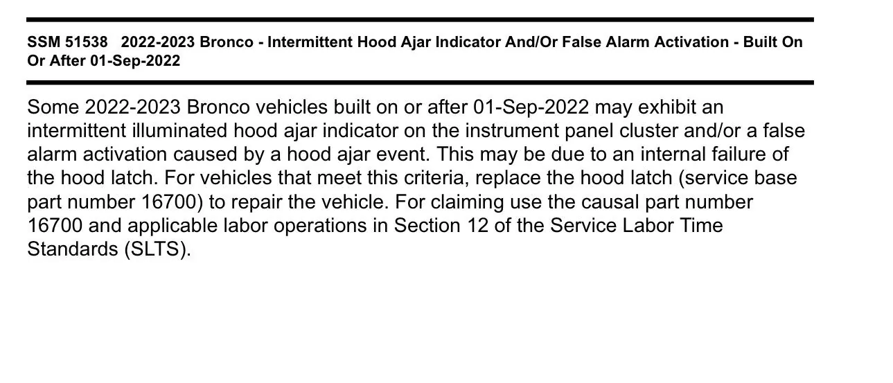

Has anyone gotten the hood sensor fixed? My ā€˜23 has set off the FordPass alarm a couple times since I got it (once a month). When I was getting a couple other warranty items fixed, I asked them to look at it, they said they couldn’t replicate it so it wasn’t broke, so no fix.
Ducati1098
9,997
23,246
Midwest
It’s a known issue with an SSM. They should replace the hood latch.
Thanks, I’ll try that if it happens again.
