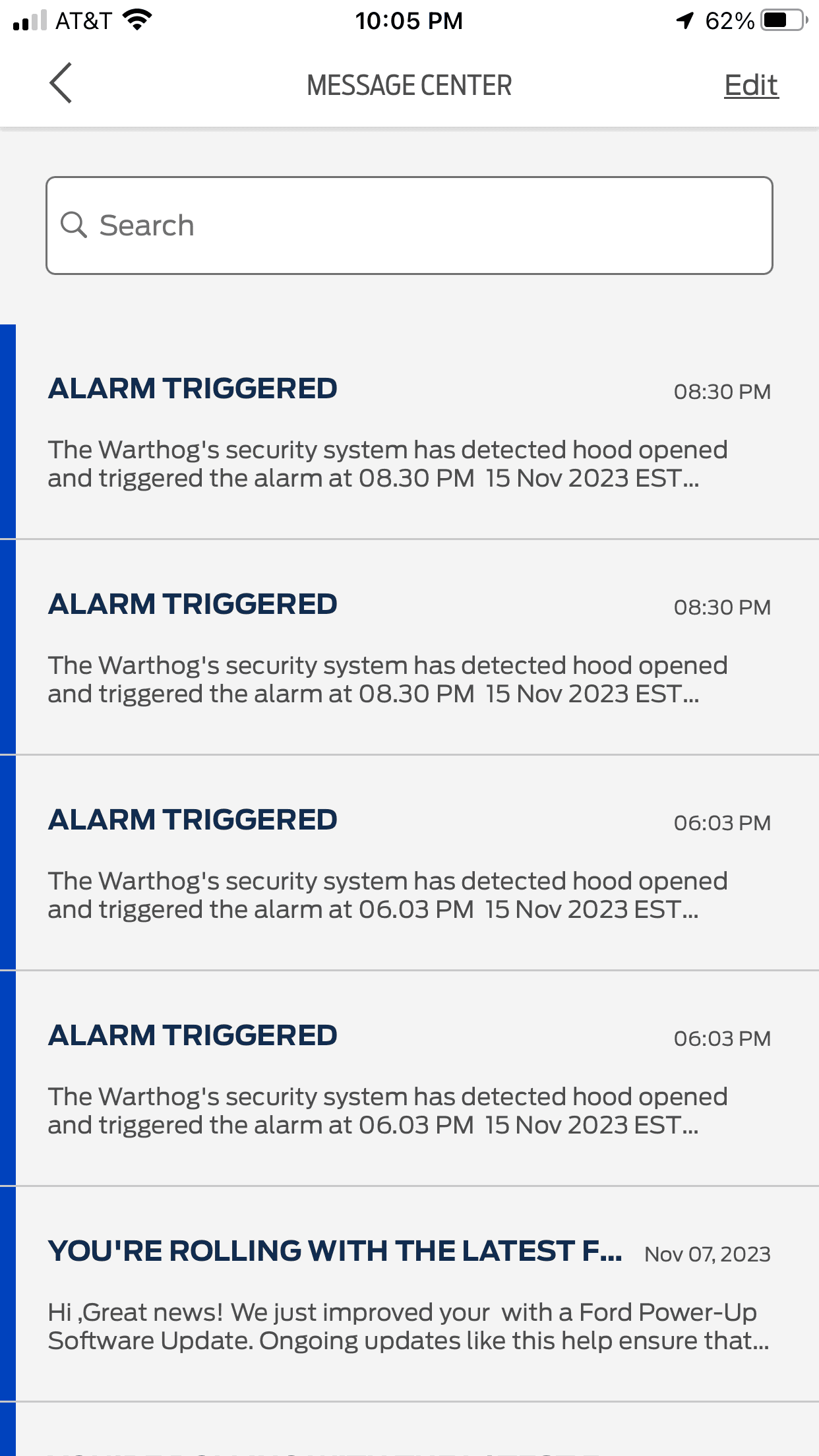

Same Hood ajar warning triggered alarm event on two occasions in the last sixty days happened to my September of 22 Built Bronco Badlands. Watching thread for actual fix.

Hello. I have an early 2023 Badlands Manual Sasquatch and tonight my hood alarm triggered in my HOA community twice. I thought someone was breaking into my car causing me to come out of my home running. What can Ford do about the anxiety and disruption these faulty parts are causing? These are new vehicles and this will be the third thing I'm having to get warrantied.

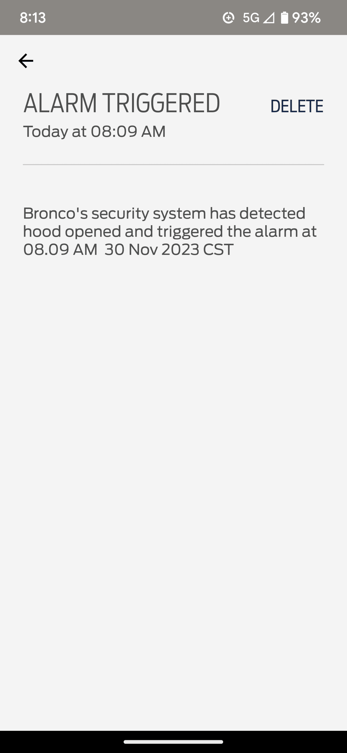

Looks like I just joined the club! The alarm went of twice, in the past two weeks.
