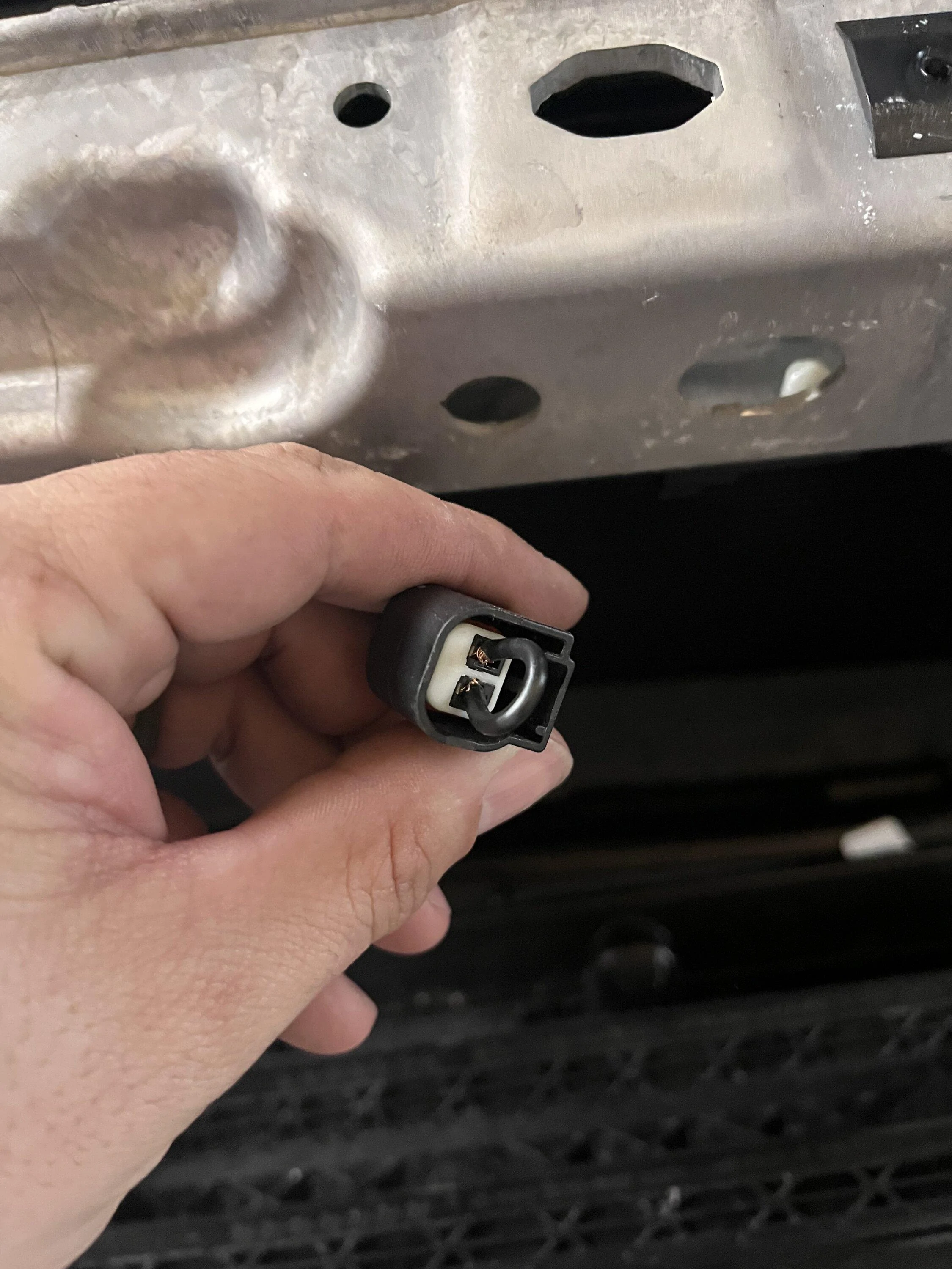

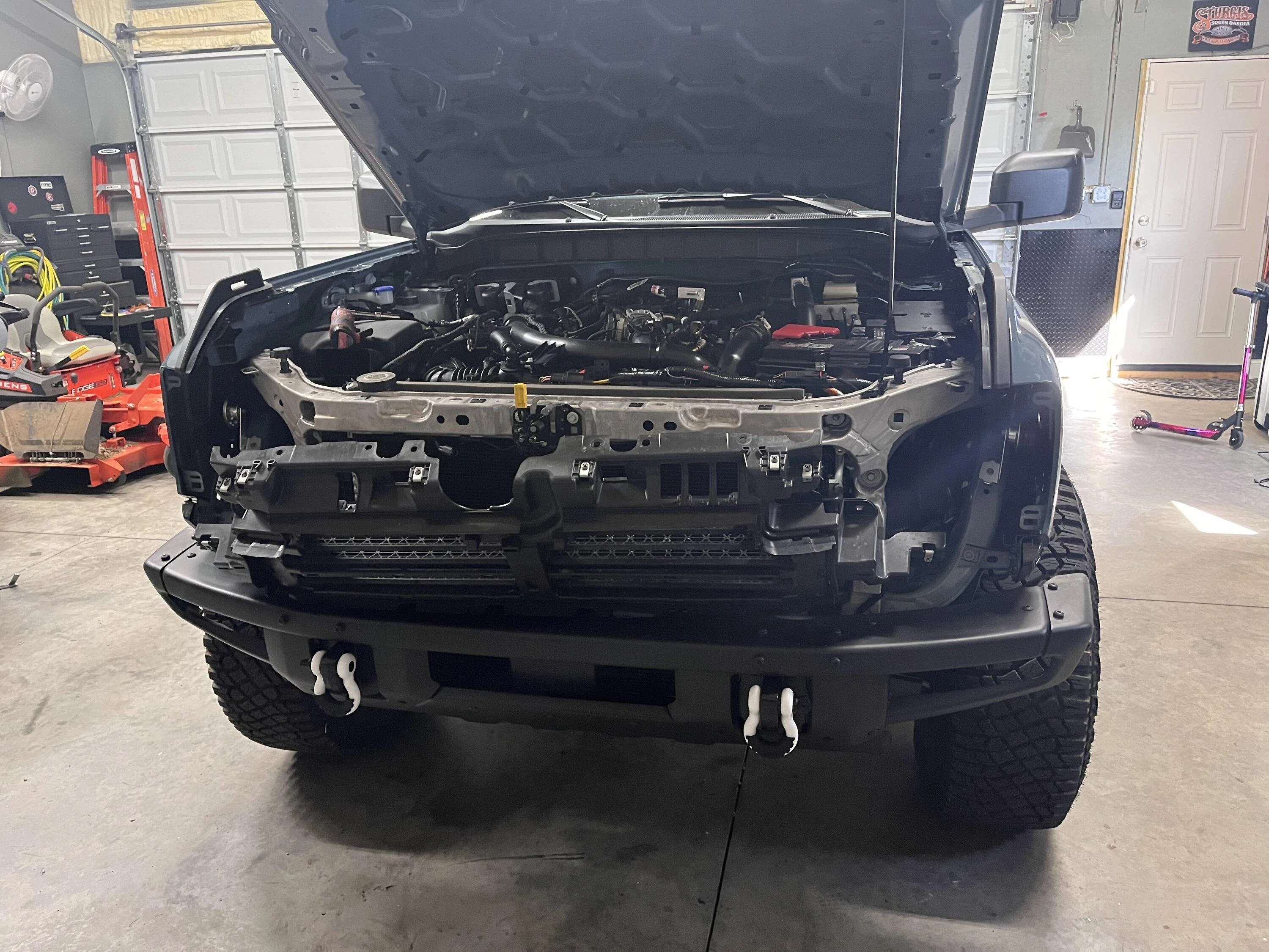

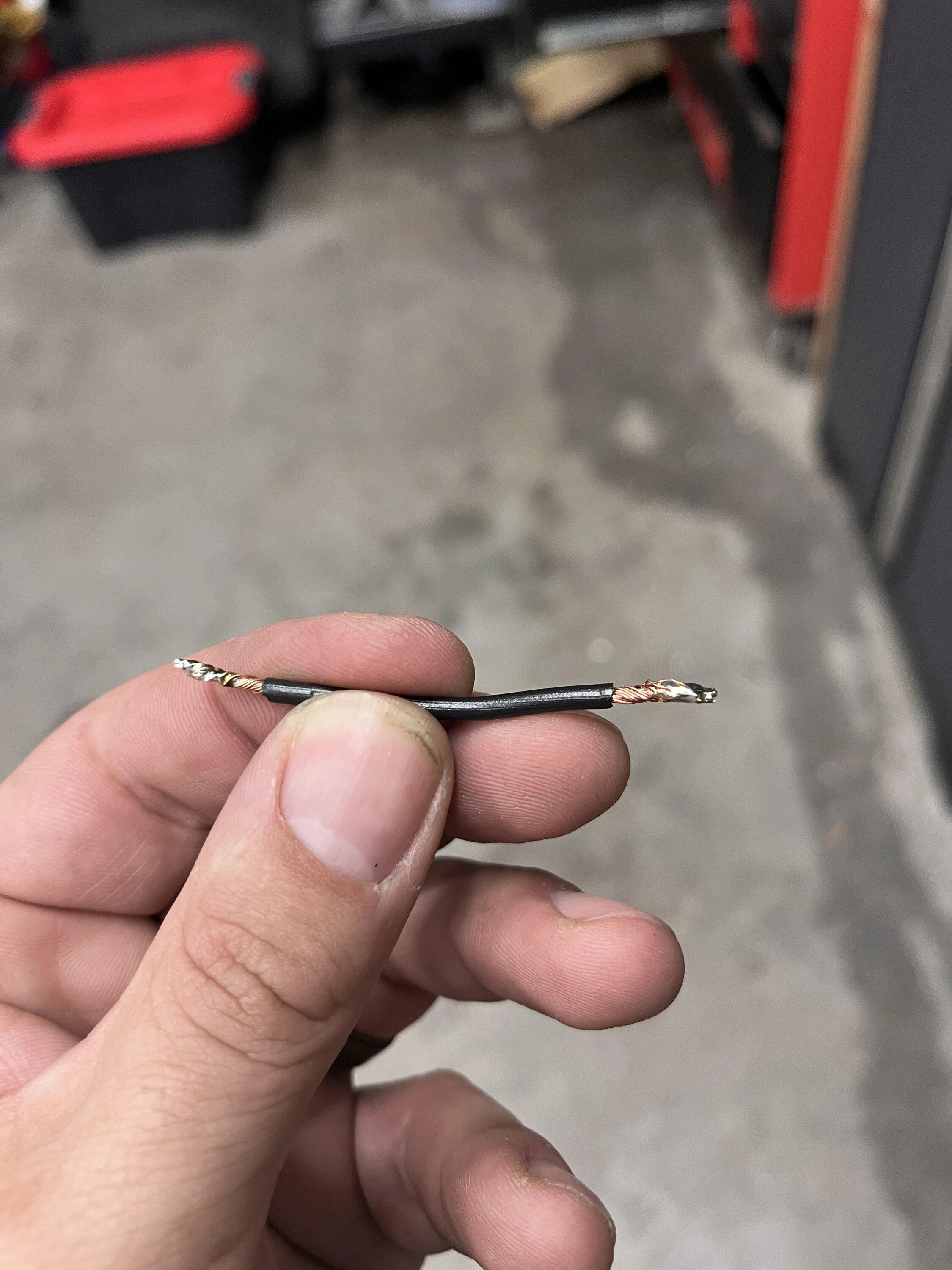

This was in another thread:
You have to take the full front end apart (grille, headlights, flares, lower trim piece and rad shroud) look up YouTube it’s very easy to do and takes at most 10 mins.
After that plug is accessible and I just used a small wire, soldered both ends and put them in the plug. Electrical taped both open plug ends and zip tied them together.
would like to try and find the actual plug ends and jump it with that but for now this will do. Hoping Ford just comes out with a OTA update to fix it.
spiG
Jul 20, 2020
119
162
23 BD/20 Ram 1500
As @0ne showed above, I took mine apart this weekend and jumped the OEM side of the harness. Purchased mine 2/17 (i think) and drove 13 hours home and no issues. Next day took it to the car wash to get all of the MI salt off and within 5 mins of parking in the driveway it went off for hood ajar. In a week it went off a total of 3 times for same issue while sitting in the driveway. Not a daily so parked it in the garage to avoid it going off in the middle of the night. For 2 weeks didn't go off once while inside.
Took it out this past Saturday on a windy day and parked it in the parking lot of Drive Shack and went inside. Again, went off within 5 mins and had to leave it unlocked the rest of the day to avoid it going off. I think its not the hood latches themselves but the sensitivity of the alarm for the hood is way to high.
I'll leave mine jumped until an actual fix is found, either by a forum member or Ford.
