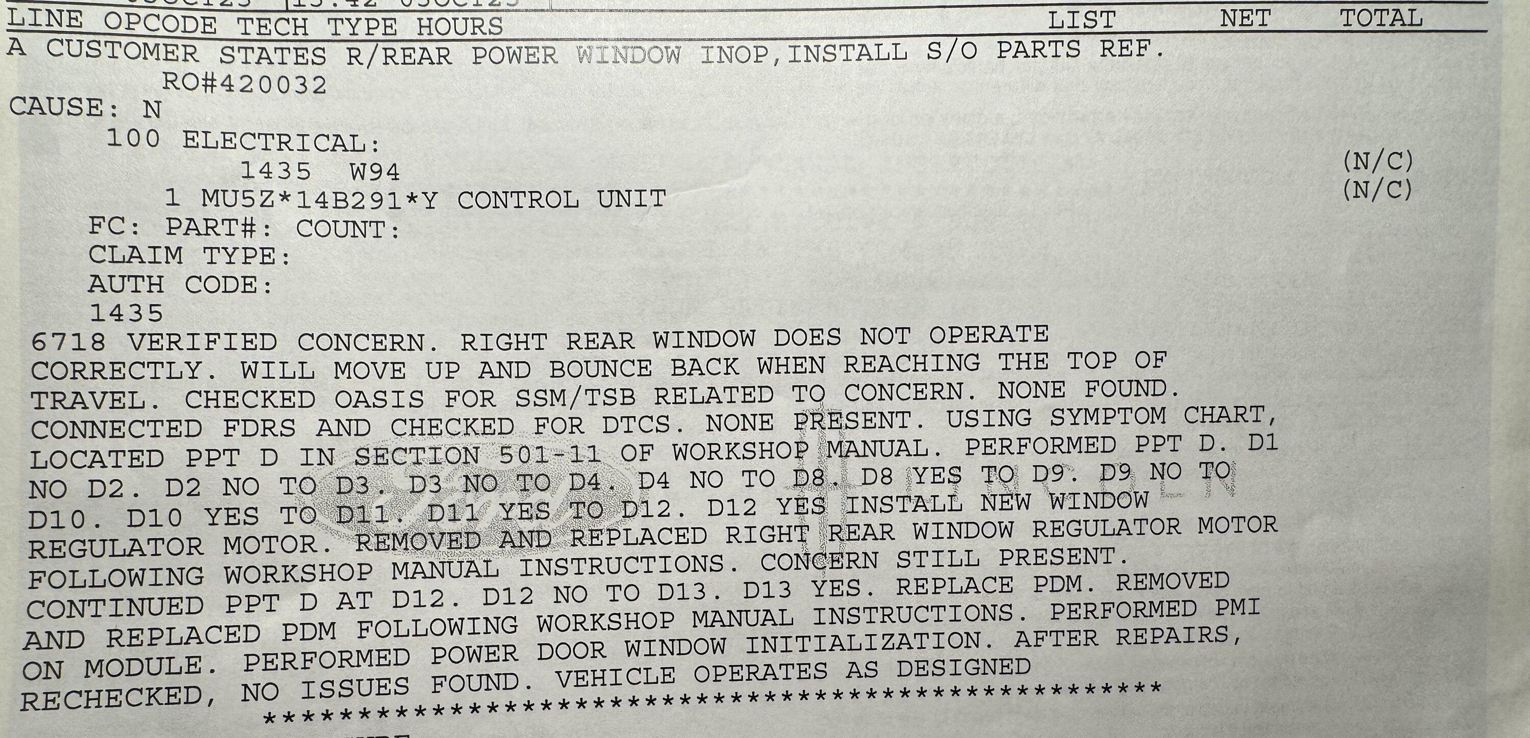

IF you followed these instruction correctly it should reset the issue. Mine was doing it a couple a weeks ago and I did the reset and it absolutely fixed the issue. If it doesn't work, you will need to go to a dealership and have them look at it or look at adjusting the track yourself.
Resetting One-Touch Close
Carry out all steps within 30 seconds of starting the sequence.
- Fully open the window.
- Lift and hold the window control until the window is fully closed. Keep the window control held for a two seconds
- Press and hold the window control until the window is fully open. Keep the window control pressed for two seconds.
